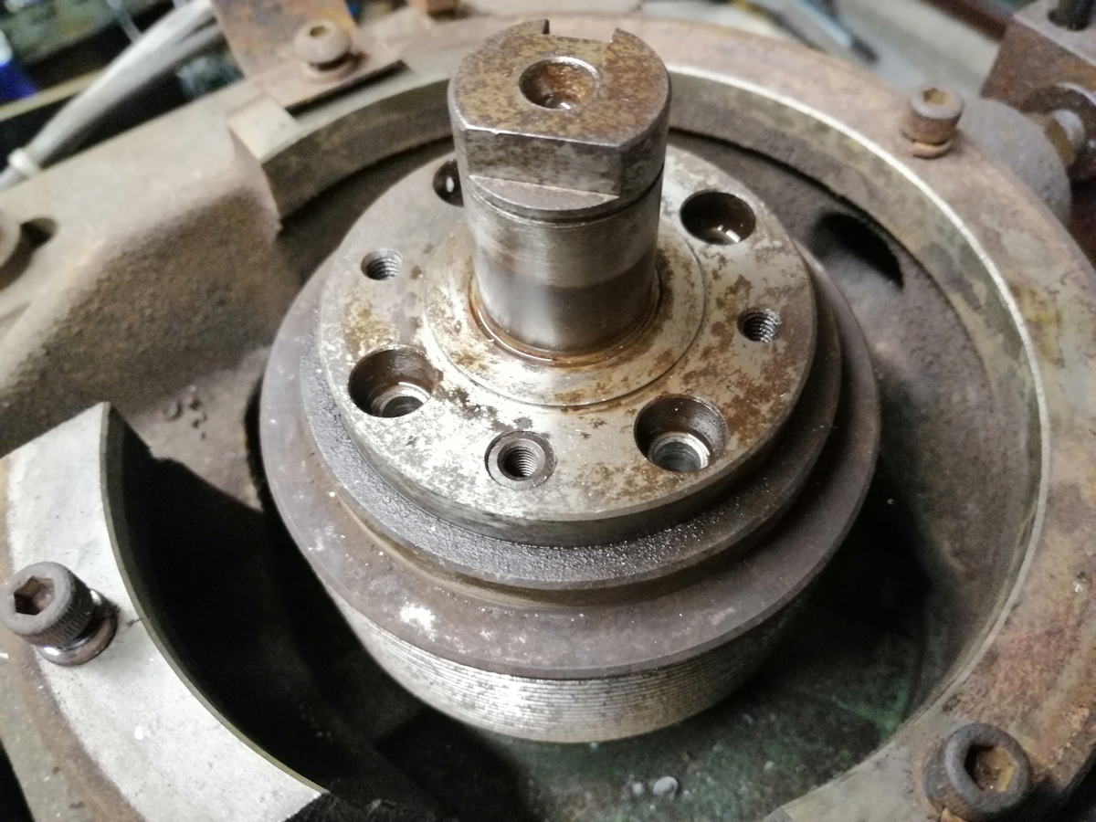

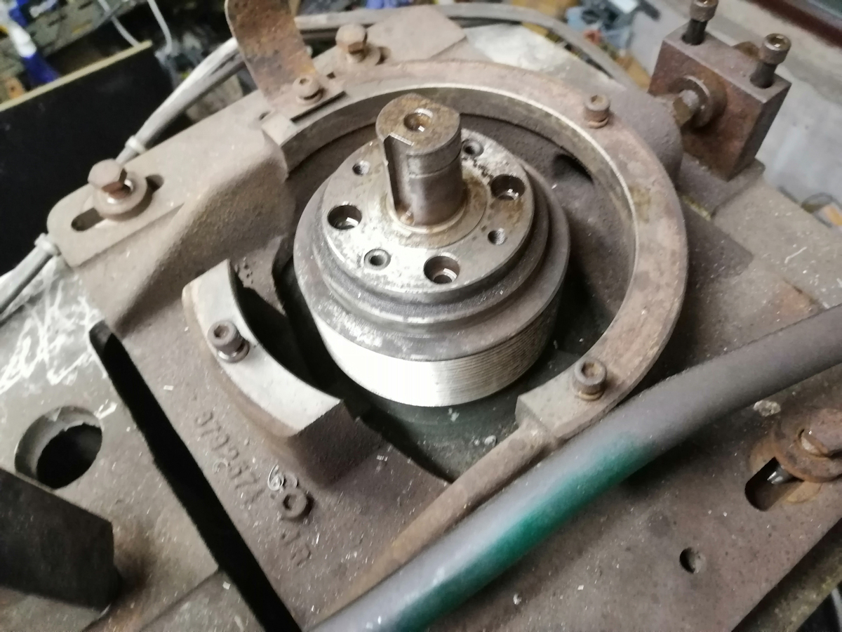

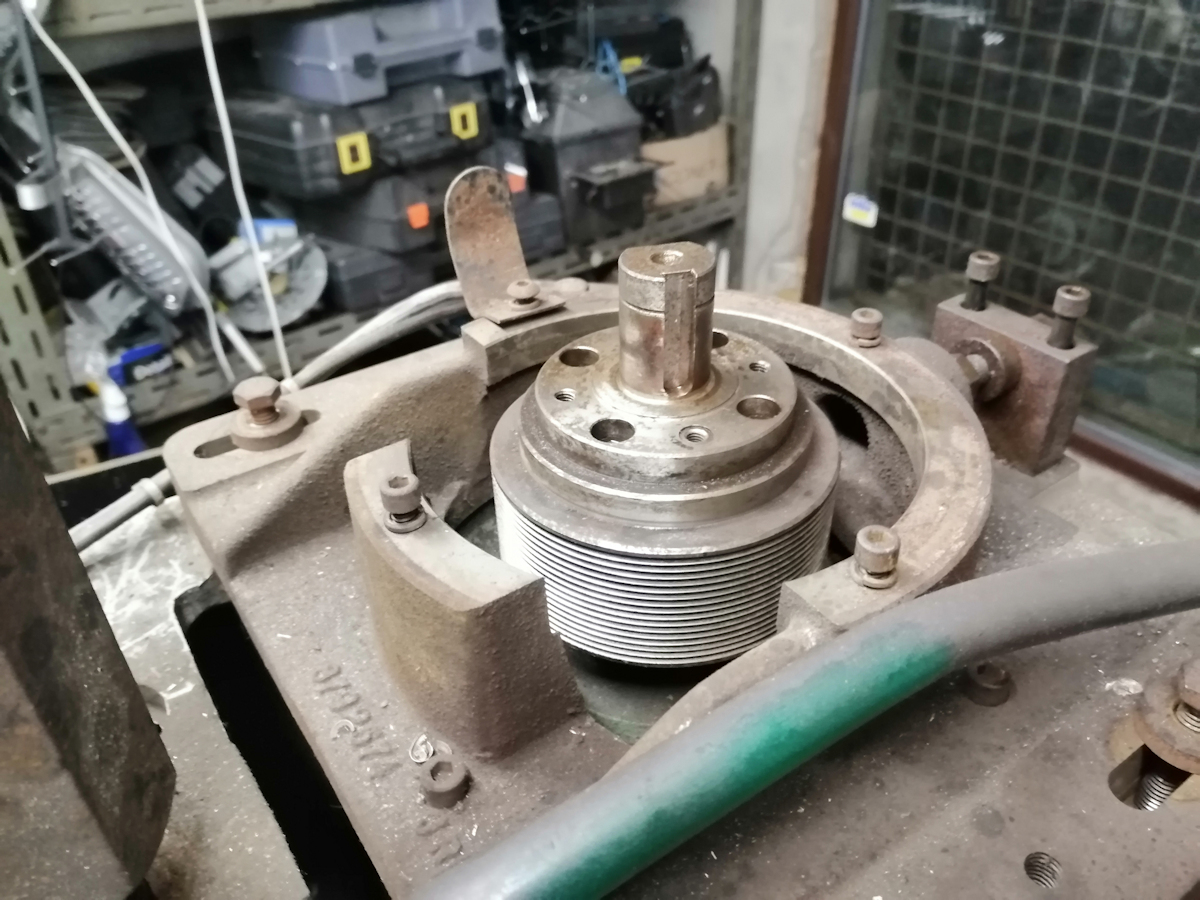

    Hi, does anyone know how to remove the spindle motor pulley on a Bridgeport Interact. I've tried a 3 leg puller without any joy. I'm beginning to think the brake shaft and pulley are one piece? but not sure. Any help would be great. Click image for larger version.
ID:	32028Click image for larger version.
ID:	32029Click image for larger version.
    Sorted out today with two bolts down the threaded holes
