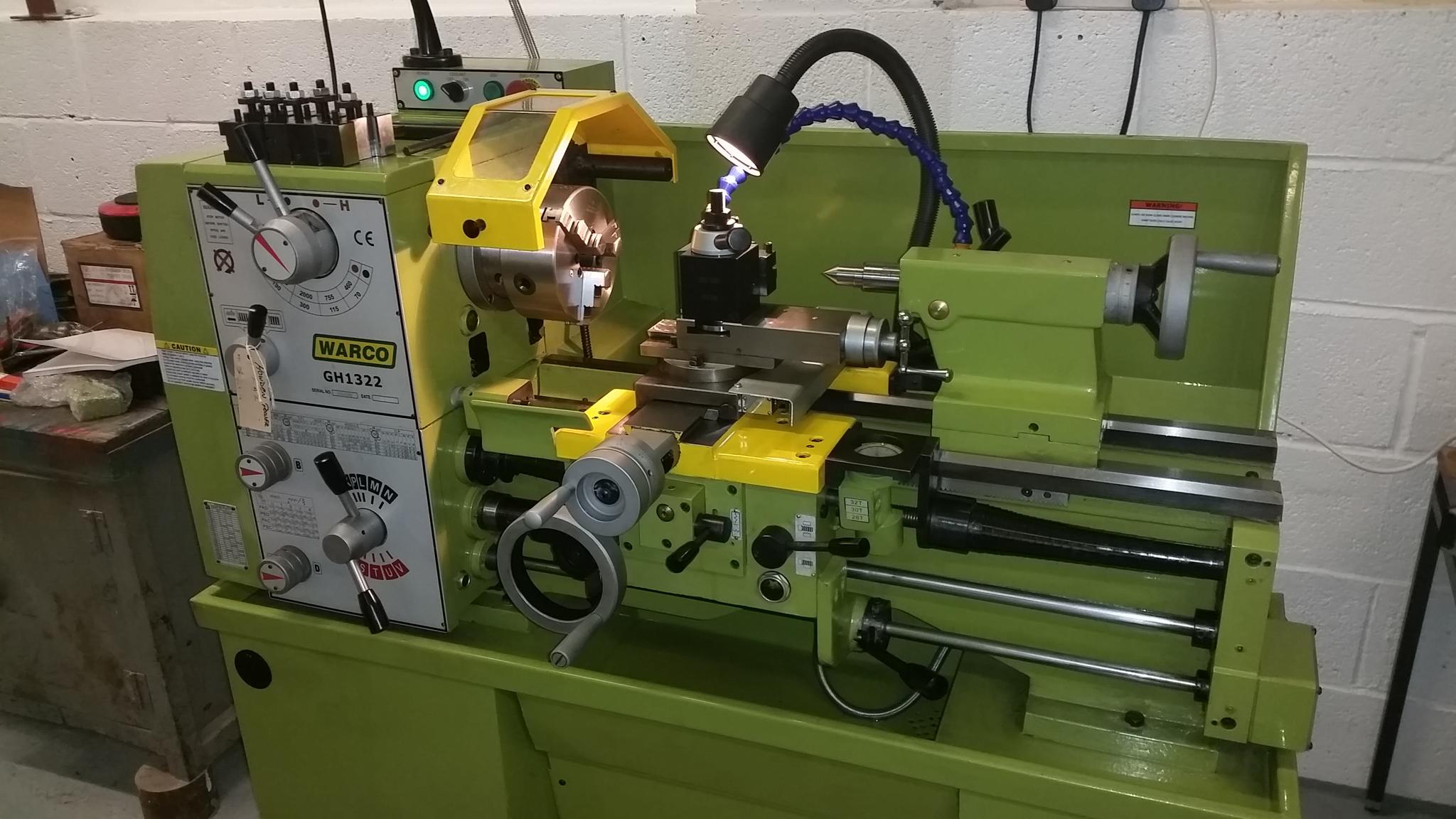

    I've got the WARCO 1322 gear head lathe in Metric and the indicator works OK on thread cutting for me so see no reason why it wouldn't on the smaller lathe? their customer service is good, had to use it a couple of times although it can be quite hard getting hold of them sometimes but then they're a small company.
    Neil...
    Build log...here
