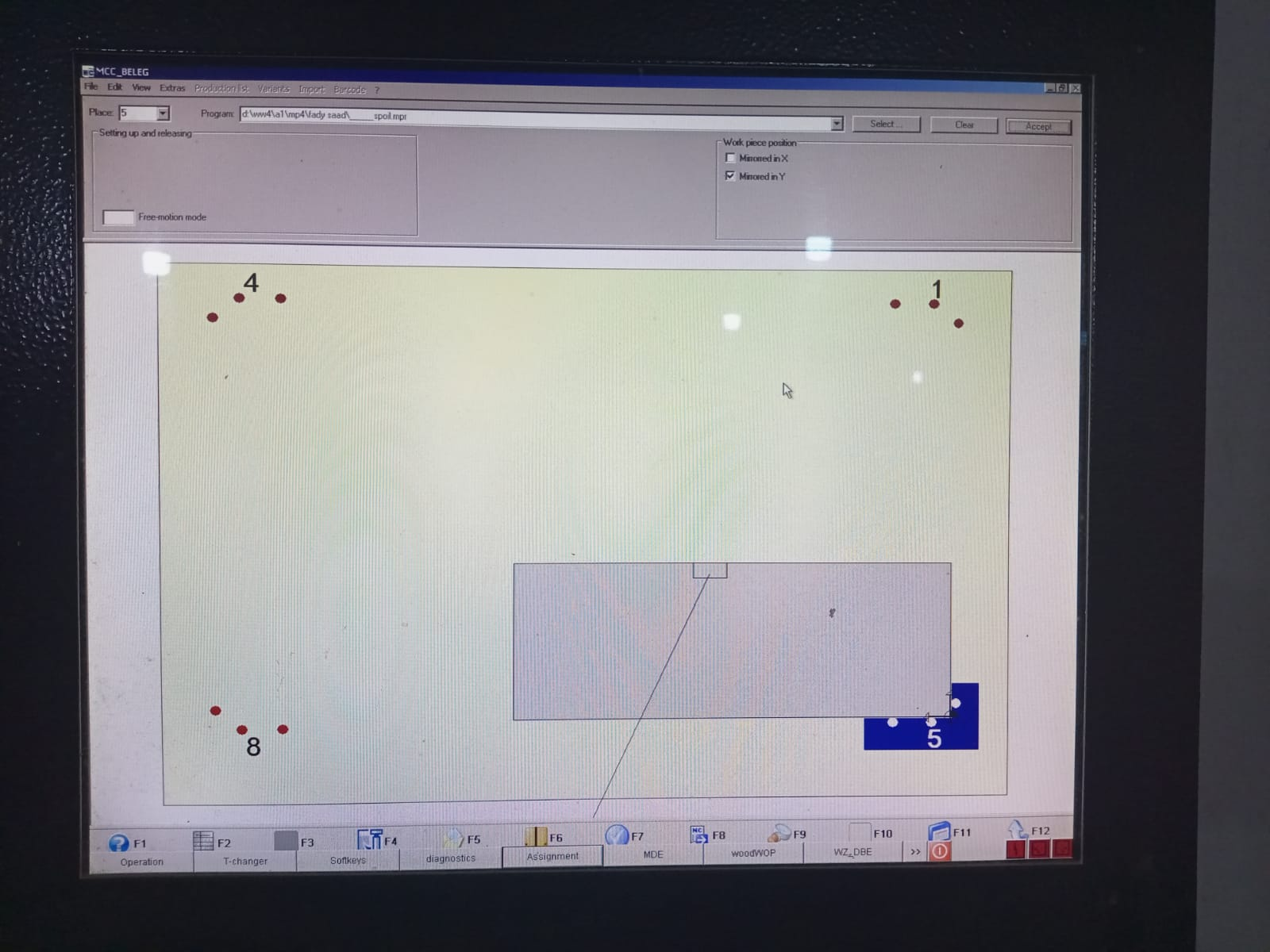

    i have been working on my cnc for over 4 year
    today for no reason i am facing a problem that is when i load any file to the assignment tab and i try loading it by pressing the accept bottom on the top right window and nothing happens

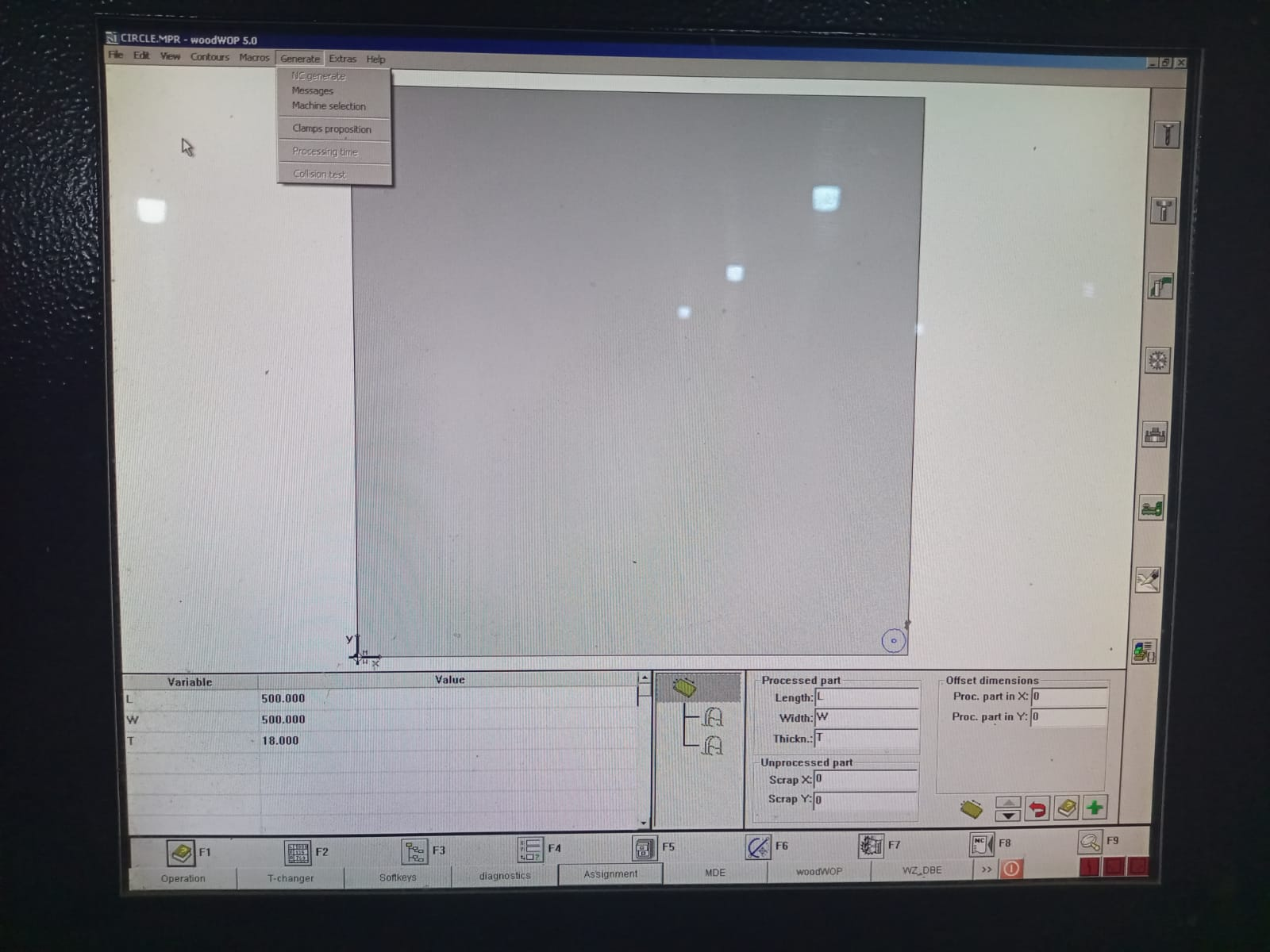

    and i noticed that in the woodwop 5 tab while pressing generate i cant even press on the nc generate button
    any one has any experience regarding this problem ? thank you for your time

    Lack of the NC Generate option suggests that it may not be recognising that the software has an active licence.
