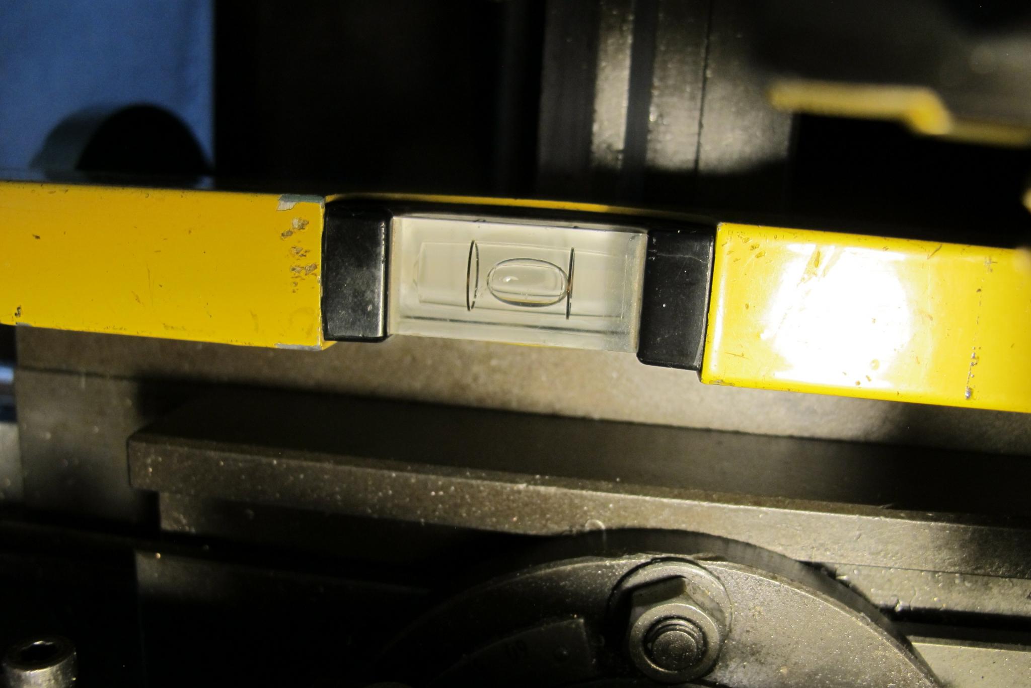

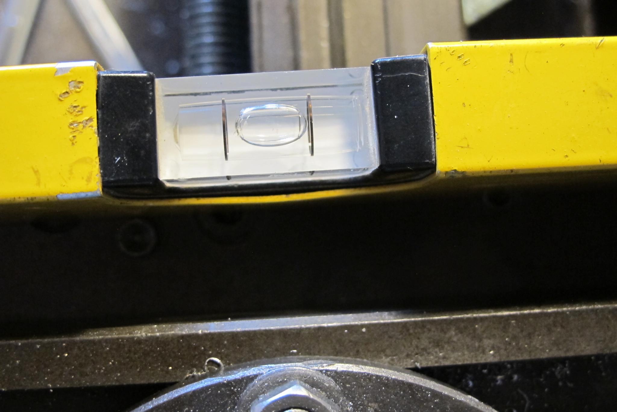

    I have a lightly used Stabila level, ok its not calibrated but I am a trained carpenter, so am well used to reading such things.
    For sure I see twist in the beds, one end to the other, if I remove the twist would that affect the headClick image for larger version.
Name:	Maximat level test, head stock end.jpg
ID:	32065Click image for larger version.
Name:	Maximat level test, tail stock end.jpg
ID:	32066 stock I wonder?
    Yes, a check with my level shows that the bed has a twist in it, I can shim the mounting cabinet easy enough, will it correct the headstock I wonder?
    Ok, job done and it took a couple of hours, adding Formica shims until the level read the same at either end of the beds.Click image for larger version.
