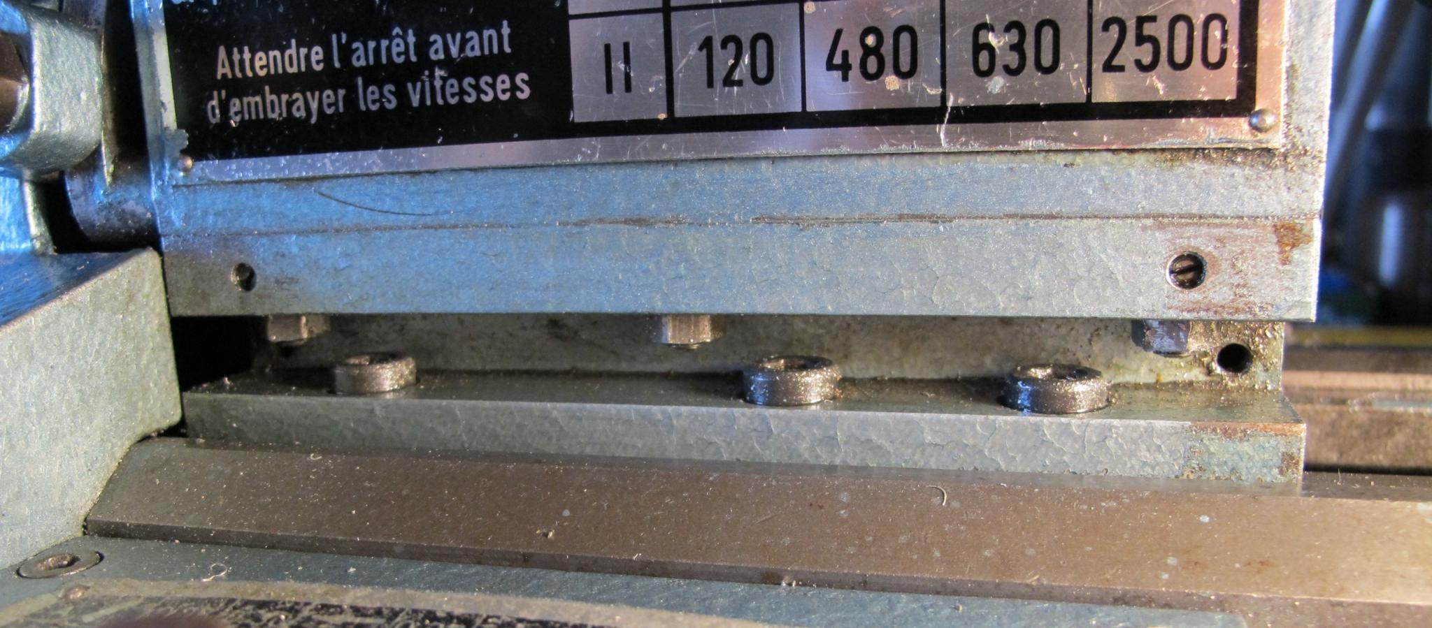

    These pictures show how the gear head is fastened and located to the rails, there are no adjustments.Click image for larger version.
Name:	Maximat V10P gear head mount fasteners.jpg
ID:	32068Click image for larger version.
Name:	Maximat V10P gear head location groove.jpg

    the first of the 2 pics shows the the 2 scerews i mentioned earlier, looks like these could inpinge on the mounting screw body allowing it to have some slight allignment

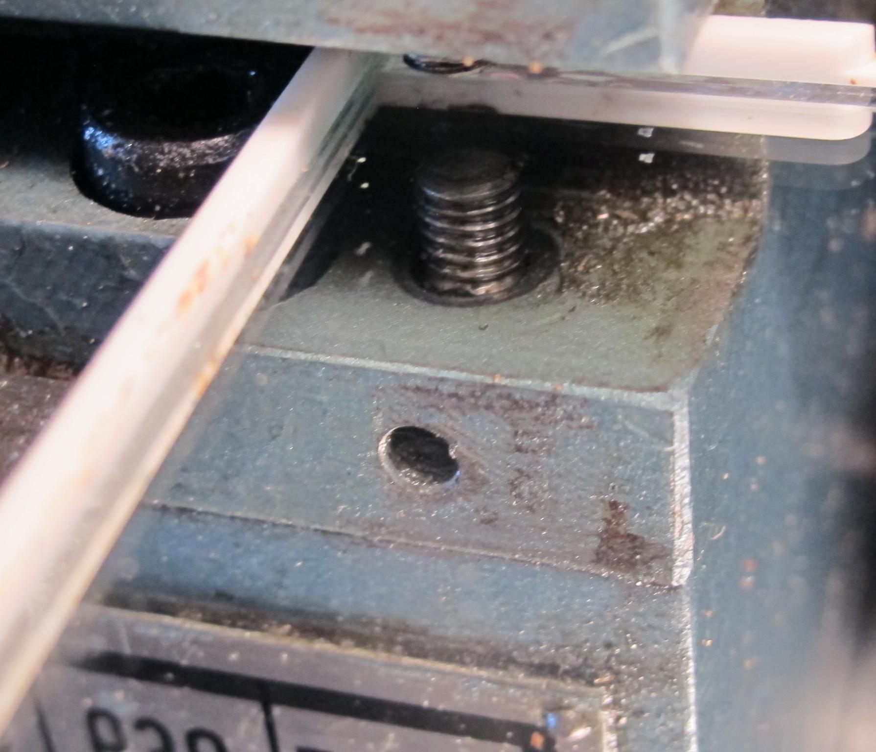

    They are lock screws to the threaded rod they are going into?
    But why would the threaded stud have a lock screw ??
    Are they there to push the gear head into line, as in the threads are say 8mm diameter in a 9.5mm diameter hole, that would give plenty of adjustment?
    Its the same on the other side.
    With the nuts removed and a mirror inserted underneath I may see that the stud hole is large enough to allow adjustment?
    I will be checking this idea out in the morning!

    if it is as i thought, screws on both sides would allow you to scew the headstock. i seem to recall on some of the youtube vids that i have seen that the headstock is located on the V of the bed, there's a few video's that might be worth checking, will have a look in my manual as there is some V10 stuff there

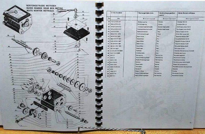

    The base plate is indeed located by the V section but the way I see it the gear head could have adjustment by screws numbered 48, I cannot find a reference to those screws, will it say lock screw or adjustment screw, this is what I need to find now?

    An idea that the gear head box can be adjusted via the grub screw numbered 48 in the parts list holds no water, this is what I see in a mirror when the nut has been removed, there is no extra space seen for adjustment that I can see? Click image for larger version.
Name:	Maximat VP10  gear head stud in mirror.jpg

    My search for a parts name page has found the parts drawing and a list of names, part number 48 is a Socket Screw, so its not for adjusting the gearhead?Click image for larger version.
Name:	Maximat VP10 gearhead parts and list of names.jpg

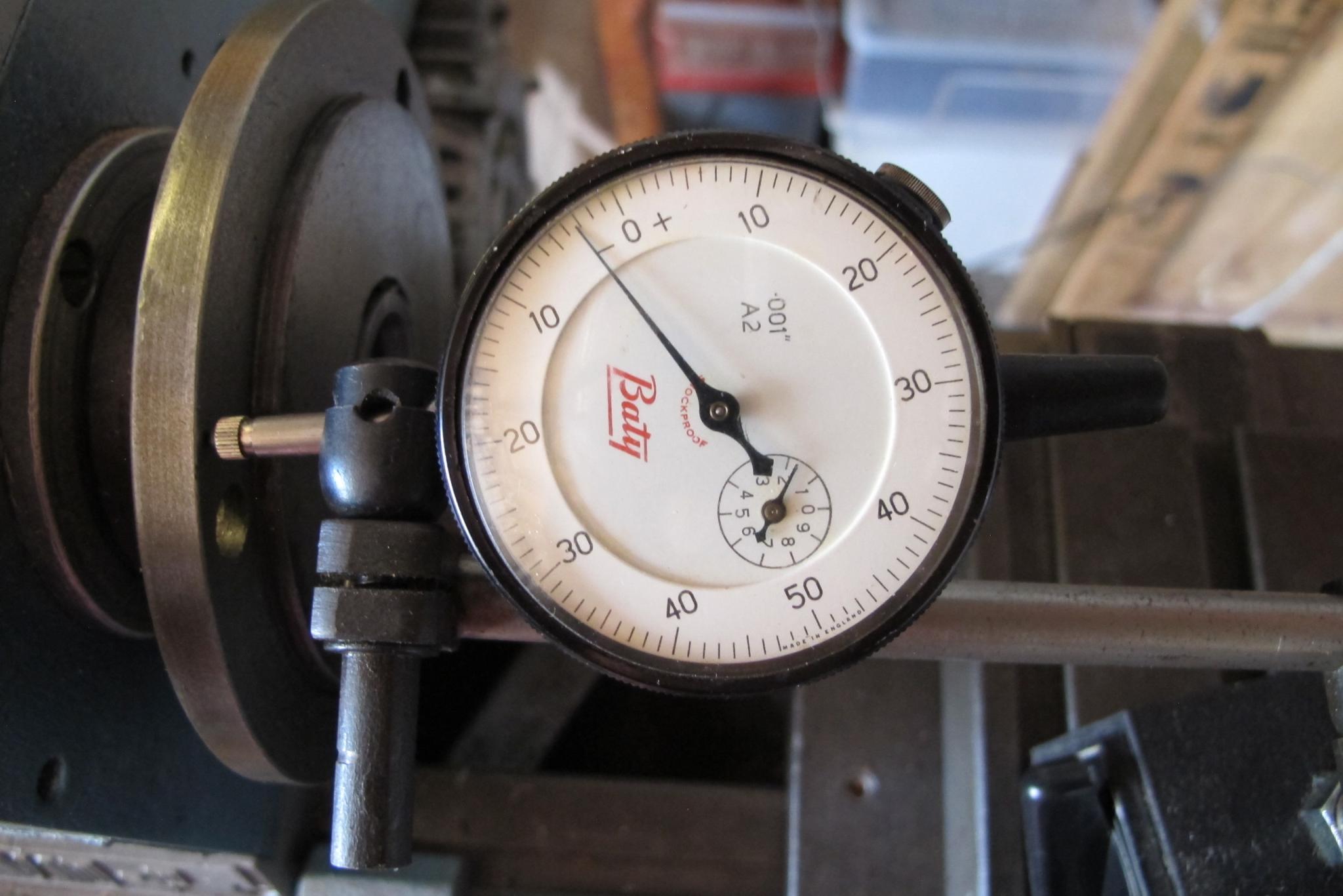

    I mentioned the chuck back plate was refaced, well as a way of running through the possible errors I have rechecked the back plate and found that it had an error of 0.0003" which is what the error in my machining is, could that be the reason for error?Click image for larger version.
Name:	Maximat back plate run out 0.003.jpg
