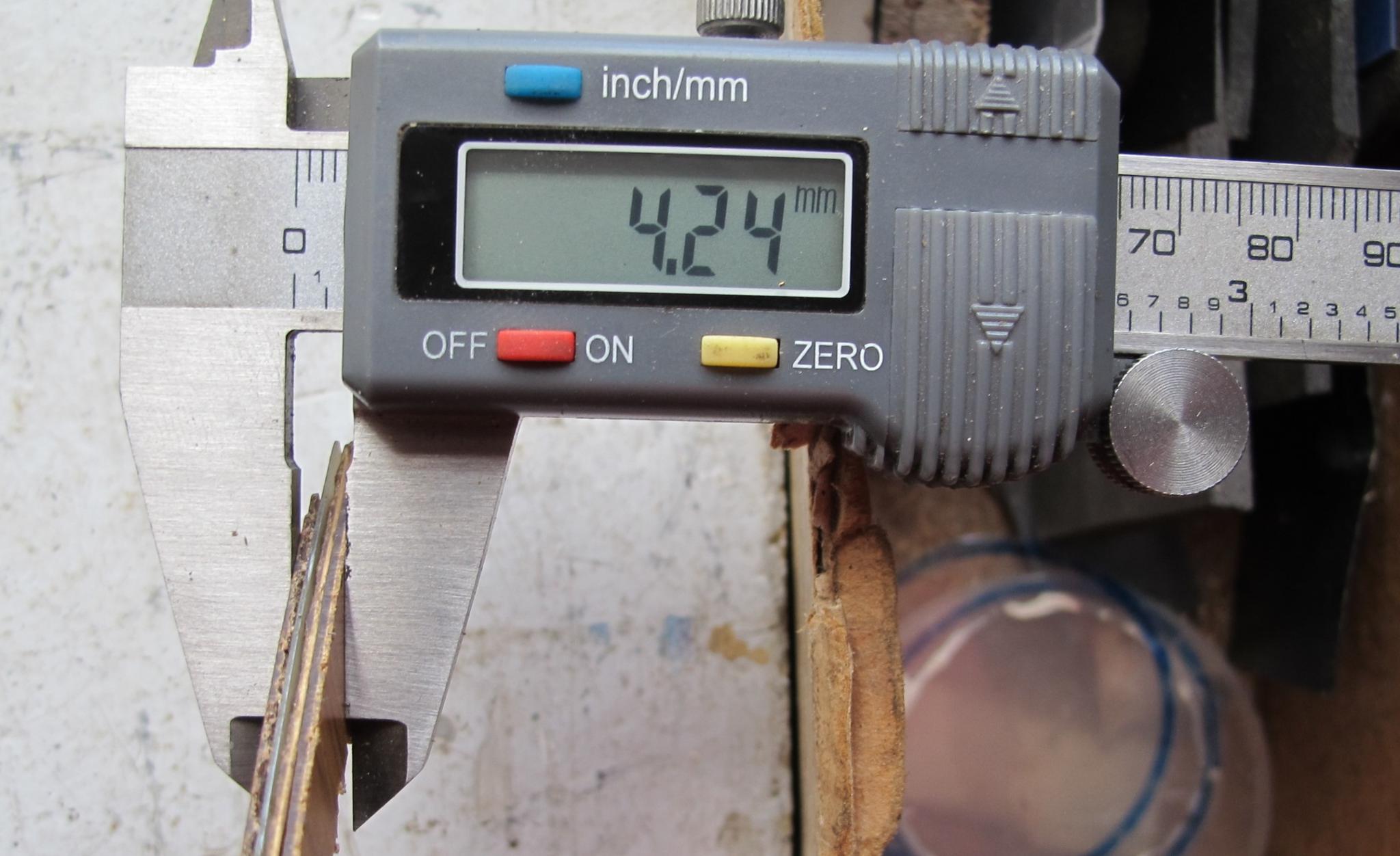

    Yes, a check with my level shows that the bed has a twist in it, I can shim the mounting cabinet easy enough, will it correct the headstock I wonder?
    Ok, job done and it took a couple of hours, adding Formica shims until the level read the same at either end of the beds.Click image for larger version.
Name:	Maximat tailstock shims.jpg
    The test on the alloy tube run again and the run out is still showing 0.003" , so no change there .

    However my situation is that the headstock is not true to the beds, its pointing out towards the tailstock.
    Anyway, bit by bit and with advice from forum users I am making improvments, today I removed the twist from the tailstock end, it was low at the back by over 4mm!
