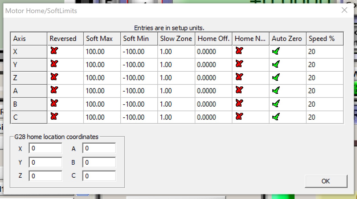

    That leaves me with just one issue; the limit/home switches don't work unless virtual limits are set. If I lose my initial datums for some reason (light smashing into the part) I have to start again because I have no references.
    Activation lights in Mach3 show the X/Y switches working (no Z though) but when I reference the table just runs over the switches until it hits a hard stop and spins the leadscrews.
    It was mentioned in a previous post that Novamill switches are inductive, so the question is; do I try to replace them with mechanical switches, or can they be made to work as they are?
    My workaround idea is to add a pin or hole on the bed somewhere are a permanent reference. That way I can get back to datum if things go wrong.
    Any advice would be welcome. Thank you.
  13. #29
    Novamill switches, on my mill anyway, are standard microswitches. Maybe there's a wire dropped off the z switch? If you are seeing the lights operate on the diag screen then the X and Y switches are working.
    There's a configuration setting for the homing speed as a percentage of rapid, what do you have that set to? When the home switch is triggered the mill goes into a controlled deceleration to stop then reverse until the home switch deactivates so there is a small overtravel. If going too fast this may allow the axis to hit the end stop. IIRC I have the homing percentage set to 5% which is probably too slow but I never hit the end stops.
    On another point, I almost never home the machine anyway unless I'm doing a job that is very close to the limits of travel. I always reference the axes to the workpiece using an electronic edge finder and tool height setter. If I do have a crash I only need to re-reference to the work again.
    Update: the homing speed setting is in the config\homing/limits tab

    Good advice as expected. Many thanks
    I'll check the outputs and adjust the speed down to a lower value. It can't hurt to give it a try.
    Reassuring to be reminded that every setup has it's own reference points, and if they are noted they can be attained after any "issues"
