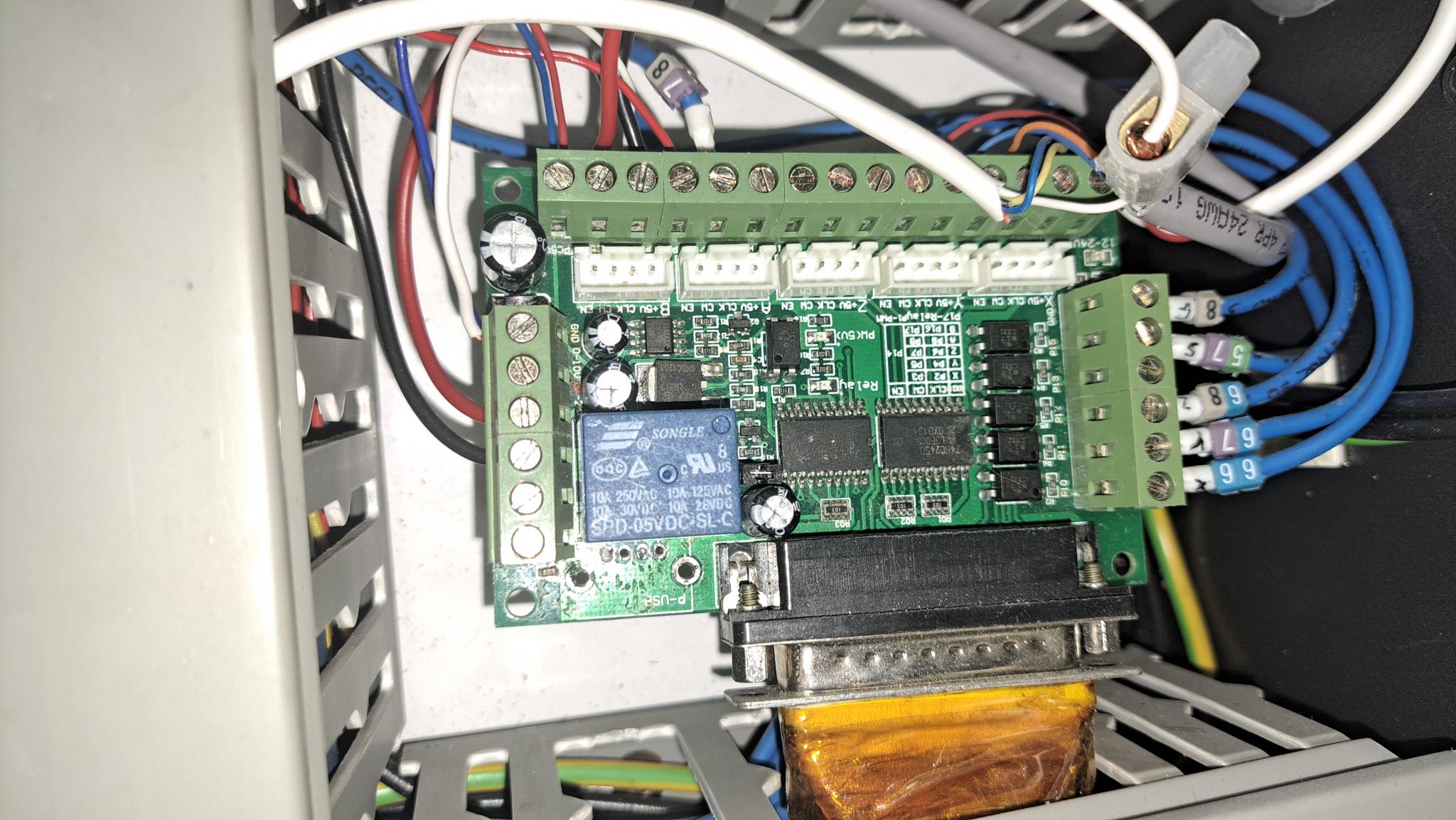

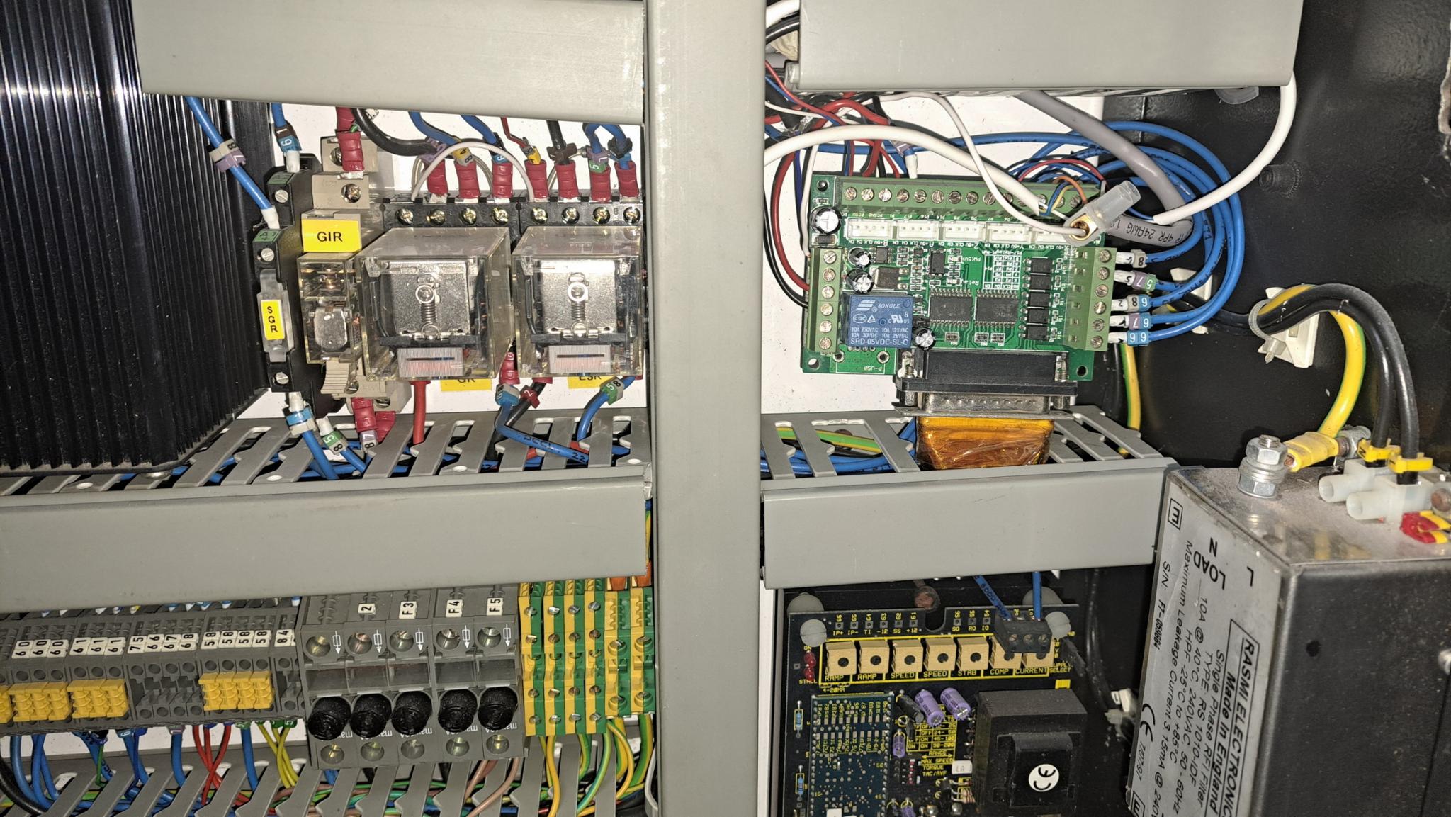

    The configuration file will be specific to whatever controller/breakout board is fitted.
    Can you upload some photos of the inside of the control cabinet?
    Apologies. I've been posting all over the place and thought I'd already put the images up

    That's a pretty generic Chinese BOB, however I'm not entirely sure of the pinouts.
    I do however know the original Denford wire numbers, but they don't seem to match the hand written marks on the terminals -
    57 - Home 2 (Z)
    58 (assuming the 5 has fallen off) - EStop monitor signal
    66
    67
    68 - Estop relay coil
    78 - SGR (Spindle Go Relay)
    66 & 67 would normally be the wiring numbers for part of the E-Stop loop (depending on the spec, the EStop loop can go through EStop button(s), limit switches, Guard interlock, and spindle motor overheat, with the wire number incrementing between each switch/sensor capable of breaking the loop).

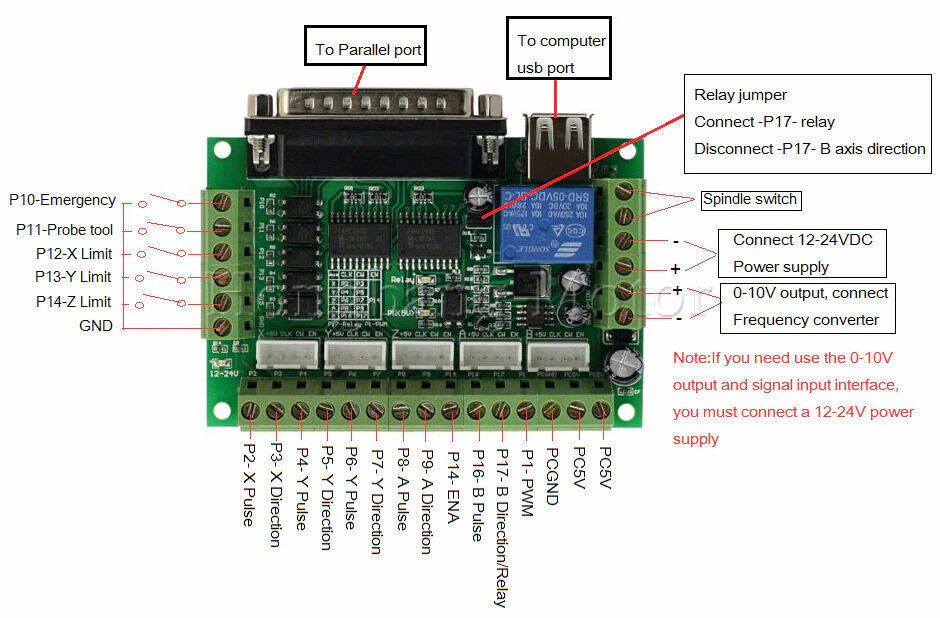

    This is the BOB, which will give you the pin mappings

    I'm going to open the box up and see if I can trace some of those wires/numbers
    From the BOB pinouts and looking at the wiring I have set the following:
    66 - X Home
    67 - Y Home
    68 - Z Home ( however this one doesn't show in the diagnostics panel as being made at either end of the Z axis travel)
    57 - E Stop
    58 - Ground

    I can probably guess why homing and limits don't work then.
    Denford for a while used inductive NAMUR sensors for homing, which are a sensor type designed for volatile atmospheres (basically a two wire sensor that changes resistance/current flow, so any wiring faults don't result in sparks). These are not easy to interface, but the original controllers used them, so I'm guessing whoever done the retrofit probably never changed them.
    Instead they've probably modified the limit switch wiring to use them as home switches, as the limit switches would have originally broken the E-Stop circuit, but then they've never really implemented them. Or possibly disabled them because the Z has gone faulty.
    Before you dismantle anything major, if the machine still has the big Harting multi-connector for connecting the machine to the control box, unplug that and very carefully look to make sure all the pins and sockets are in position and the same height. I've seen them become unseated, so they don't make contact.
