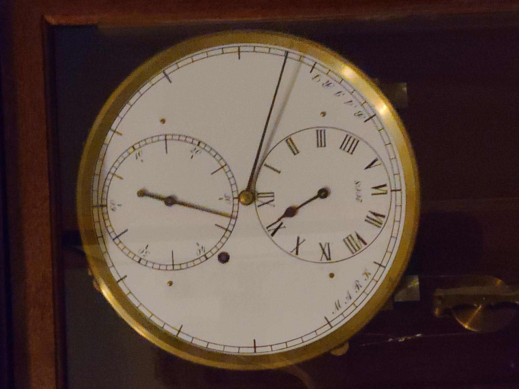

    A few years ago I looked into a suitable machine for clock dial engraving but didn't really get anywhere as I didn't really get any positive vibes about the machines available on the market.
    I've posted a picture below of a hand painted dial I have made previously and I'd like to reproduce this by engraving on CZ120 brass.

    I like the dial you made!
    Thanks for the comment on the dial. I just noticed that the image was on its side - no idea how that happened!
