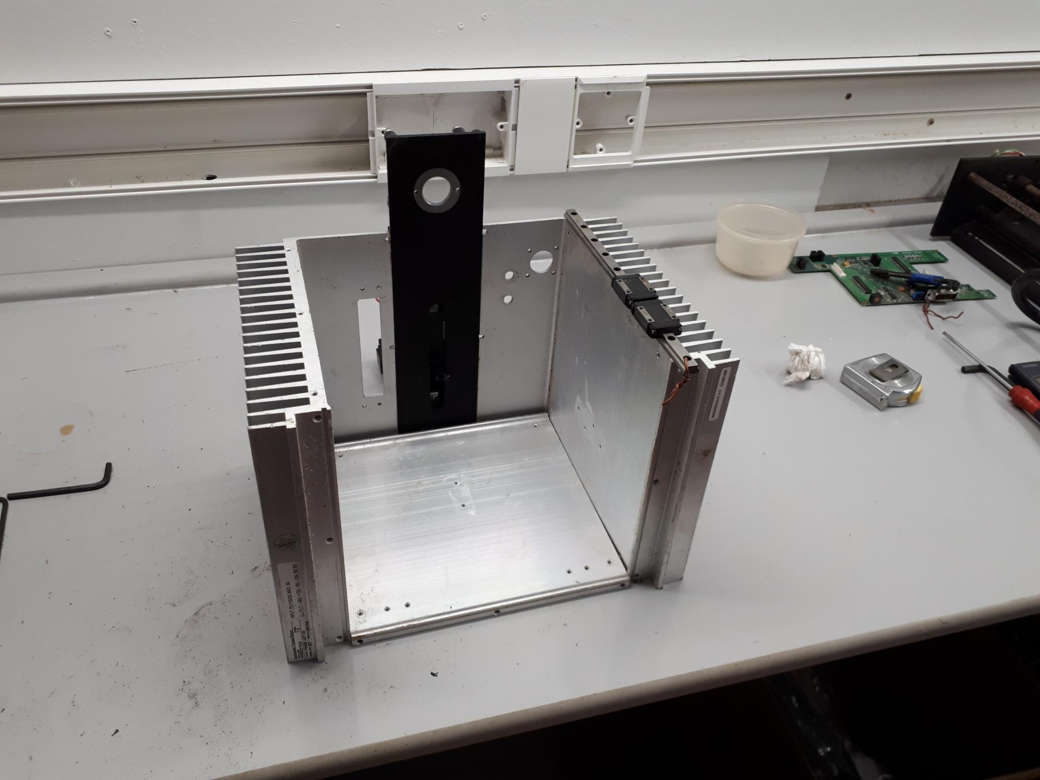

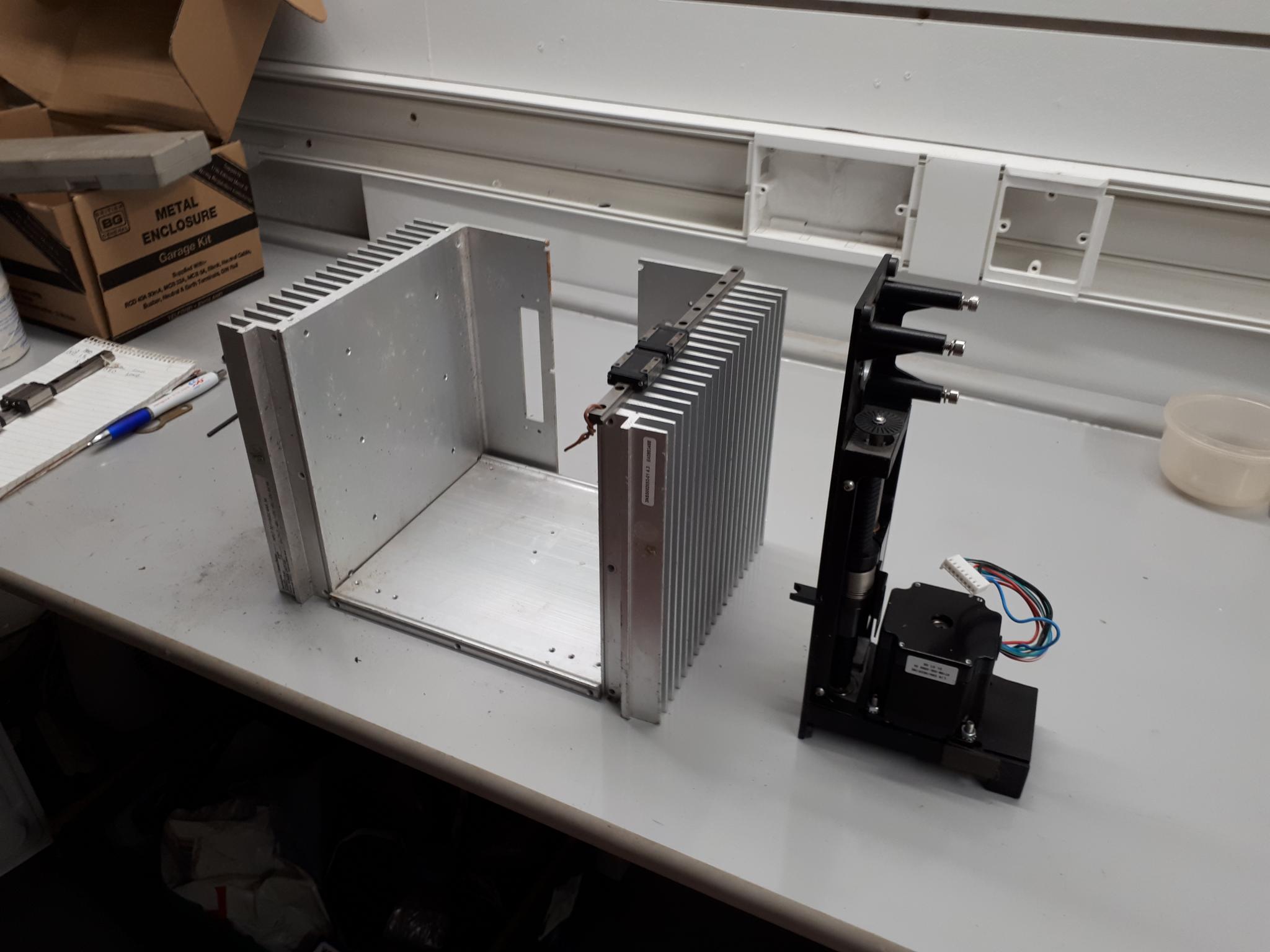

    I had some 30x30 extrusion kicking around but the slots are too big for the rails. I really like the Voron design but for this one it needs to be function over form so I'm going to have a bit of a redesign based on what I have. I probably wont show it on the Voron groups in case they get upset :o)
    I have THK 9 and THK 12 rails and some old Ali heat sinks. rigidity wise it will be rock solid and completely over engineered. The Z axis is from a dosing unit and has a Teflon lead screw and anti backlash nut which is very smooth. The motor, gears, belts and screw are all in in one nice unit.

Name:	Base photo1.jpg
ID:	28696   Click image for larger version.
Name:	Base photo2.jpg
