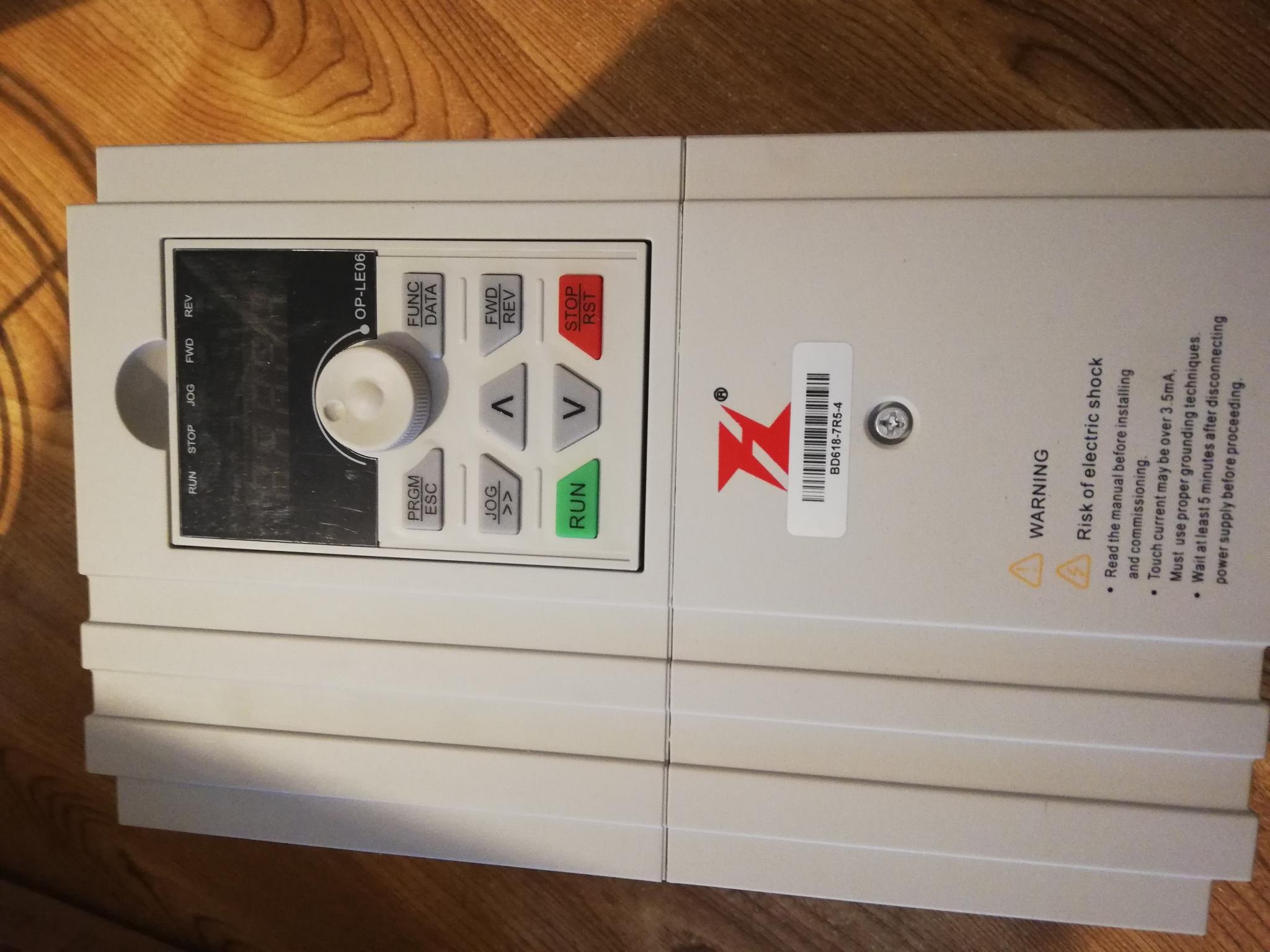

    The supplier has just got back to me and suggested increasing the Break Resistor to a 1500w 75ohm type, but from my understanding a 75ohm would take even longerr to stop than my 1000w 60ohm one..?

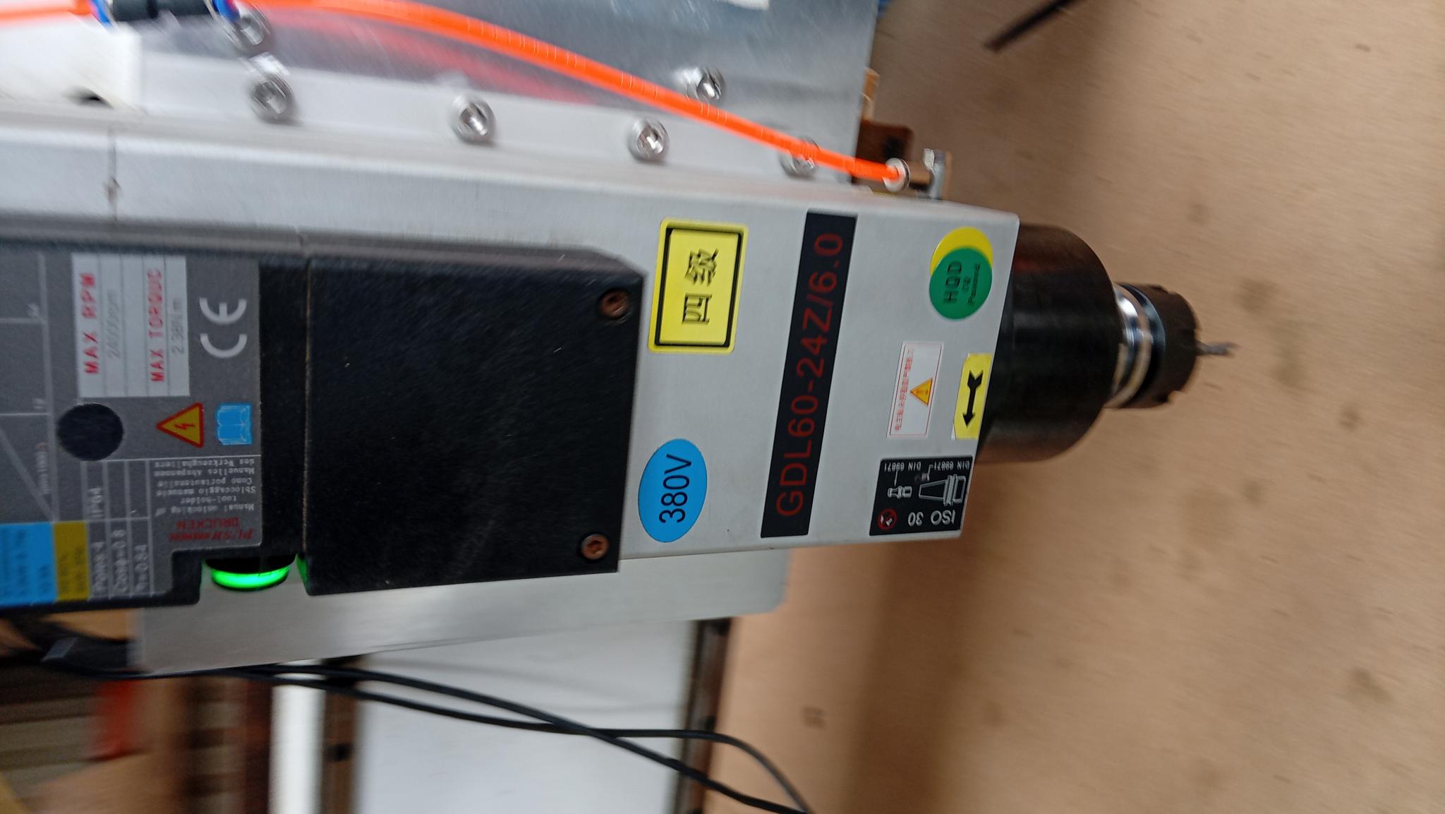

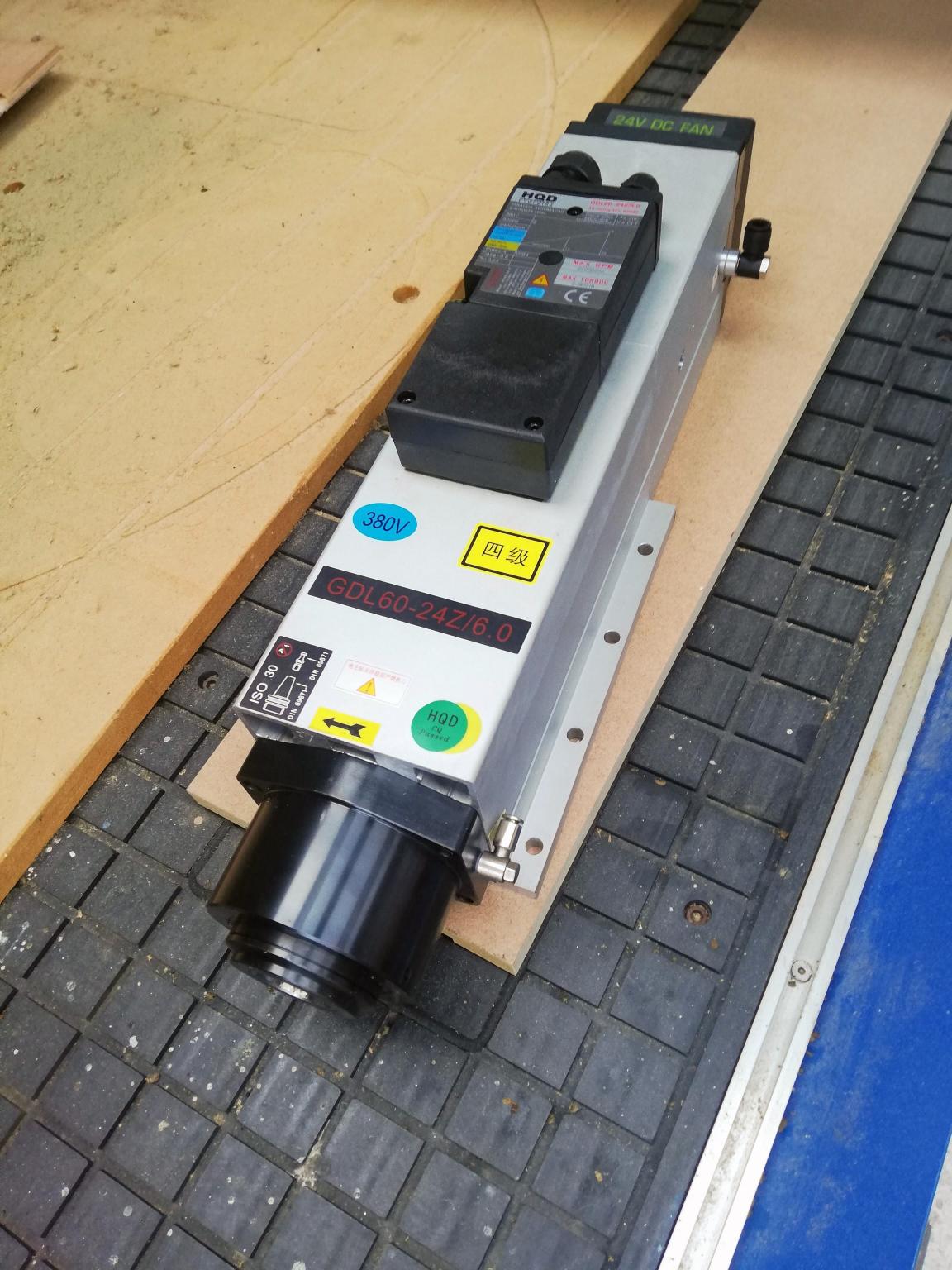

    I am following this post with interest as i am also in the middle of an upgrade to an atc spindle which i have mounted and have running from the potentiometer , i plan on using the manual tool change butoon until i get my head around the auto tool change setup ,i also have a braking mechanism which was part of the original setup with the old spindle .i love having a go at these things myself but i am finding it difficult to get information online ,so hopefully i can get some good advice on the forum , i am running uccnc with the uc300eth-5lpt and ucbb.

    the braking mechanism was setup on my old vfd , i will hook it up and go through the settings and see what i can find on the braking side , i am stuck with the manual tool change button , i want to connect it with two solenoids in line ,one connected to the button the other connected so that it is disabled when the spindle is running , i just dont know how to go about it ,i would like it to be safe ,i dont want a tool ejected during a cut , i upgraded my machine 2 years ago from a chinese controller to uccnc ,it took me a while but i got there in the end , i am not into the electrical side of things but i really enjoyed the whole process. then i purchased an atc spindle and vfd and that is where im at now.

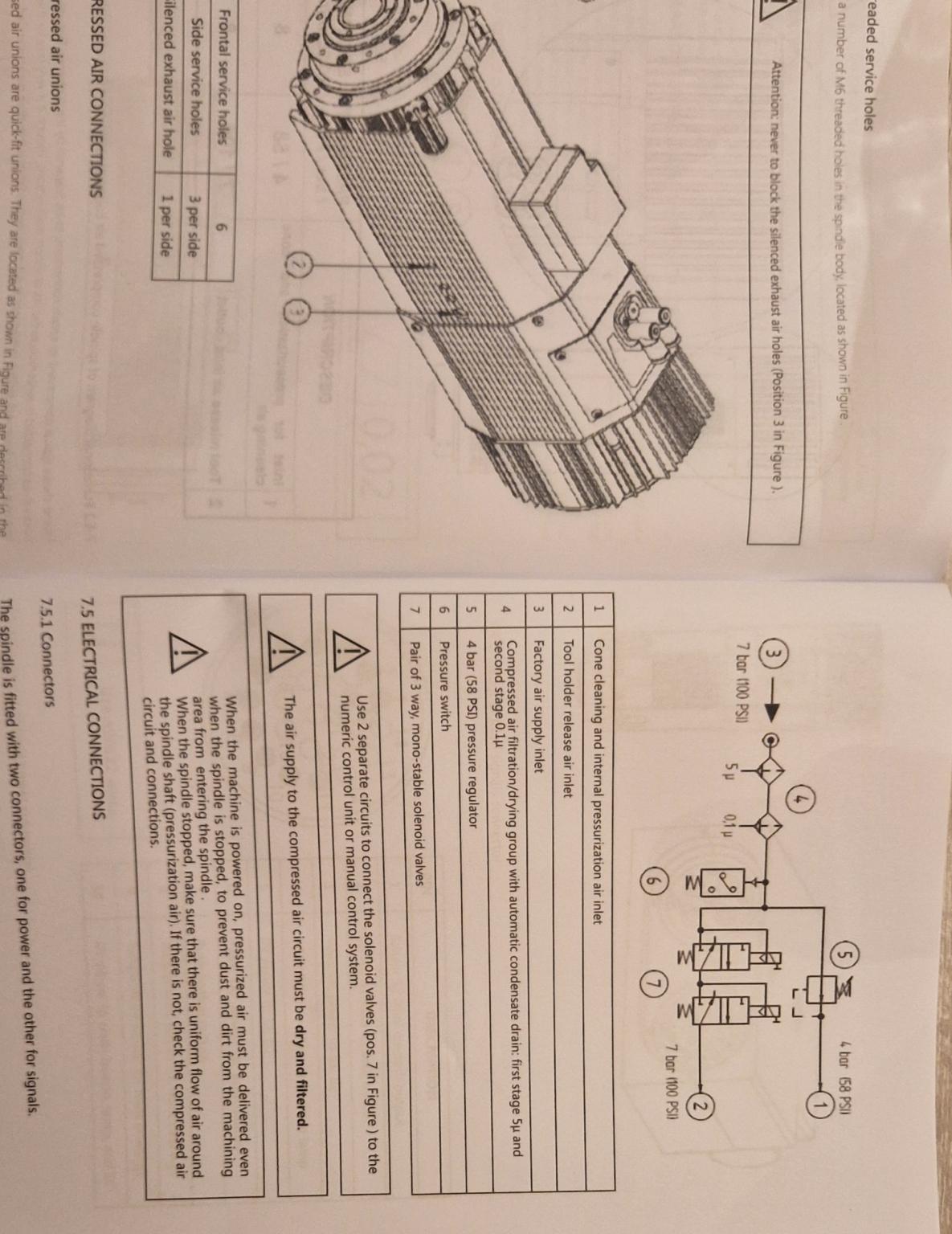

    Looks like a nice Spindle that mate, yeah any help would be appreciated thanks!! I know what you mean, I have attached a diagram that has come with my Spindle, it sounds like exactly what your describing, weather you've already got this or it helps I don't know...obviously it's a different Spindle but the same principals, I could send the whole document if you think it helps..??

    Also just remembered I watched a YouTube a few weeks back and Clogh42 has a video (ATC Part 10, interlock and E-stop wiring) similar to what you want and he explains it well, worth a watch it's only 30mins
    Haha yes, that wouldn't help. Did you lower the threshold voltage (parameter 01_31) to 600V (not critical but probably helps)? Brake utilisation rate (01_30) probably needs to be 100% for max effect. You might also need to set stop mode (01_07) to zero ie "decelerate stop" - it sounds as if you may have it set to 2 ie "DC braking".
    One of the issues with Chinesium products is often the machine translated manuals causing issues like this. Ask me how I know!
  7. #17
    Hi Muzzer,
    Ok, so I've double-checked those settings and they are as above, I've also done more testing today... I'm beginning to wonder if the Braking Resistor terminals are even connected on the PCB Board - I tested the following
    1) No Break Resistor attached to VFD, DC Brake off (01_07 - 0)
    2) No Brake Resistor attached to VFD, DC Brake on (01_07 - 2)
    3) Brake Resistor attached to VFD, DC off (01_07 - 0)
    4) Brake Resistor attached to VFD, DC on (01_07 - 2)
    1st test had a fault and the Spindle just free-wheeled to a stop after approx 2min 30seconds
    2nd test stopped on 21 seconds +/- .5
    3rd test stopped on 21 seconds +/- .5
    4th test stopped on 21 seconds +/- .5
    The internal built-in brake is slowing it down but isn't powerful enough to stop it quickly and for whatever reason the external Brake Resistor is having no effect I have checked the Break Resistor for resistance with my Multimeter and it's saying 60ohms so I can only assume it's ok... I would like to know is there a way to check the actual VFD with my Multimeter to see if the DC Brake wiring is even connected... I don't know where I would need to put the multimeter prongs to test or what setting to have it on, if you or anyone else knows that would be great.
    Cheers,
    Phil
