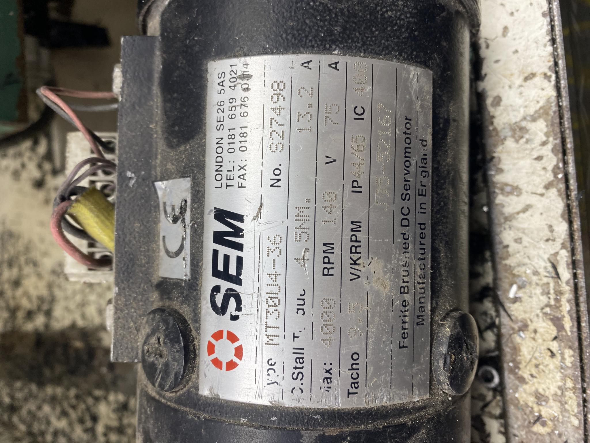

    the original motor was a sem, 4000 rpm but would stall sometimes so i converted it to the Chinese spindle. the sprint board has got damaged in storage. ideally a motor and vfd or controller with low down torque would be good .if there is nothing out there then im ok with swapping belts on pulleys

    An important question is whether the original motor is a wound field type or permanent magnet. My Novamill is a PM type. How many wires go in to the motor? If only 2 then it's PM, if 4 then wound field.

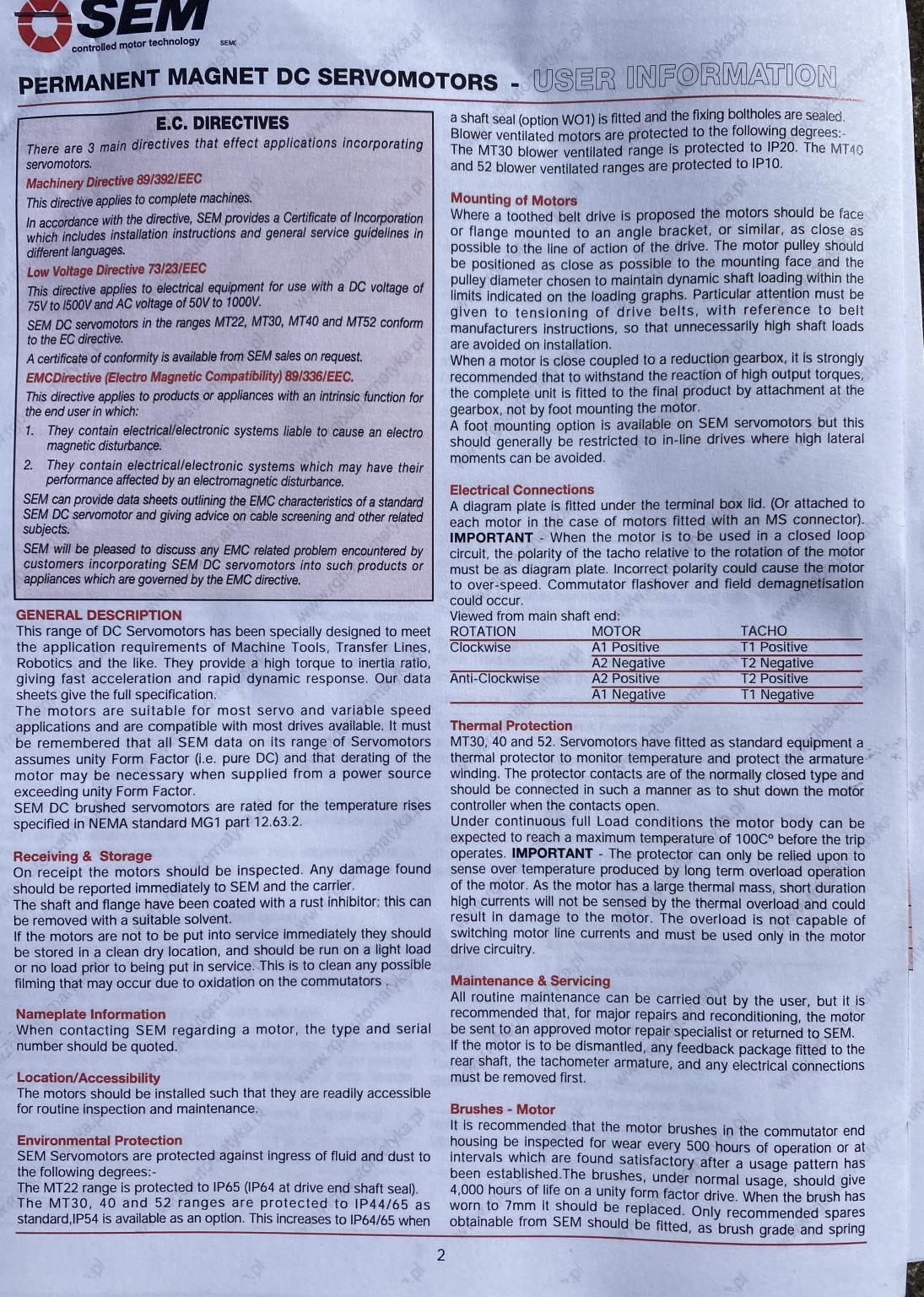

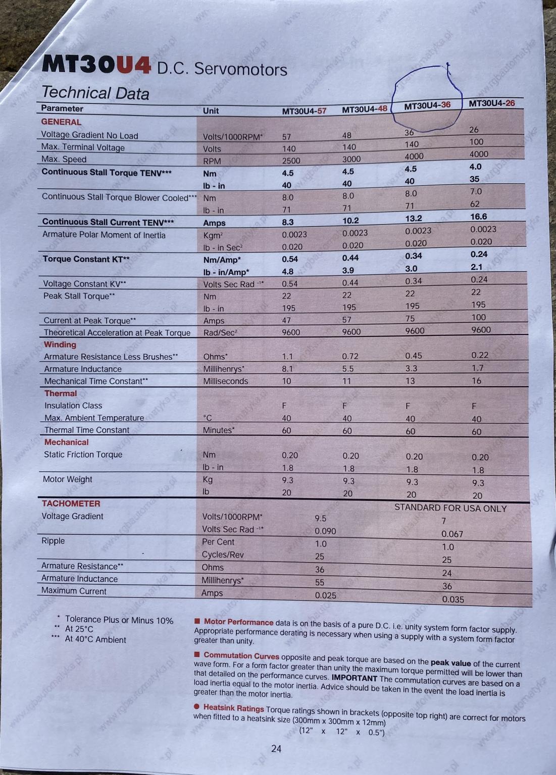

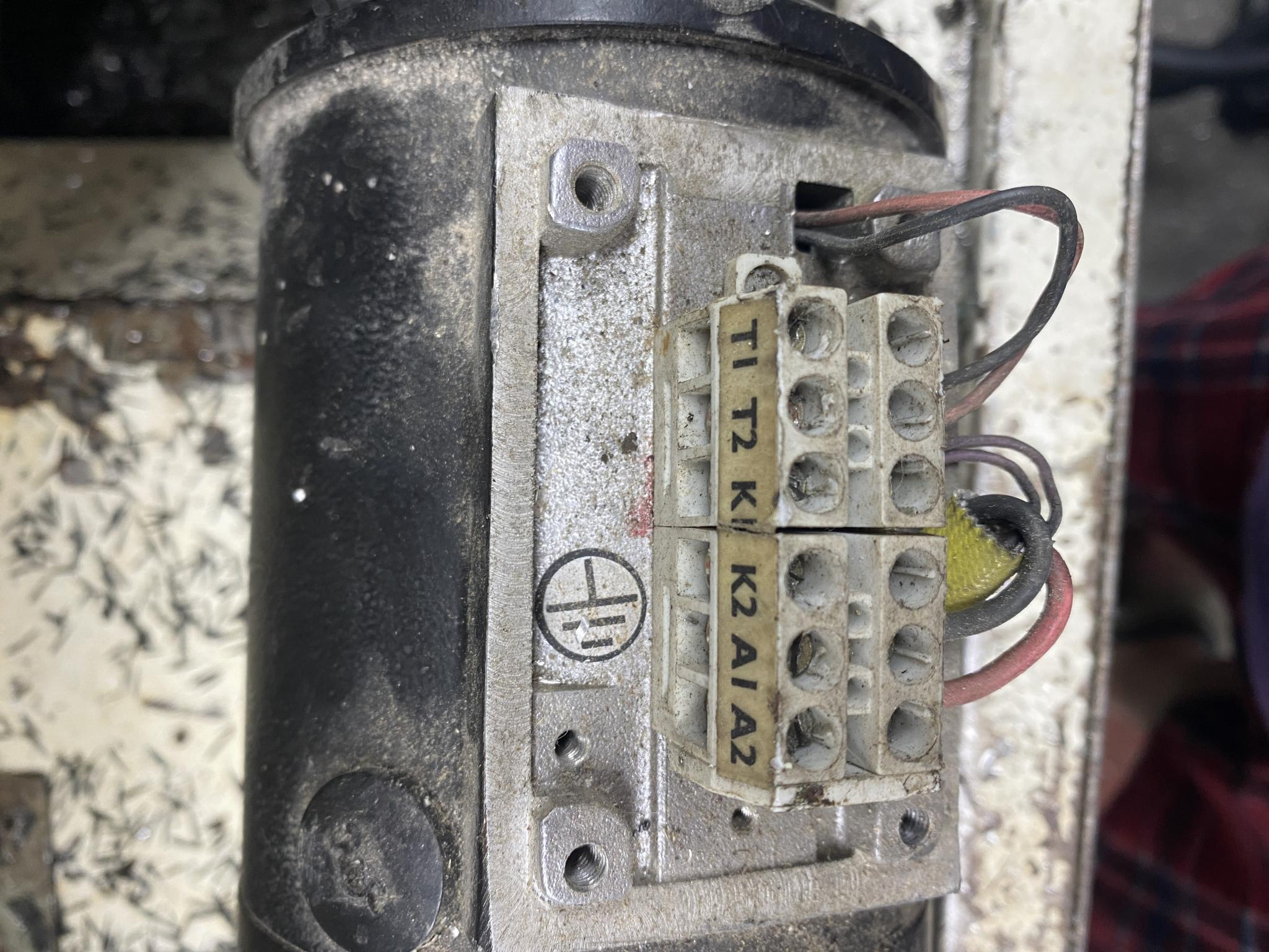

    Right, so appears to be a PM type with an inbuilt tachometer. I'm not sure what the K1 and K2 terminals are for. Do you mean 0-10V from a pot or the controller? I have seen on here a Sprint drive on I think a Novamill where someone was proposing to connect it to a 0-10V supply from a breakout board (part of a Mach3 conversion?) and the drive had a big CAUTION label on it warning against gounding either side of the 0-10V input - does yours have that on it?
