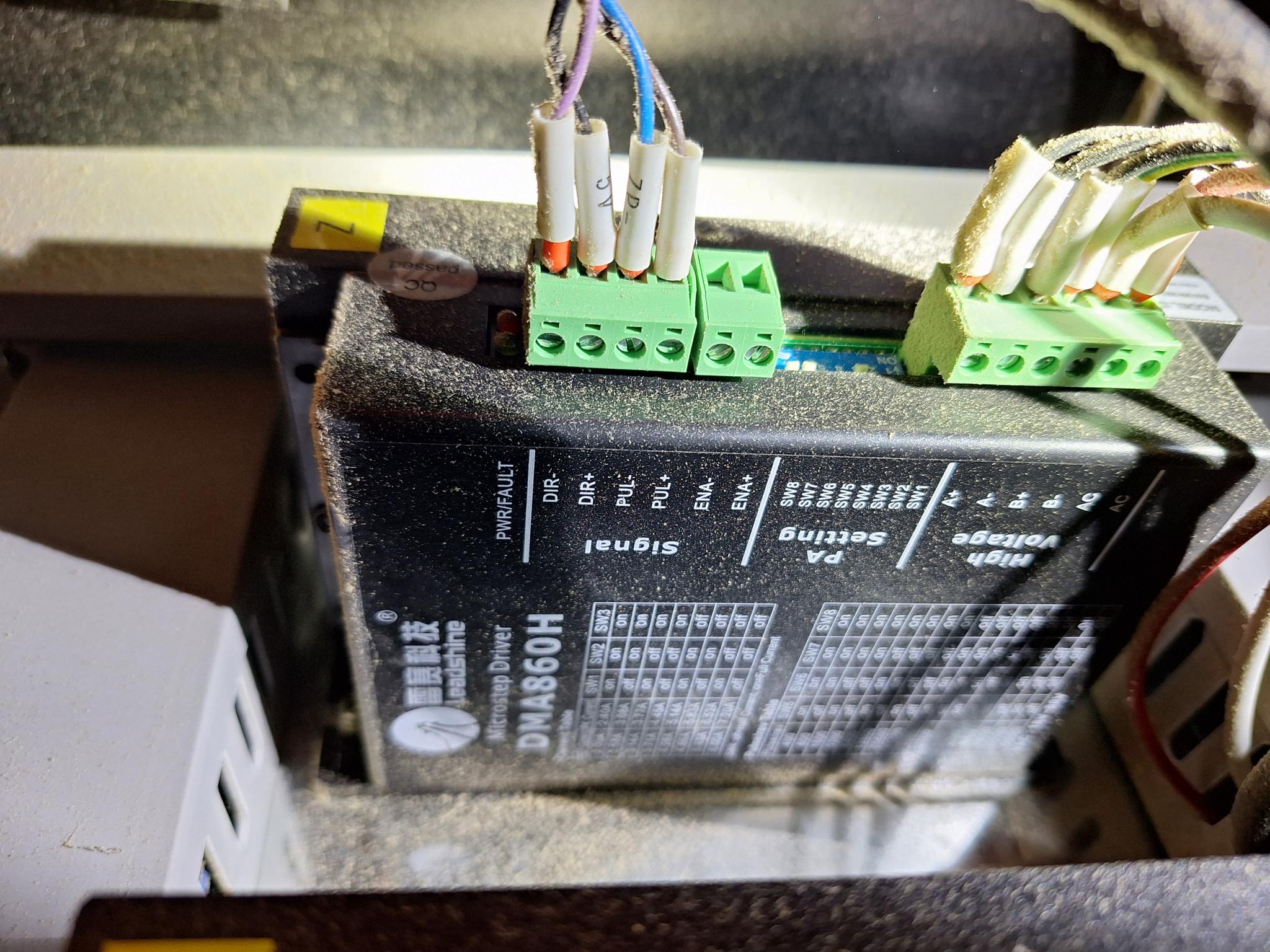

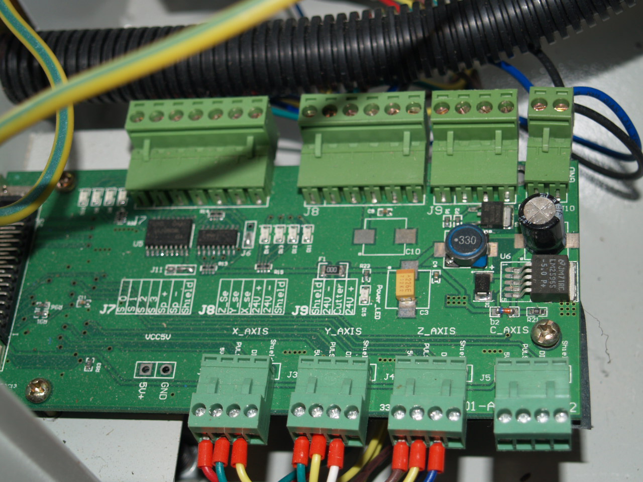

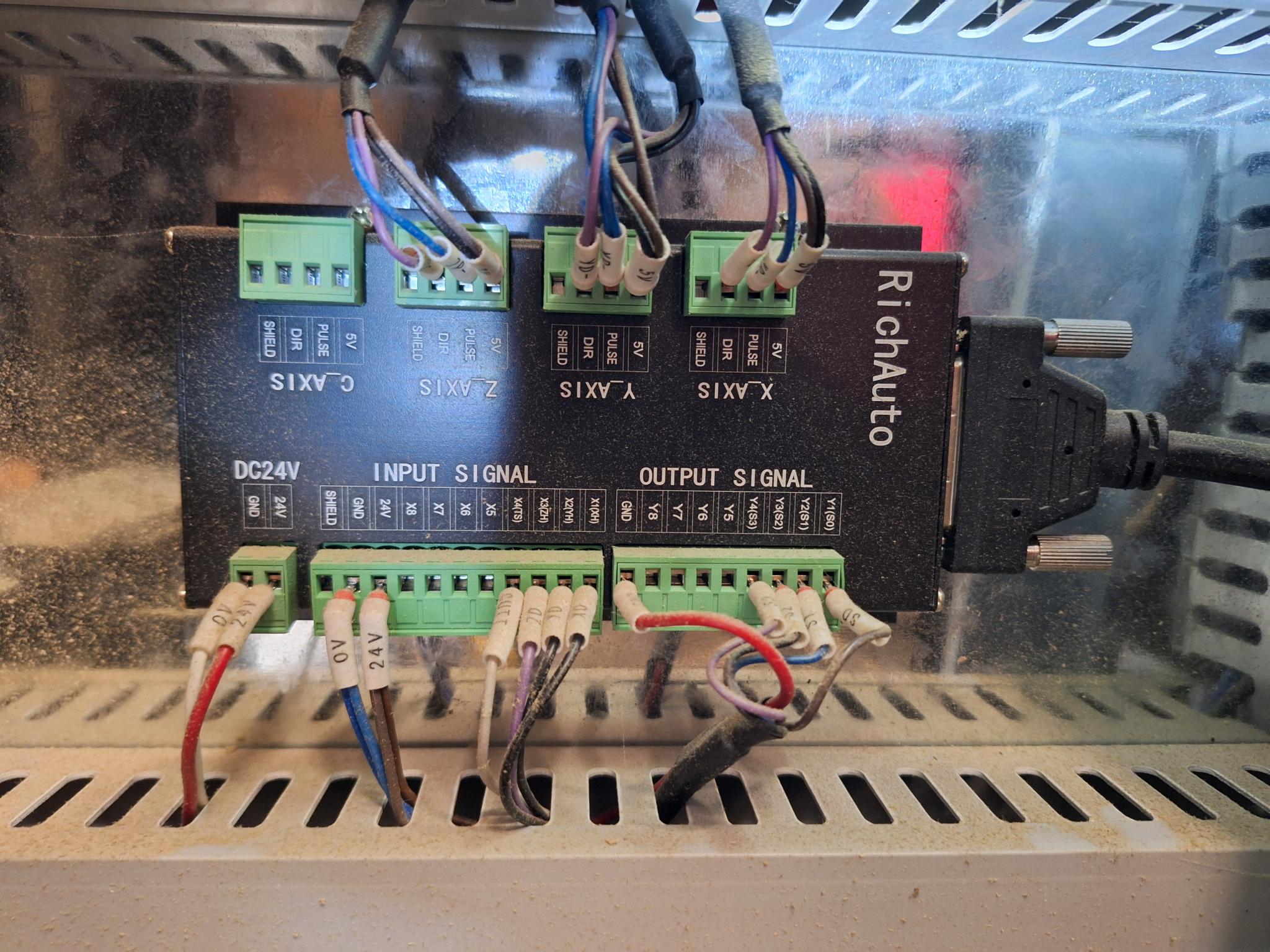

    Hi John,
    Thank you for the reply - I have a copy of the A11 manual and have been through this multiple times.
    I will triple check the direction wire connection again.
    Can you elaborate on the potential issue with direction signal and step pulse - How exactly do the two relate?
    The stepper motor is NEMA 34, and has 8 wires entering/exiting it if that helps with the diagnosis...
    Please see photos for driver, control board and stepper set up. I'm hoping the photos will prompt some more thoughts into the matter.
    Many thanks.

    UPDATE:
    I swapped X motor driver with the Z motor driver.
    I have not yet been able to reproduce the homing the wrong way issue BUT I repeated the lettering V Carve and pocket files in this order:
    30 Degree v-bit
    1/16 end mill and 1/8 end mill for pocket.
    30 degree and 1/16 end mill were flawless. Unfortunately 1/8 end mill toolpath did not go to plan. The lettering was destroyed with what looks like horizontal fluctuation/ abnormal movement likely caused by x axis issue.
    Therefore this is likely to be a bad Leadshine DMA860H microstepper driver.
    I am fully aware that any electronic product can develop faults but how likely is this?
    Has anyone else had driver issues before?

    About 30 mins ago, turned on the machine, homed all axes and X moved in the positive direction rather than negative. Fault diagnosed as driver and I have a new one on its way.
    What were the symptoms of your DSP problem so I know what to look out for?
    Thanks.
