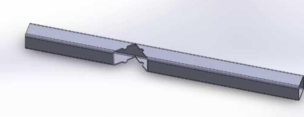

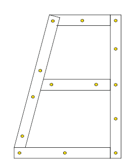

Frame Gantry Uprights - Looking to use 30mm box section which has been laser cut and folded. The plan would be to get the laser cutter to cut holes where I want to run bolts, I will then add a 4 or 6mm steel plate to each side and bolt through. Effectively making a wide, strong steel upright. My welding skills are not great at the moment, hence the plate and bolt construction. I've given some ideas below on shapes etc, by all means, let me know if I should look at some other designs. Getting the supplier to do the majority of the work saves my time so it just becomes a buy and bolt together, a big kit.
ID:	32303Click image for larger version.

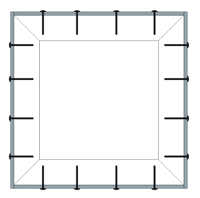

Gantry - The plan was to create a 200mm, square torsion box from Birch ply and then line the outside of it with 1.5mm steel plate. Now Im thinking of going with a box section frame and bolting/screwing steel plate to that, bascially making a big box section. This will be 200mm square. We can go bigger, ideally, I would like to have 200mm under the gantry just in case we get asked to machine any oak beams etc.

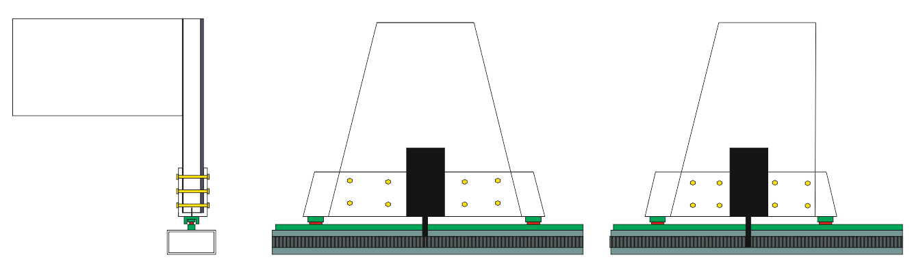

Here are a few ideas on mounting options for the rails/rack
Gan 1 - The Gantry sits on a 100x100 steel angle iron, the cars are offset slight to allow access. The angle iron is cut in line with the composite.

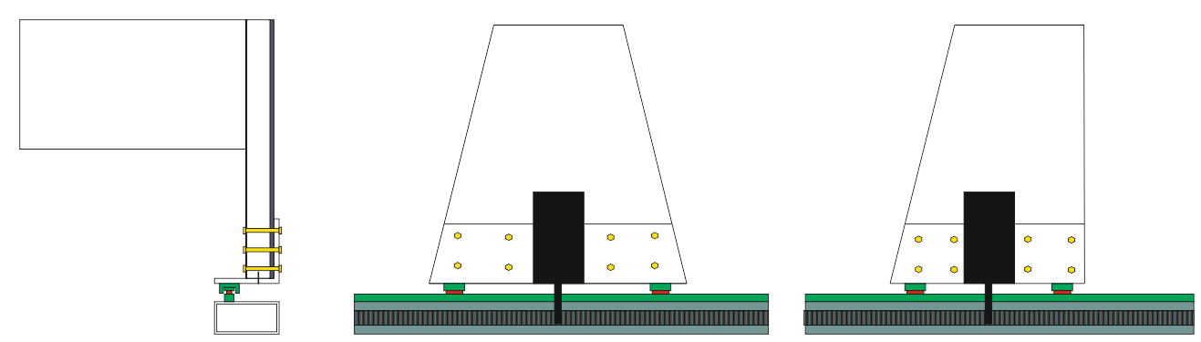

Gan 2 - The gantry sits on a 100x50mm angle iron, this then extends out of the side of the composite and the cars are bolted to it. This gives the advantage that the gantry forces go straight down.

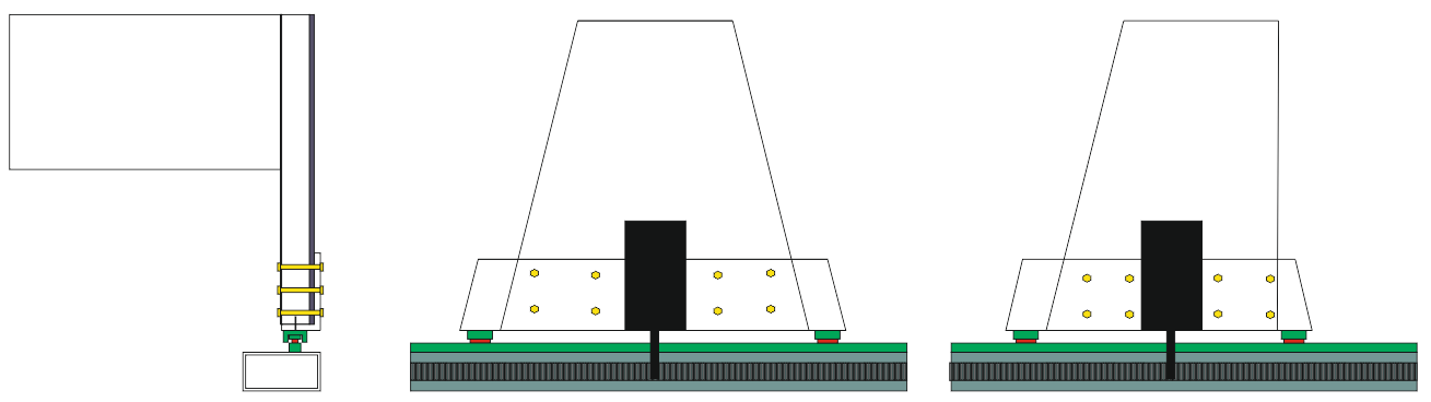

Gan 3 - The Gantry sits on sections of C Channel and then everything is through bolted on either side. These then extend out of the sides like Gan2, allowing the forces to go directly down.
