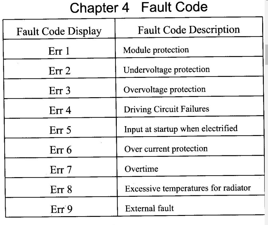

    Error 6 is for over current. I get the error when I put the motor under load. So when I am grinding hard on something at a higher speed.

    Well, here are the error codes:
Name:	XSY-AT1 error codes.png
    OK, sounds like was over current originally so P076 could go up again but I wouldn't load it too long like this. I don't know what else to suggest as I don't want to damage your motor. The old motors were not so inverter friendly so you could try running it at 60 Hz (3450 rpm) unless it is a newer motor designed for inverters.
