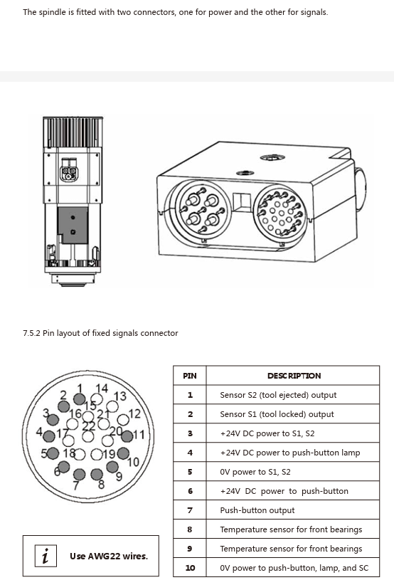

    My Spindle model
    GDZ143X133-9L
    I have the Spindle power hooked up U, V, W but nothing else....

    This is my interpretation of the wiring (but I'm too scared to try it out in case I fry the bob) I'm not 100% confident where the wires go to be honest, I'm not sure if the should all go to the bob or some to the VFD?

    I've only had a quick look, but the following things stand out-
    - Shouldn't the push button lamp be connected to an output? (You'd ideally want some code so the button only illuminates when it's active)
    - You have S1 and S2 twice (going by the fact they have 24V and 0V connections, I'm guessing these are inductive sensors, so you'll need to check how the output switches, but each will only need a single input)
    - Is the temperature sensor a switch, or a thermistor? (I've not searched for a manual, but going by it having two wires, and there being a separate thermal switch on the power connector, I'm guessing it's a thermistor, in which case you'd need an analogue input to make use of it in the software)

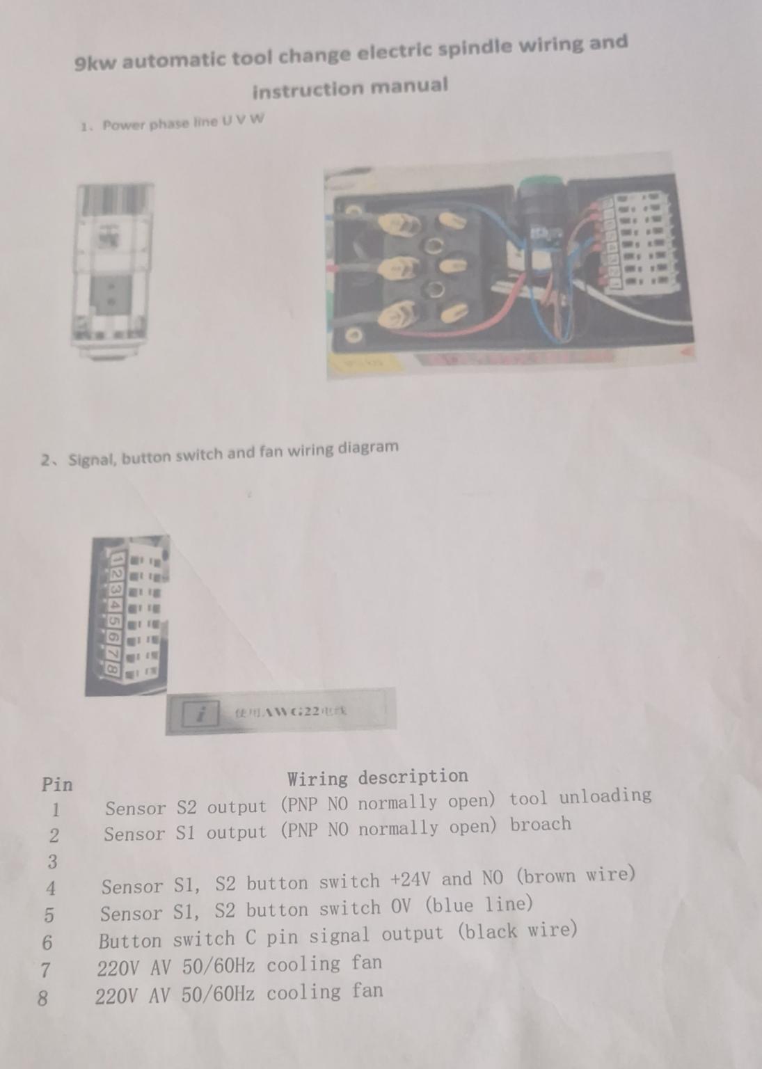

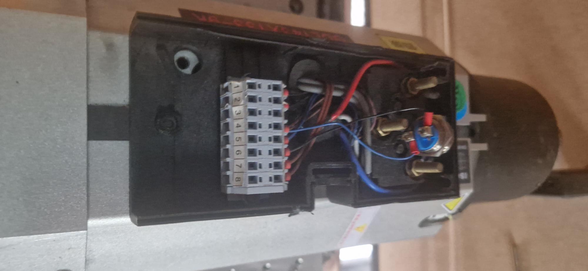

    I'm a bit more confused now, I've just decided to physically have a look at the Spindle and took the Cover off to look at the Wiring Terminals and they aren't like how they show in the Manual.
    There are just 8 signal Screw Terminals plus U, V, W Power, and Earth
    I also found this online which looks precisely like my set-up

    and here's a pic of my Spindle with the cover removed

    You'll need to redo your wiring diagram to suit.

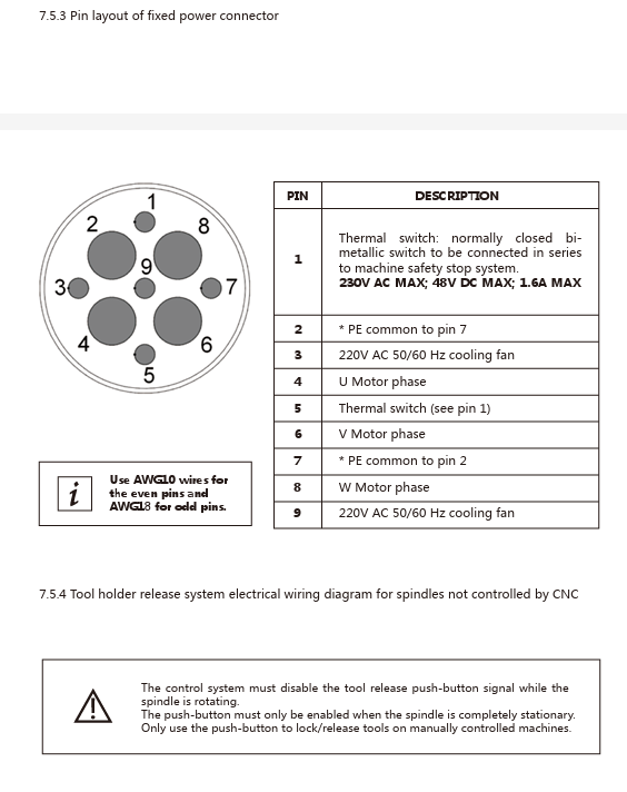

    You'd need to know the technical details for the temp sensor, but it looks like yours doesn't have one.
    The thermal switch can either be wired into the E-stop system, or to an input that triggers a stop. The main thing is that the spindle gets stopped once it triggers.
    The polarity of the 240VAC fan doesn't matter, and PE means Protective Earth.

    I think Pin 6 is now the Thermal switch, so I've added this to the input. As you stated, once configured in UCCNC, this should trigger a stop, shouldn't it?
    Lives in East Lothian, United Kingdom. Last Activity: 6 Hours Ago Forum Superstar, has done so much to help others, they deserve a medal. Has a total post count of 2,990. Received thanks 374 times, giving thanks to others 9 times.
    Pin 4 should be a 24VDC supply, not an output.
    If your spindle doesn't have a push button, and going by your photo, it does look like Pin 6 is a thermal switch, in which case once configured in UCNC, it should be able to trigger a stop.
    Ahh yeah, I'll change Pin 4 to Input, this Spindle does have a Push Button, although you can't see it in the last pic as I covered it with the pin-outs list, its in the previous pic (post no. 4) it just hanging down, it fell out when I took the cover off
