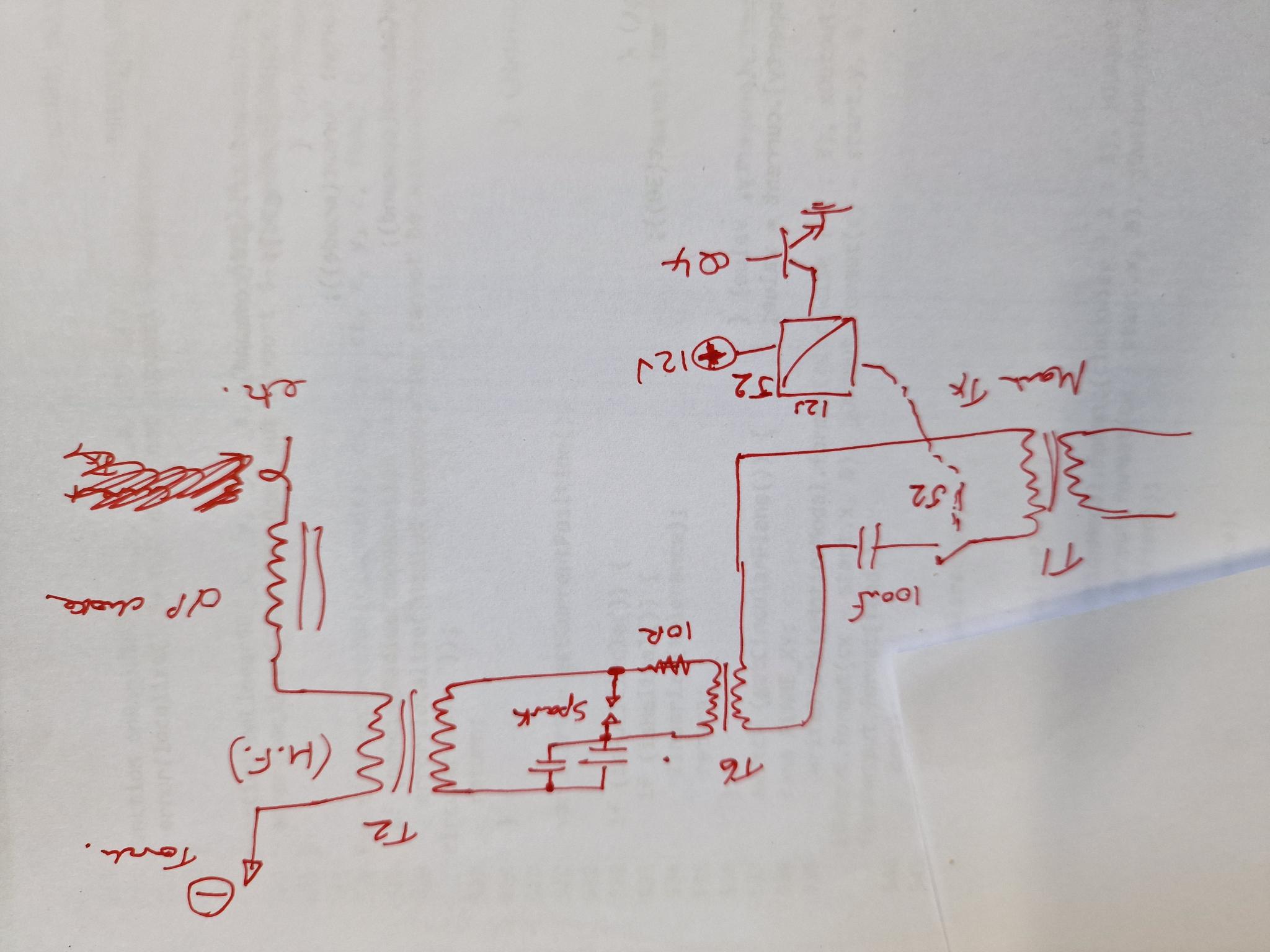

    One requirement for a CNC plasma source is to implement a pilot arc starter. Although the internet is full of people connecting the pilot earth wire to the ground connection on an HF machine, that seems to be a bit of a bodge that damages the consumables and robs the arc.
    A better scheme that is used on the more professional machines is to disconnect the pilot arc when the main arc is established to the workpiece. Of course, in these machines it is straightforward to control the pilot arc using the HF enable circuit but to modify a non pilot arc machine in this way requires a bit more surgery. There are add-on circuits that detect the arc voltage of current but it seems to me that the required control signal is already present within the unit.
    Naturally I have wasted no time extracting the main PCBA from mine. I'm going to fit a second relay across the HF circuit relay and bring a couple of wires out. Usually there's also a power resistor of around 5 Ohms to limit the pilot arc current.

    Schematic of HF circuit:

    I am of course talking complete and utter twaddle. And not for the first time. The pilot arc earth connection needs to be maintained until the main arc (to the workpiece) is established, whereas if I controlled it with the HF start relay, I'd kill off the pilot arc as soon as it established. It would probably just buzz on and off until something broke.
    The only sensible way to enable and disable the pilot arc would be to monitor the main arc ie the current in the ground lead. So a DC current controlled relay (Hall effect sensor with comparator and relay) would sound like the best solution, unless I want to get really invasive and risk blowing something up.
    Something like this perhaps https://www.amazon.co.uk/dp/B0CX52TP...fed_asin_title No idea how low the current can be adjusted but I could always put a couple of turns through the hole to increase the sensitivity.
