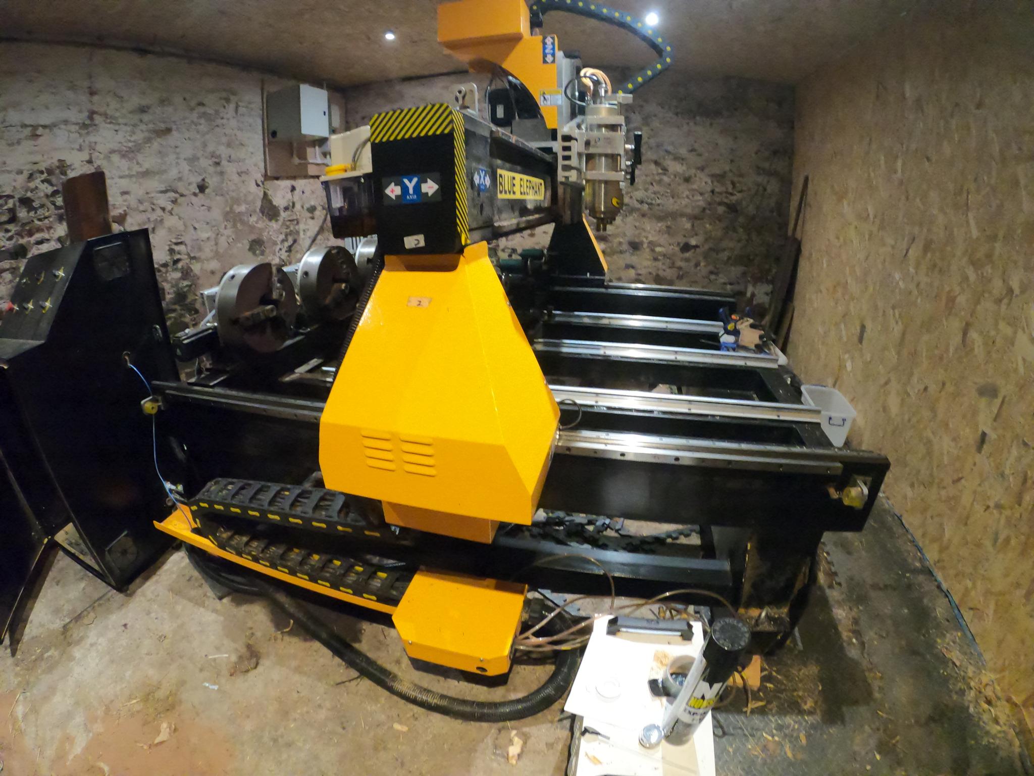

    I'm having trouble with my first CNC. She's a 4 axis 4 spindle Blue Elephant, purchased second hand. It's 3 phase no neutral.
    Problem I'm having is:
    there is 70 volts on the floating earth relative to true earth. First noticed after I got a tingle on the cabinet while initial testing.
    I've been through the machine with a standard multimeter looking for anomalies, with zero answers.
    Purchased a megger and tested at 240v. Nothing showing up! Is it lunacy to test at 500v?
    I've received quotes from repair specialists that would make you weep! Hoping to crack it myself. I'm just a hobbyist you see.
    Ideally someone has knowledge of the likely culprit, that would be a massive help!

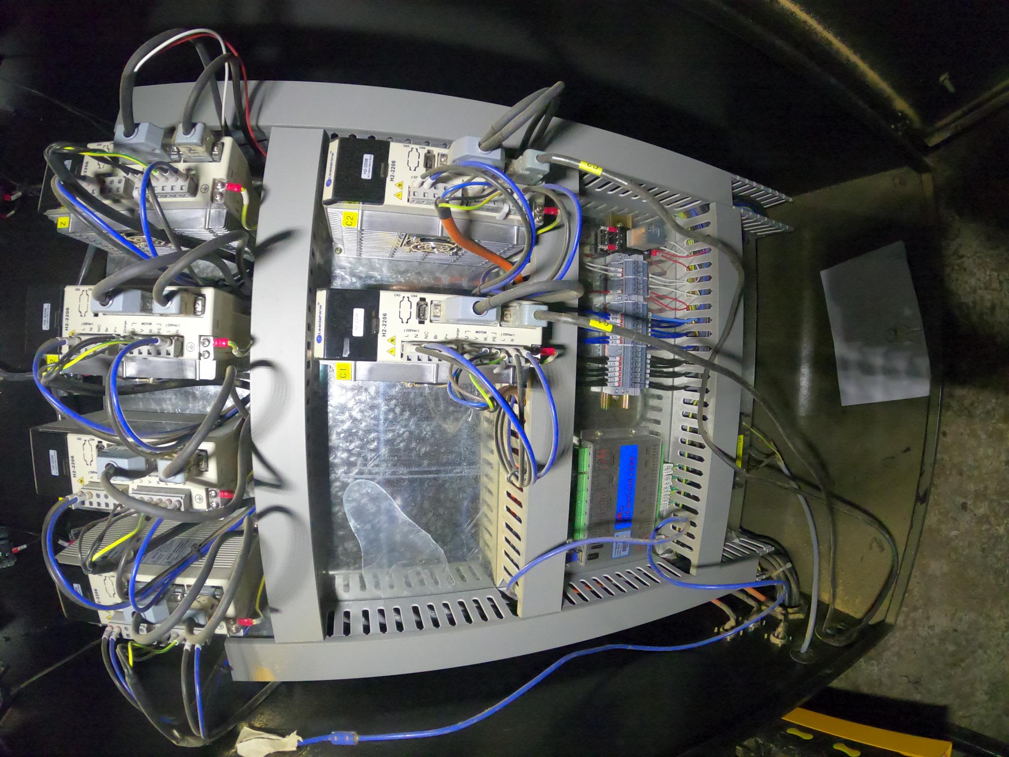

    Basic component list:
    6x H2-2206 Hybrid Easy Servo Drive
    6x Leadshine 863HSM80H-E1 Servo Motor
    4x Fu Ling Inverter DZB200B002.2L2DK 2.2kw 220v
    4x 2.2kw chinese water cooled spindles

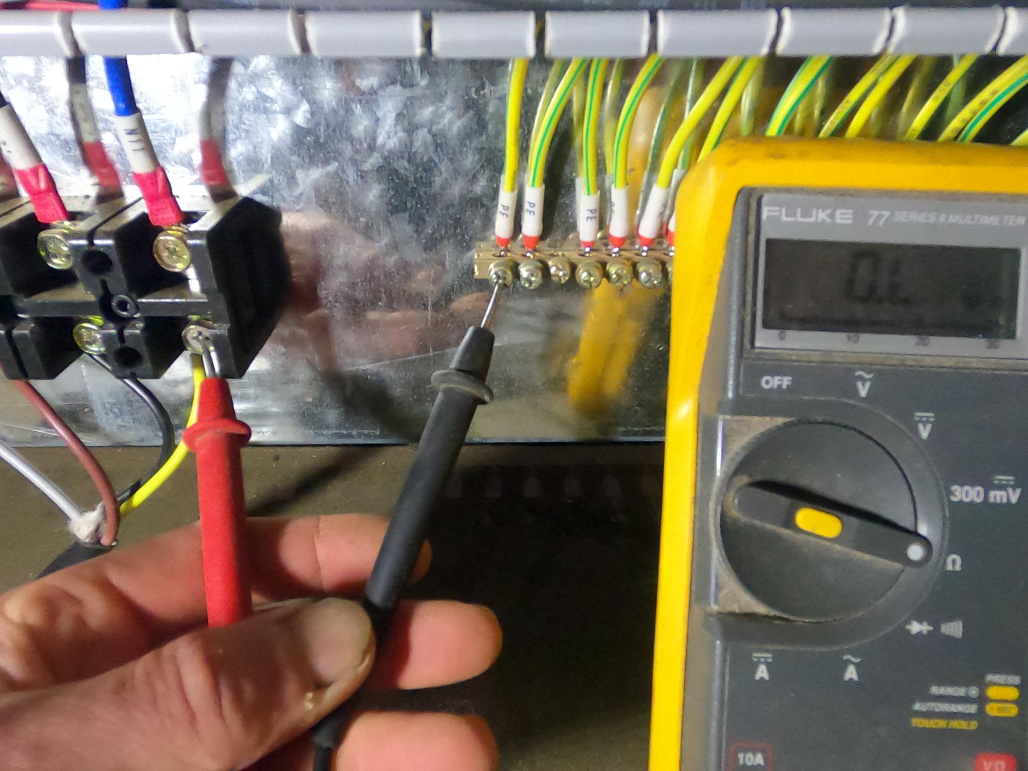

    Below is a photo showing 0 continuity between the earths and actual earth. The RCDs are not connected to the machine's earths, would explain why it's not tripping:Click image for larger version.

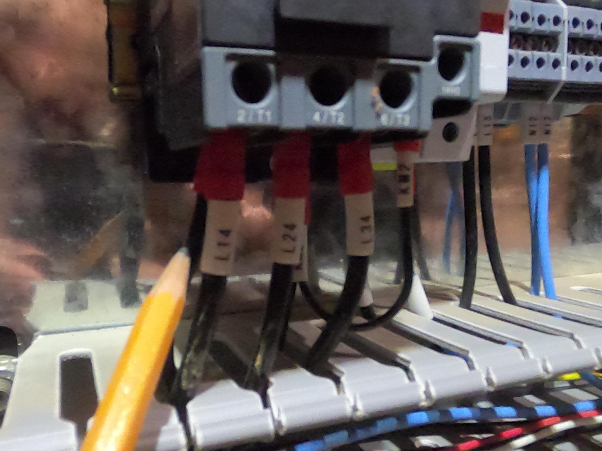

    You are correct with the drivers, they're single phase. I've traced back there supply and it's directly from a phase, through a 20A fuse and EMI filter. This phase also supplies the cabinet fans and a transformer for the 24v motion control board. The neutral from the drives is connected to the supply earth (though the emi and fuse also). Pencil pointing at the single phase suppy.
