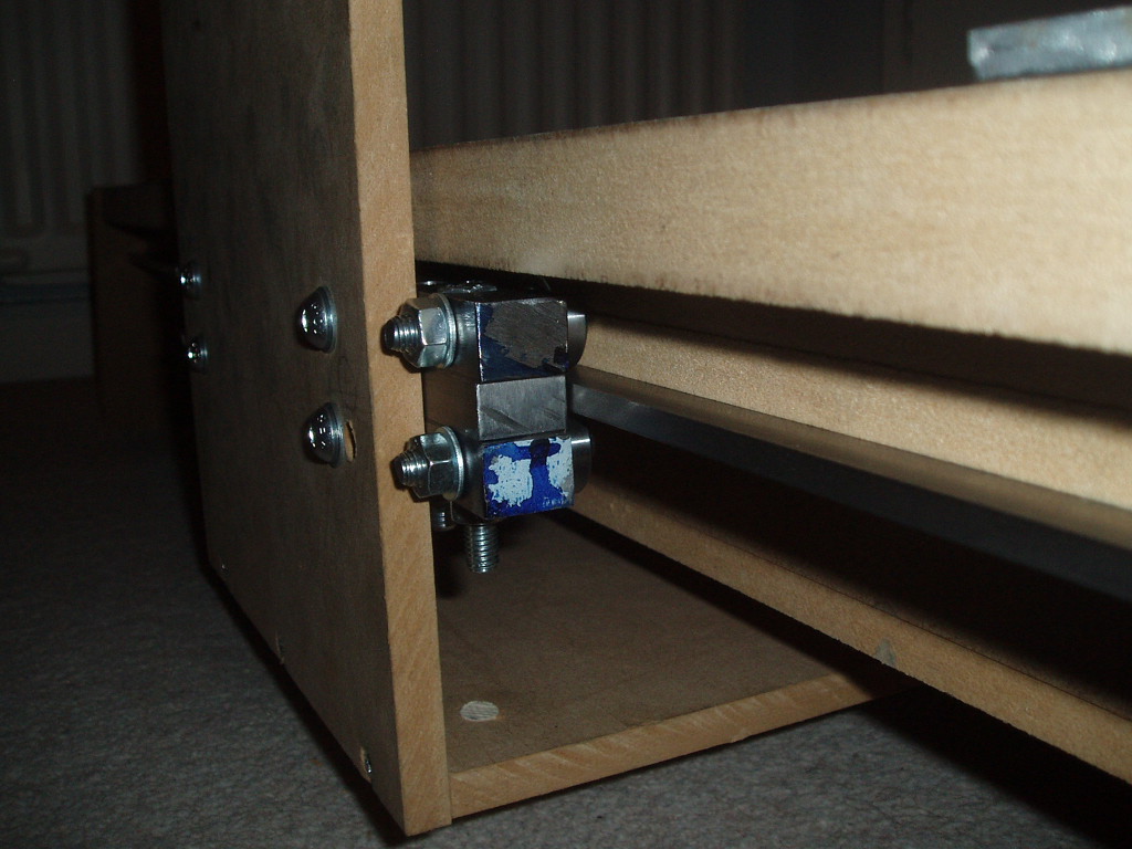

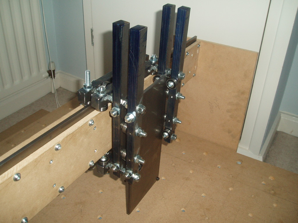

    I think the cold drawn steel will help a lot with stiffening up the bed as well if it is well thought out. I am hoping to build it once and use it lots so I think over engineering now rather than a catch up job later will serve me well. are you using the 6 runners on a block style or a different version Tom? Have you used them on all of the axis as well?
    The rails were actually surprisingly floppy. The X are 50x6mm section. Y are ~30x6. The Z plate is 210 x 125 x 6. I think I've got Y and Z steel left over if you're interetsted - you're welcome to some / all of it for cost + postage (minus a bit because it's going no-where at the moment!).
    There are some pics attached to give you more of a flavour of what I did...

    Ah good stuff Tom I need to go visit my local steelholder they are a good set of guys so hopefully they will be able to source me some. If not though I shall take that spare stuff you have and add it to the parts collection :)
    These are the linear carriages I am looking at, they are finelineautomation ones and are a nice compact simple unit. I need to change the hole arrangement around to get them to bolt up to my aluminium extrusion for the gantry mount I am thinking of one rolling on the top and another rolling on the bottom of a sheet of CDS or possibly along a sheet of oilon plastic I need to check the rigidity of it but it is a self lubricating HDPE plastic. that should give me a rock solid gantry and hoefully belt driven should be able to shift it's weight around quite rapidly.
