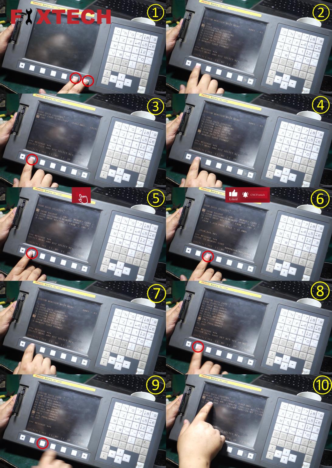

    Just wanted to share something important that might save you a lot of time and trouble—backing up the SRAM on your FANUC CNC controller. It’s a simple process, but often forgotten until something goes wrong, like a dead battery or system reset.
    Here’s a quick guide based on the FANUC 0i-TD controller:
    1. Power On and Enter System
    • Press and hold the power button to turn on the machine.
    • Navigate to the system parameters page.
    • Ensure the SRAM card is properly inserted into the slot.
    2. Access the System Menu
    • Open the system menu.
    • Select the second option: USER DATA LOADING.
    • Check that the SRAM card is empty (no parameters stored).
    • Select END to return to the previous menu.
    3. Perform Parameter Backup
    • From the system menu, select the seventh option: SRAM DATA UTILITY.
    • Choose the first option: SRAM BACKUP (CNC → Memory Card).
    • Confirm by selecting YES, and wait for the backup to complete.
    • Return to the system menu and select the sixth option: SYSTEM DATA SAVE.
    • Scroll through the options and select option 47: PMC1.
    • Confirm by selecting YES, and wait for the backup process to finish.
    4. Verify Backup Files
    • Go back to the system menu and select USER DATA LOADING again.
    • Check that the SRAM card now contains both parameter and PMC data.
    • If the files are present, the backup process is successfully completed.
    Why this matters: Without a proper backup, losing your system data could mean unexpected downtime and reconfiguration work.
    By the way, we’ve also made a short video showing this whole process. If you're interested, just drop a comment below and I’ll be happy to share it!
    Thanks for reading, and I hope this helps someone out there. Feel free to share your own tips or backup habits—I’d love to hear how others handle this!
