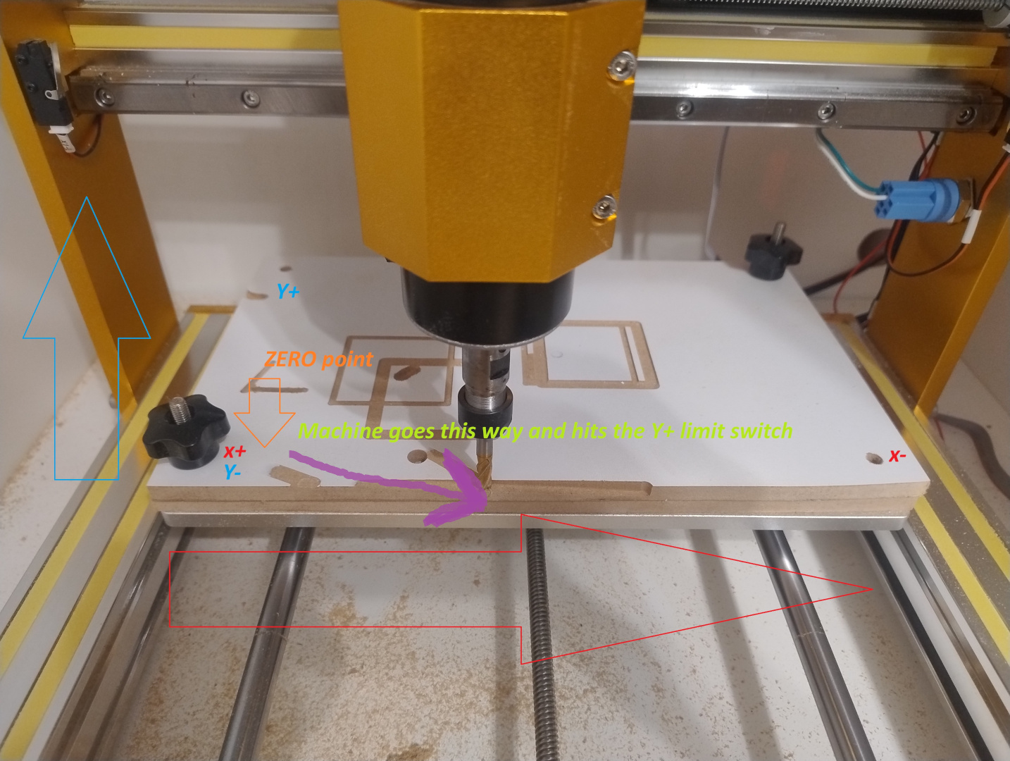

    Greetings all,
    I bought this hobby CNC: Luynee 3018 ULTRA : https://www.lunyeecnc.com/products/3...graving-dreams
    I assembled the machine accroding to the included instructions + videos I checked.
    Installed UGS and followed the instructions in this video to do my very first CNC cut: https://www.youtube.com/watch?v=mUO6d7MaeCA
    I did a couple of tries and the machine moves and cuts alright, but what I noticed is my controls are not right.
    When I press the "X-" (left) on the jog controller it goes right, same for the X+ (right) it goes left. Same for Y+/-. Z is OK.
    How do I fix that? I can see in that video, that the person presses left and it goes left, not the other way around.
    This is my machine:

    Thank you for checking this out. I managed to flip the controls and it looks OK IMO. I will give it a test today and see if it really is right. I've only done a few test cuts as you can see from the picture. Baby steps... :)
    Yes on mine the up and down seemed to go opposite ways but it was actually doing the right thing. Yes I’m at the same stage as you. Easy has a free month and they have loads of patterns you can use to try out your tooling and speeds
    I have an entry-level license for Deskrpoto, so that's my CAM software. For G-code I am using UGS. I fixed the directions, but the image is flipped and instead of down left as a zero point, machine starts on the uper left corner an does the image upside down if I am facing it. Also, zero point on the suface doesn't work for me. I need to figure these parameters out.

    If your controller is using GRBL, then there are settings in GRBL to reverse the directions of travel - its simply a question of typing a value into the settings - There is a lot of information online how to do this. Try this: https://github-wiki-see.page/m/gnea/...-Configuration.
    Note you can set many parameters in GRBL - taake care, ,and check what you are doing.

    Yes it is using GRBL, thank you for the link, but I don't think that's the problem. The machine jogs correctly with $3=5. I came to the conclusion it's my CAM software that uses a different coordinate system. I need to correct the settings there. Machine is fine in my humble opinion.
