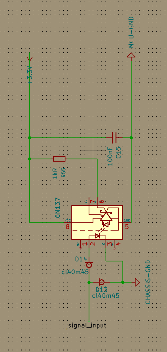

    HI, its me from youtube. So from my project I have been collecting analog parts and stuff you might find useful.
    1. 6n137 (max input "data" frequency of 10MHz) optocoupler with a current limiting diode. Should be able to take any input voltage from 3.3V to 60V without issue (with the diode). image of circuit attached.
