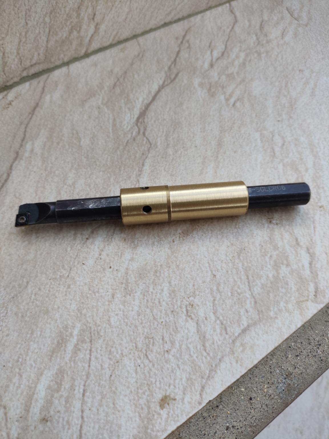

Hallo, I have a n 18 mm bore bar milling holder for my Ferm 350 lathe. Now i am confused about which cutter tool to use a right handed or a left handed tool.
Google says right handed, but when I look at thephoto on the sit , the tools are lefthanded.
Which one should I get, and pleas provide a reasoned explanation as to why.

The boring head is threaded onto the arbor with a normal right hand thread, so it can only be used with a normal clockwise spindle direction (when viewed from above). That means the boring bar will need to be a RH tool, so that the insert sticks out and travels in the correct direction.

Thanks. I believe a right-handed chisel goes from the inside out, so towards the opening.
So with a bore head, you have to go from the outside in, otherwise it won't work. In that case, I think you need a left-handed chisel.
That is just my logic, of course, but I also heard somewhere that a left-handed chisel is suitable for this.
I already have a right-handed one, so I bought a left-handed one to go with it. I never use left-handed chisels, because when turning you usually go from right to left. Turning out a hole is therefore done in mirror image.

Well, if you are using a boring head to turn the outside diameter of a part, you'd need to use a left hand boring bar. If you are boring out an internal hole, you'd need a right hand boring bar. There are some boring heads that can also do facing of the end of a part but this product is not that kind.
I'd say it's unusual to use a boring head to turn an external diameter, which is why I think you will usually find that the boring bars supplied or recommended are right hand. I would tend to use a milling cutter for external surfaces, rather than a boring head, especially if you have a CNC milling machine, or using a rotary table if you only have a manual milling machine.
Boring heads have only a single point cutter, so they are very slow means of removing material. And they aren't very rigid, so are not suited to heavy cuts. The main reason for using a boring head is when the finished surface needs to be a precise cylindrical surface eg for a bearing or an engine cylinder bore.

,,The main reason for using a boring head is when the finished surface needs to be a precise cylindrical surface eg for a bearing or an engine cylinder bore.,,
That is exactly what I want to do, brake cylinders refit.
I have mad a custom holder fot my cutters 18 mm, adjustable and fit easy in the boring head. I can use left or right handed.
