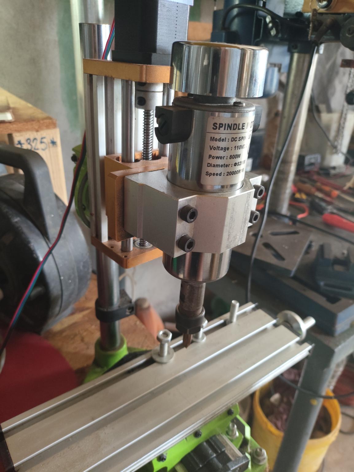

    I have a milling machine 800 watt and ER16 collet. Also a angled cutter of 60 degrees a good one. I want to rebuild the lathe complete, because it works great only small clearance and not very powerfull.
    The new motor is 2.2 kva, 3 phase, so we have plenty power forClick image for larger version.

ID:	32903 most constructions and also an ER 32 collet mounting plate.
