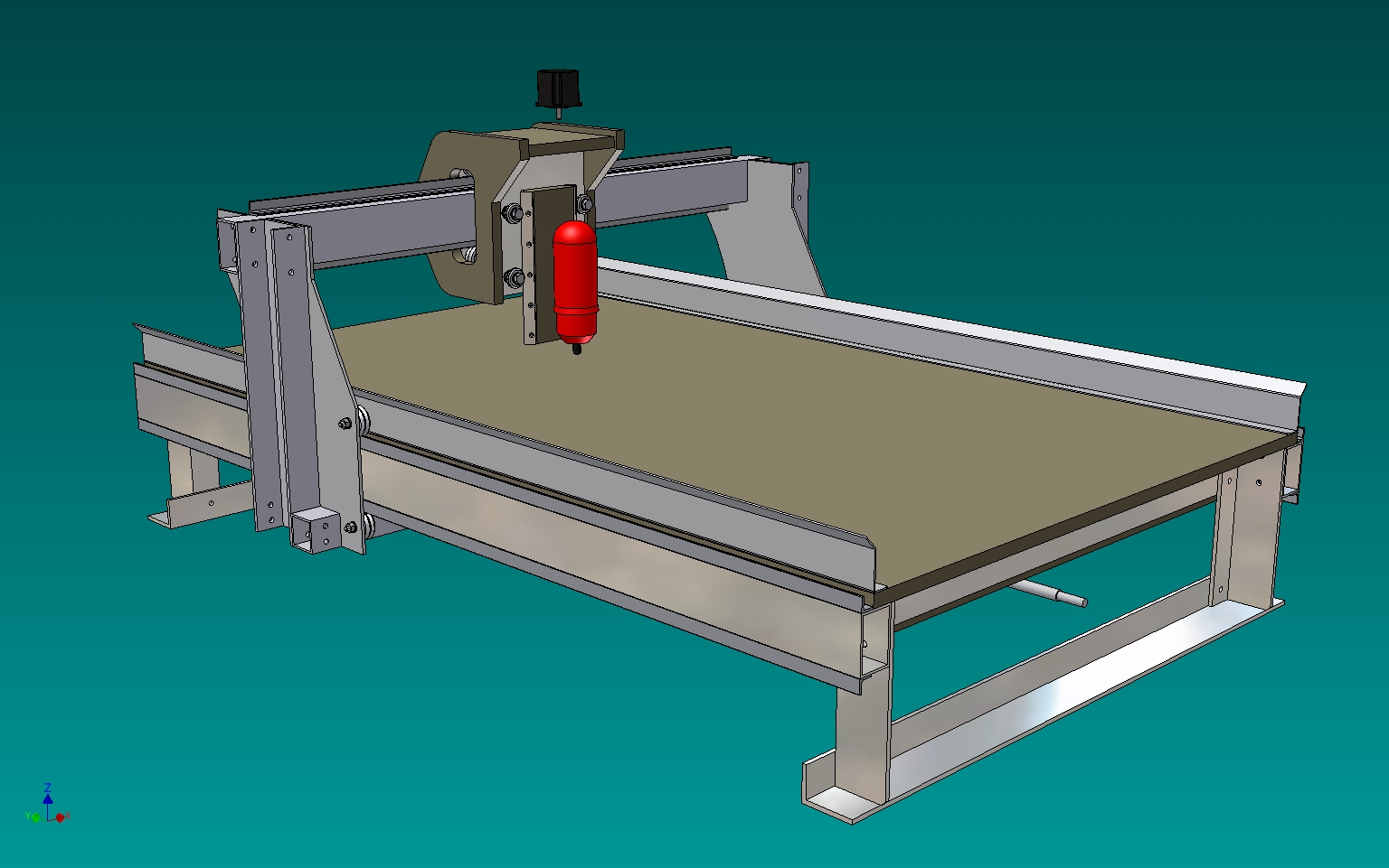

    Thanks for the suggestions, I had considered using counter holes in box section but theres an awfull lot of holes, and I want to keep it simple and as quick as possible to build.
    I did run some stress tests when I went for the channel, cant remember the results but it didnt deflect to much, I've no idea what sort of forces are involved, I just put a force of 500N in various directions at the tip of the router, I will re run them and post the results.
    If the channel twists to much I have thought about closing the open end with some folded ally channel as a work around.
    Thanks for the link and suggestion to the cable anti-racking system, I like the look of that, it appears straightforward to do and could be done afterwards if I get problems so I think I'll stick with the single center ballscrew and use something like this if it becomes a problem.
    Vic

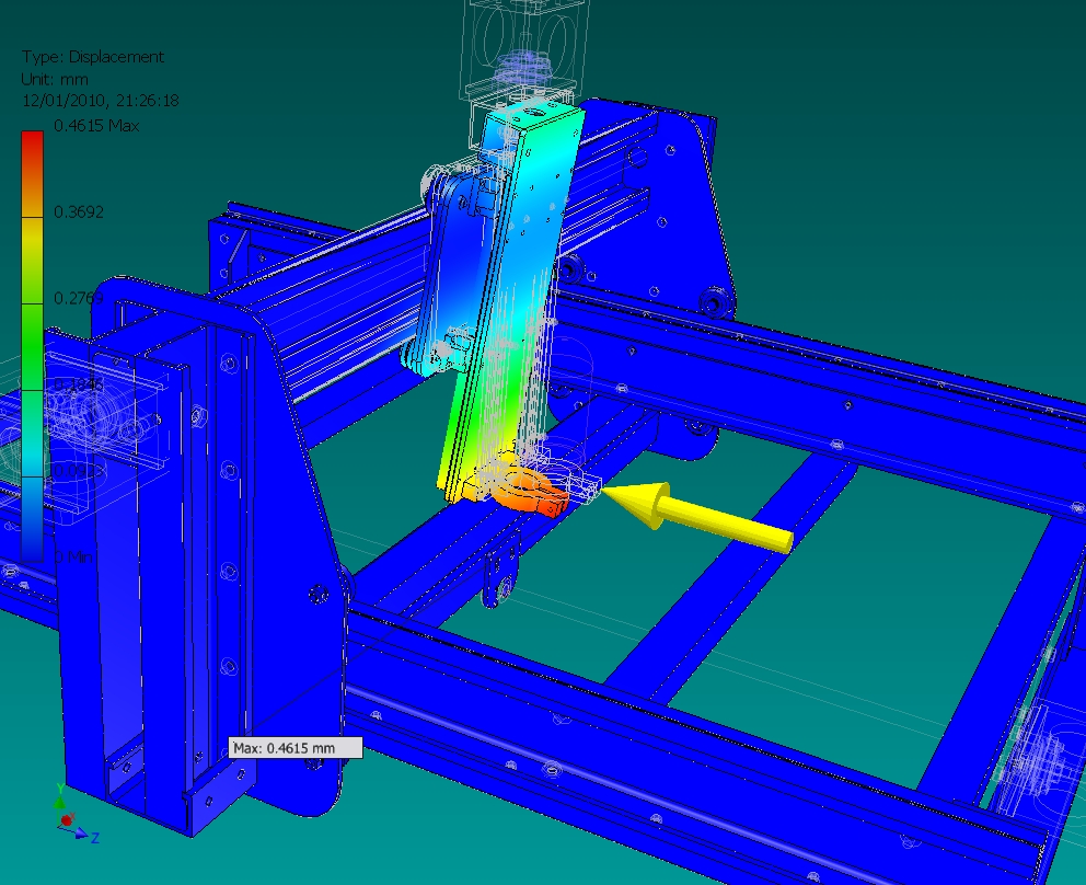

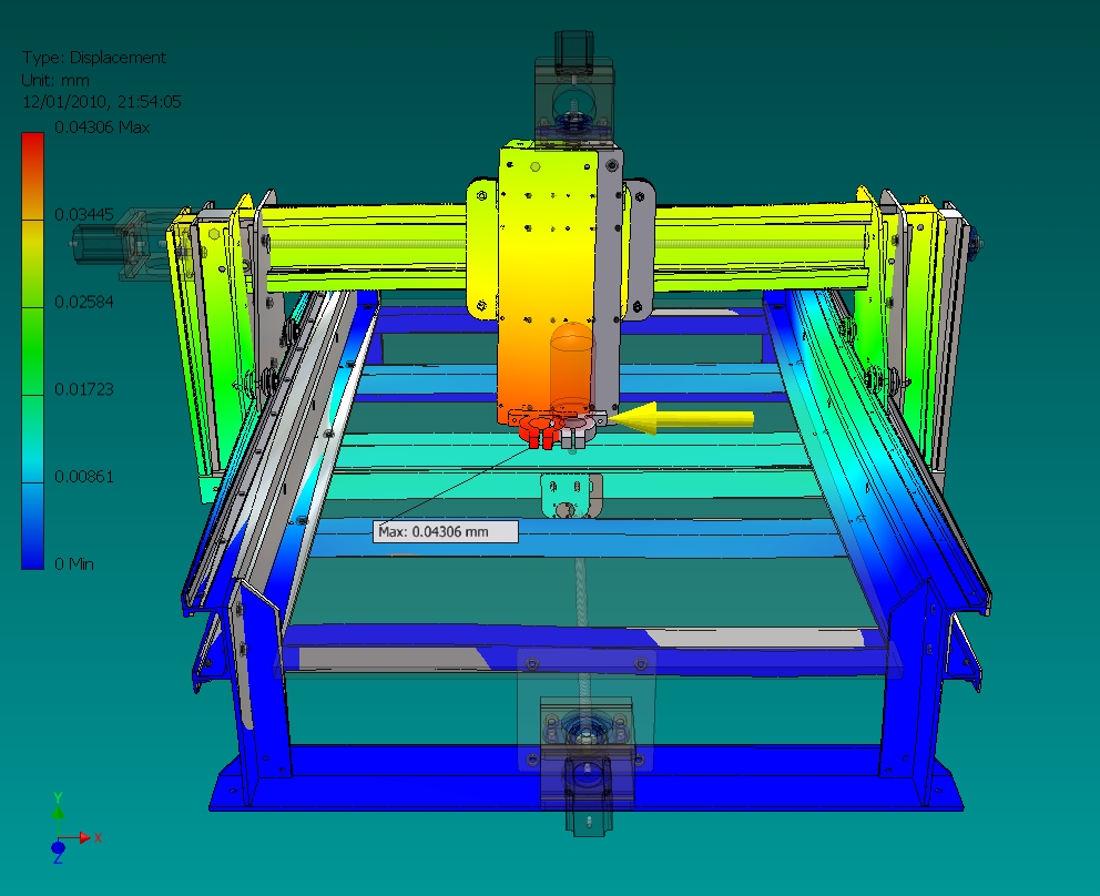

  6. #16
    Thanks again !
    I have applied a force of 100N in the Y axis direction and X axis.
    Visual representation is exagerated for clarity (I hope ! ) Red area denotes maximum deflection, arrow direction of force.
    I need to either replace the channel for the X axis or strengthen it somehow, I've no idea if .5mm deflection is acceptable on a router or am I being to fussy ?

  7. 0.5mm is OK if cutting wood as you'll never get close to 100N, 10 more like it... .05 would be a problem for metalwork. I'd still use box section, but i like to overengineer anyway...

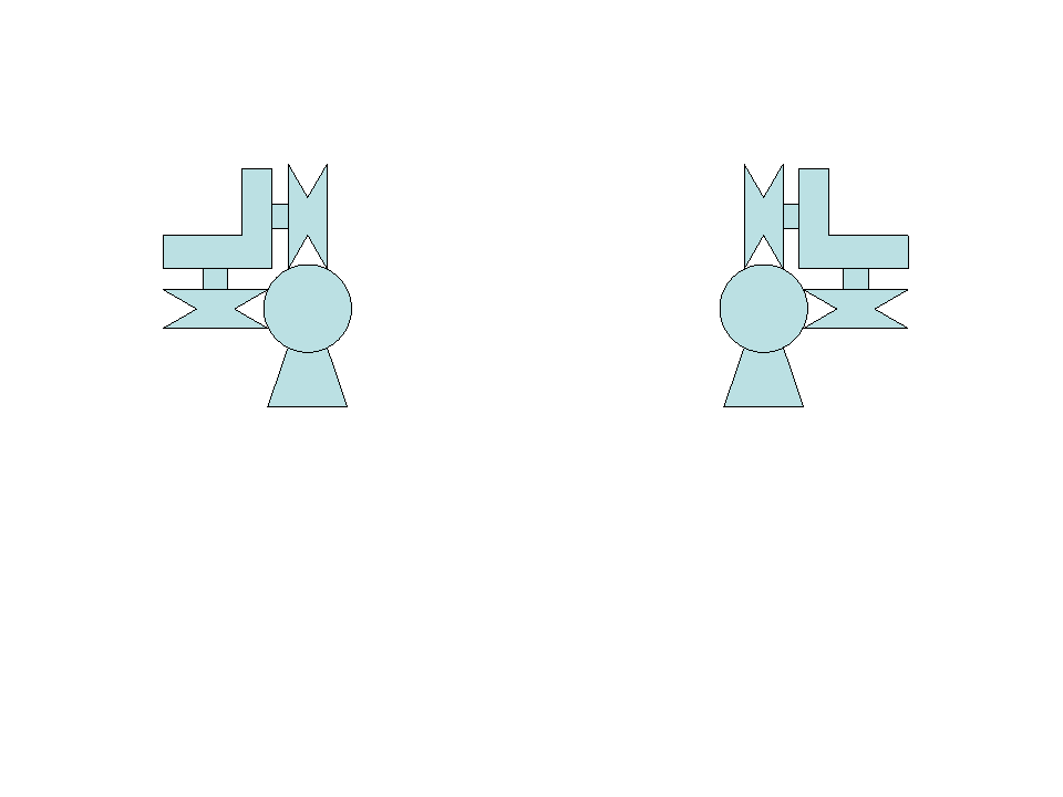

  9. Peter,
    I agree, If this was box section I would put a couple of skate bearings at 90 degrees onto the side of the box to contain lateral forces. Or better still use pairs of v-bearings at 90 degrees onto the supported rail as per diagram... (obviously not to scale)

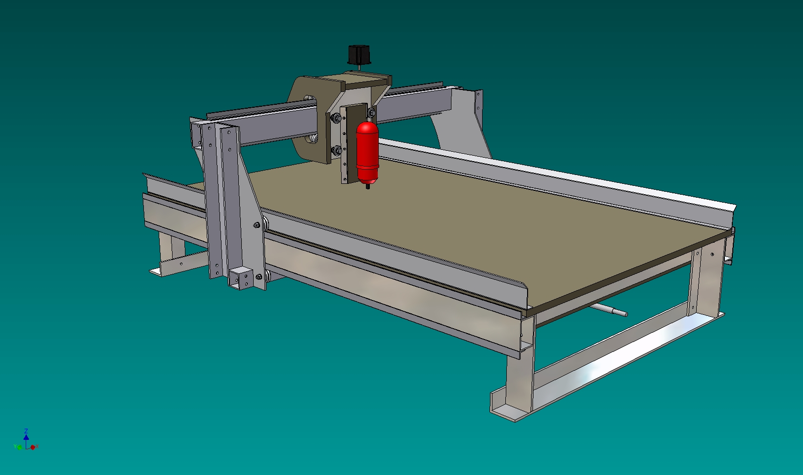

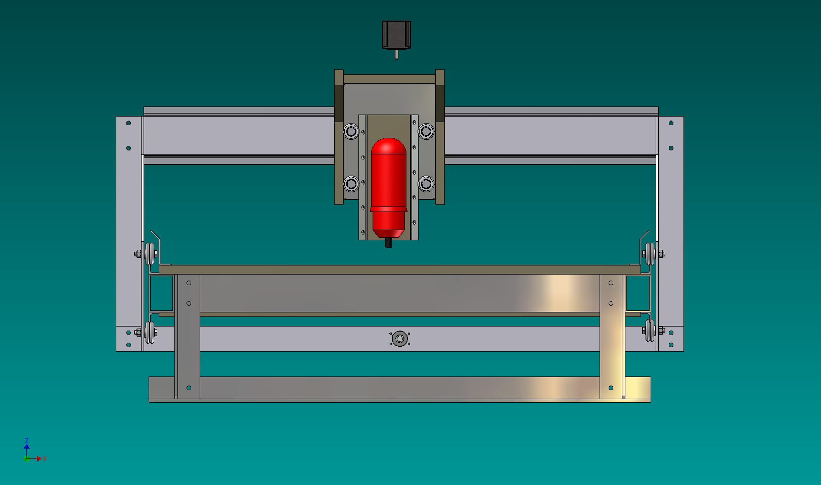

  10. #20
    According to Hepco, The dual V bearings I have (W3) are 5900N raidal and 1701N axial, literature here... http://www.hepcomotion.com/en/view-pg-21-view-6
    I aquired 12 of them from work for nuppence they were left over from a job, and based their use on Joe's Hybrid design here... http://www.joescnc.com/themachines-hybrid.php
    I was a bit skeptical about running them on steel angle rather than the ground V they are intended for but Joe seems to have had success with his design.
    I originaly went for box, attached pics of the unfinshed box section model below, I could return to box section, I've been thinking about what Irving said in a previous post about cutting access holes for spanners etc, this would mean re thinking the position of the lead screw on the X axis though, which could make the X axis carridge more complicated.
    I would rather not buy any supported rail, financially I have to run with what I have but I take on board the comments made about the side load on the bearings.
    With the forces Irving calculated would this be an issue though ?
    Vic
