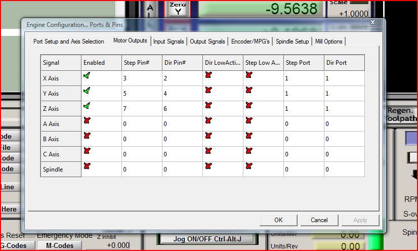

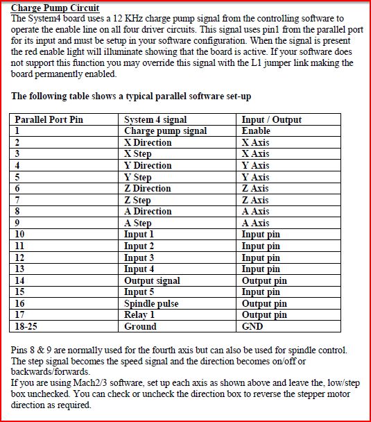

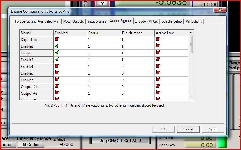

    Hello, i need some help from someone who has set up system4 on mach3
    i've even got the info that comes with the board in front of me, but i must be doing something wrong as the enable light won't come on.
    if anyone can guide me through what ports and pins they used on the 'motor outputs' and 'output signals' on mach3 i'd be really really gratefull
    i still can't work out what i'm doing wronClick image for larger version.

ID:	1478g here, i'm going to post a couple of screenshots of my configuration and maybe one of you will spot something stupid that iClick image for larger version.
Name:	mach3 motor outputs.JPG
ID:	1477'm missing, you can't see it in the screenshot but i've enabled the charge pump option and entered '1'in both port and pin
Name:	sys4 instructions.JPG
