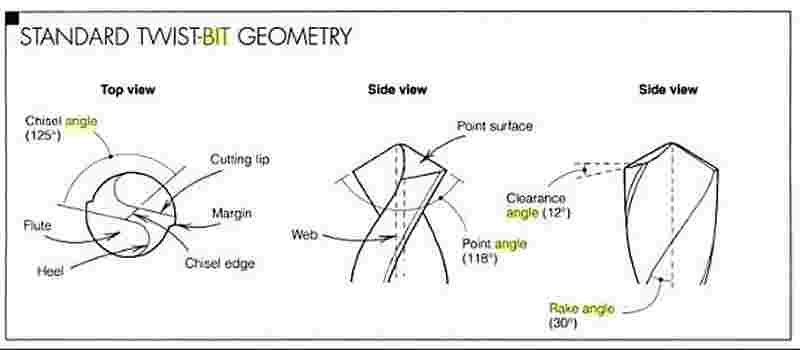

  7. I understood the snatching bit... it was the negative rake angle I needed clarification on... I dont do drills - when they get blunt I replace them, when they break I replace them. I have never sharpened a drill or taken a grinder to one.. but I found this description helpful. A picture paints a thousand words and eventually found one that mentions drill and rake angle in the same sentence... but I am still not clear what it should look like when I am done.. or how I am going to do this on a 2.5mm drill... I suppose the die grinder held in the vice and a small wheel as my big griinder is...too big!

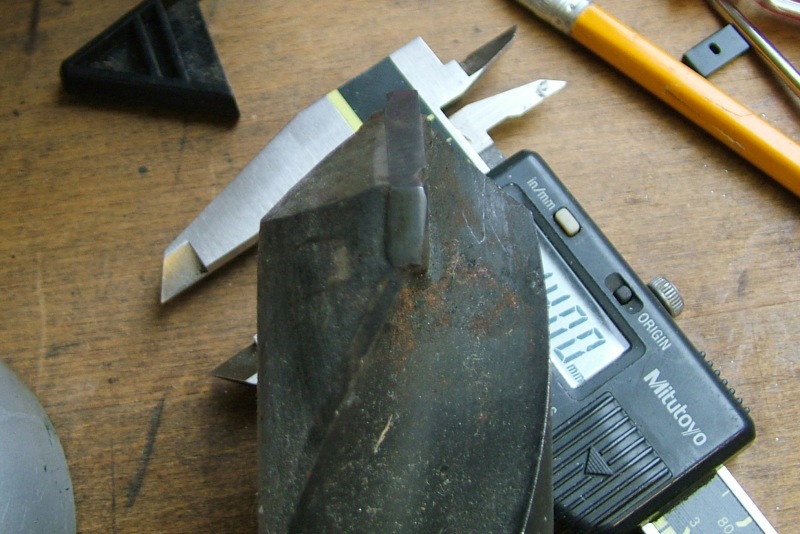

    Here is a 1.5" drill with a 90 degree rake angle
    You could do it with a diamond hone easy peasy
    Edit: From your picture that would be a 0 degree rake. I'd call it a 90 but they're probably right :heehee:

    You just need to remove the sharp cutting edge, use oil stone or diamond file.
    Only problem then is they are not much use for steel!
    Mind you if you keep breaking them you will have enough for a separate brass set.
