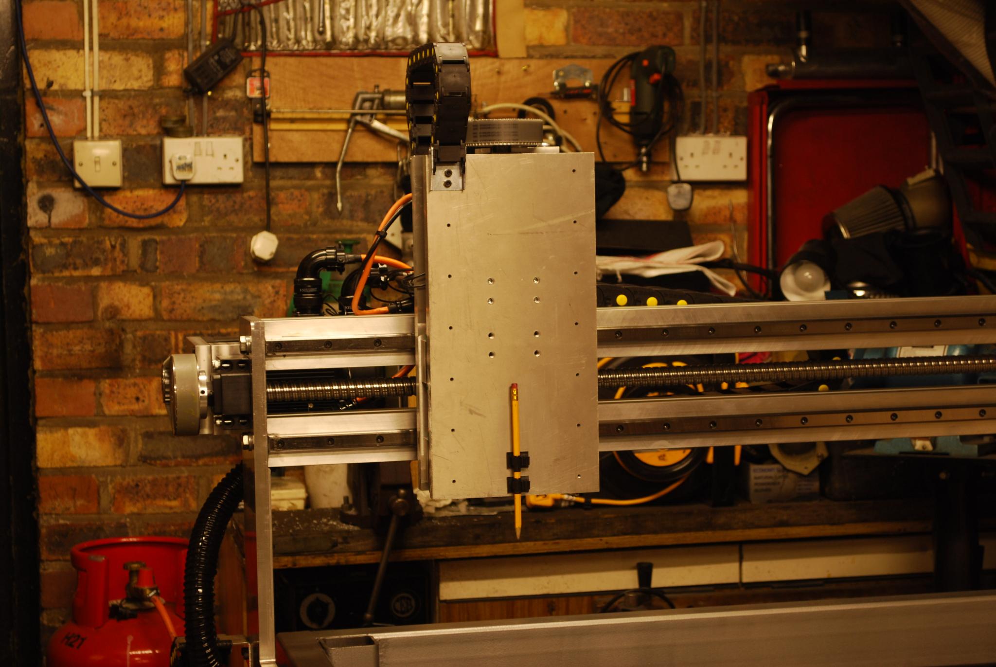

    Thanks Ross. The brackets work really well, its surprisingly stiff without them, i put them for extra support, if you hold one side and move the opposite side with considerable force it flexes about 2mm thats until you attach the to ball screws then nothing moves. im also going to add extra side supports to reduce side ways deflection.
    Wheres the best place to get energy chain from? E-bay or is there anywhere cheap in the UK?
    Best place i've seen for energy chain is to make your own, gives you that satisfied feeling.
    Great build thread, those rails and carriages for the Z axis must have been a few bob, having the benefit of work lined up even before the machine is built and having some machinery to help you along the way is certainly a bonus - now wheres that envious smiley when you want it .....
  2. The bearings and rails cost, well off the top of my head £800 they are made by hiwin and the rail is 20mm (X, Y & Z), having work waiting for me is is what spurred me on to make a half decent machine in the first place.

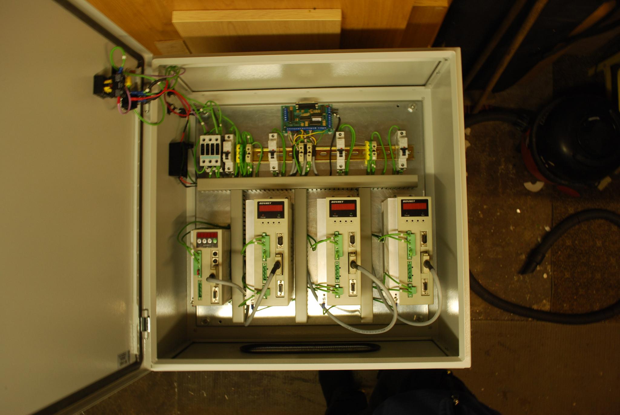

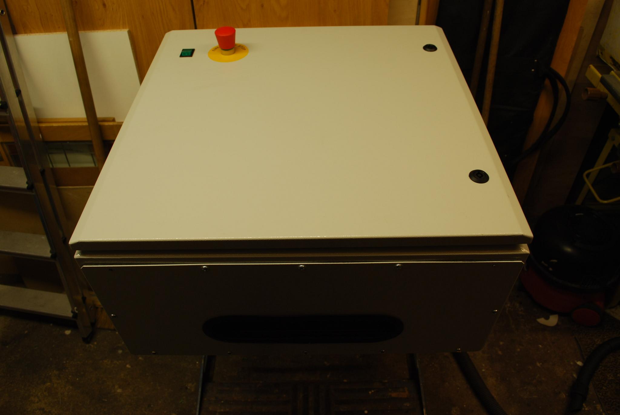

  6. Well, Thanks to irving for the technical help ive manage to finish the drive enclosure. just got wait for the data cable come and ill try and get some life out of the motors.

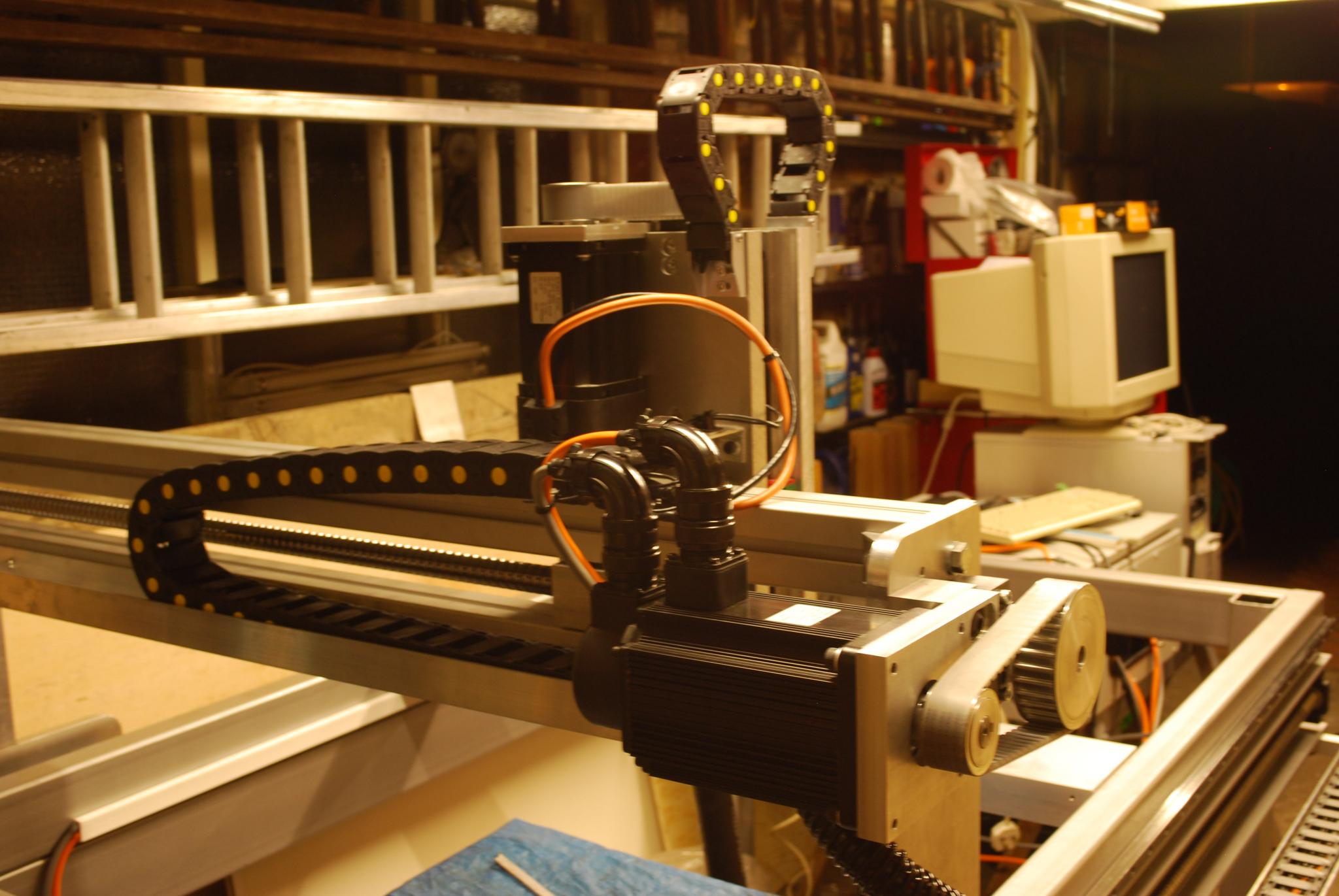

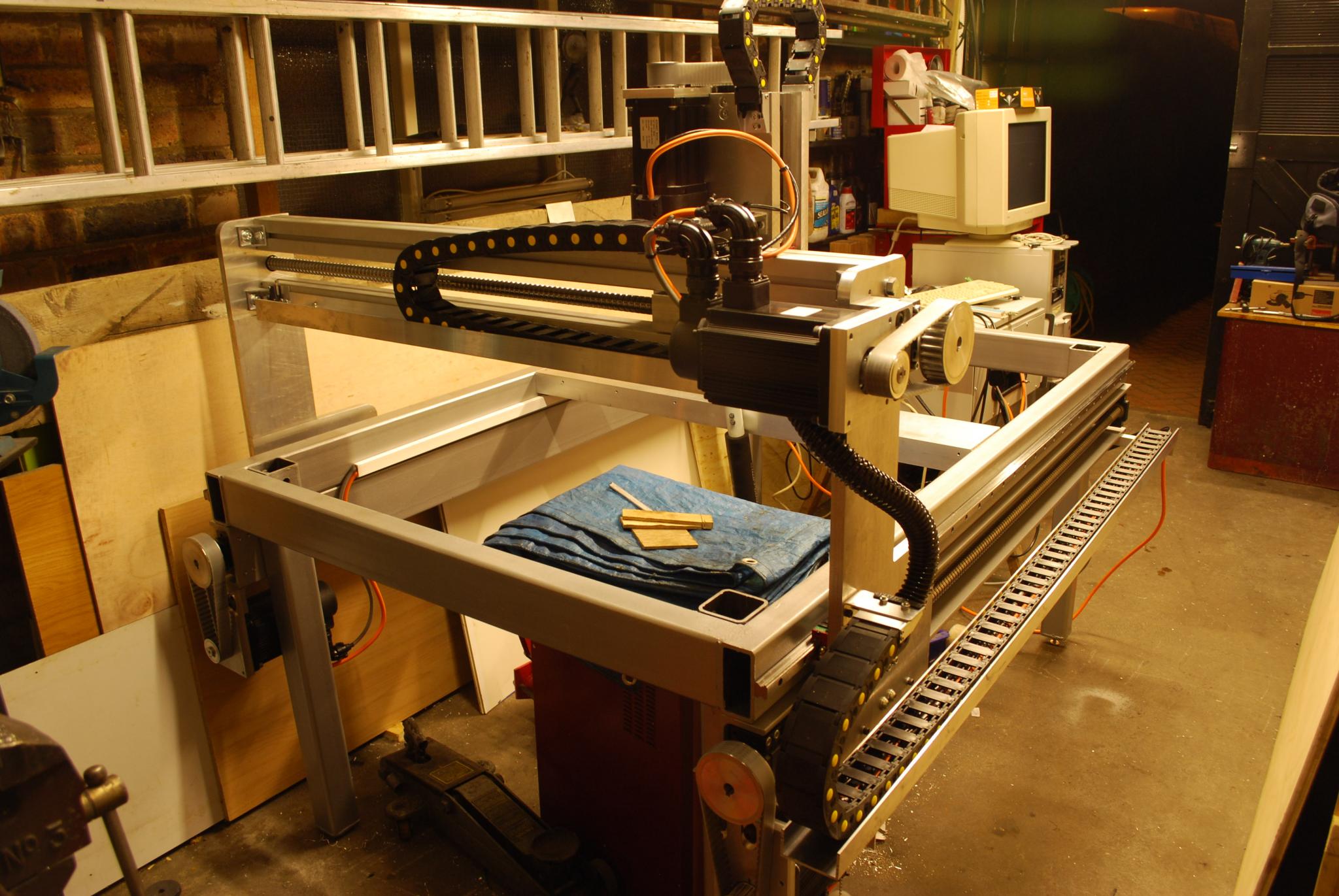

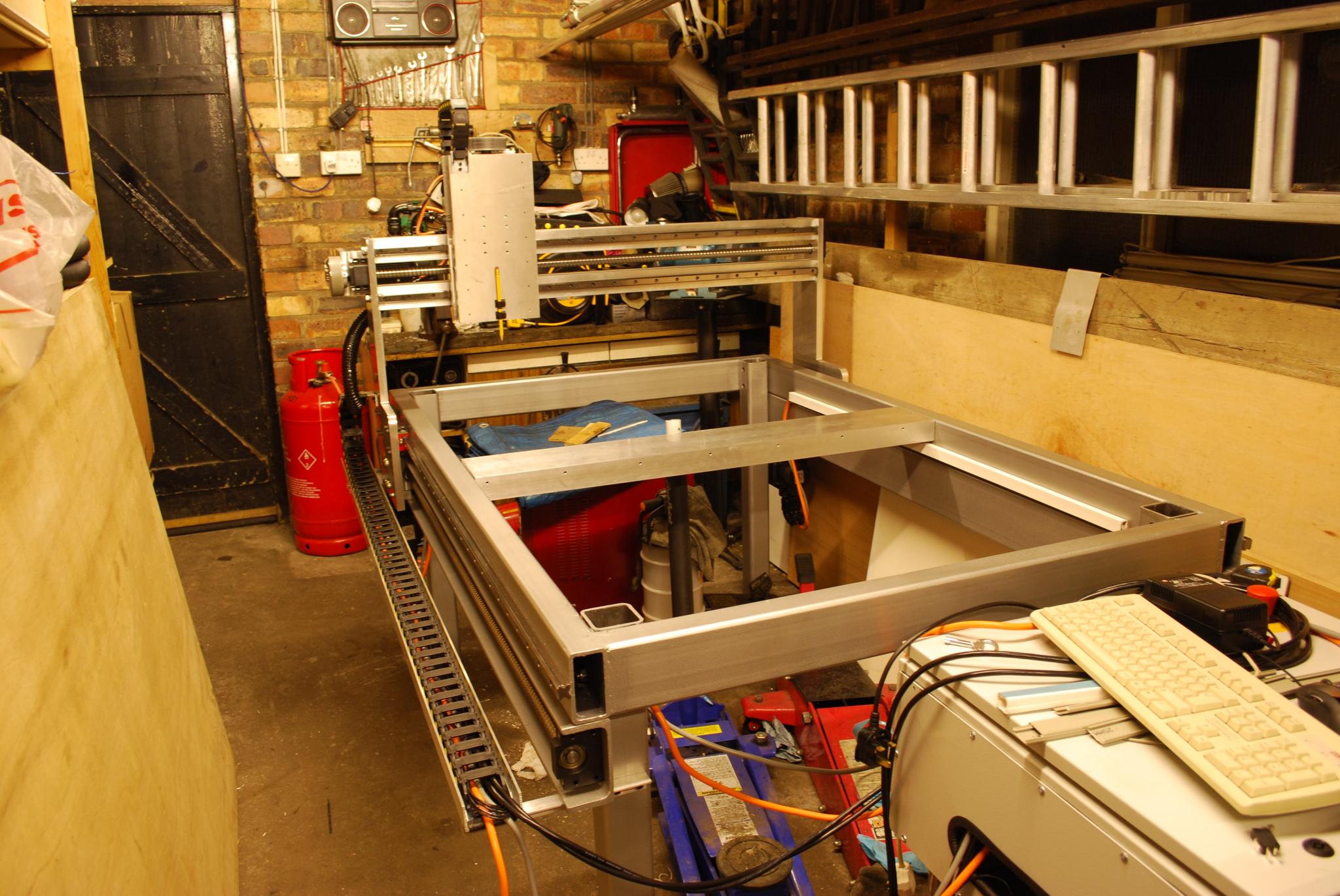

  7. Just a few more photos, as you can see ive mounted the energy chain and ive also mounted my limit switches.
    Just need a smooth stepper board now to get some good rapids.
    Enjoy.
