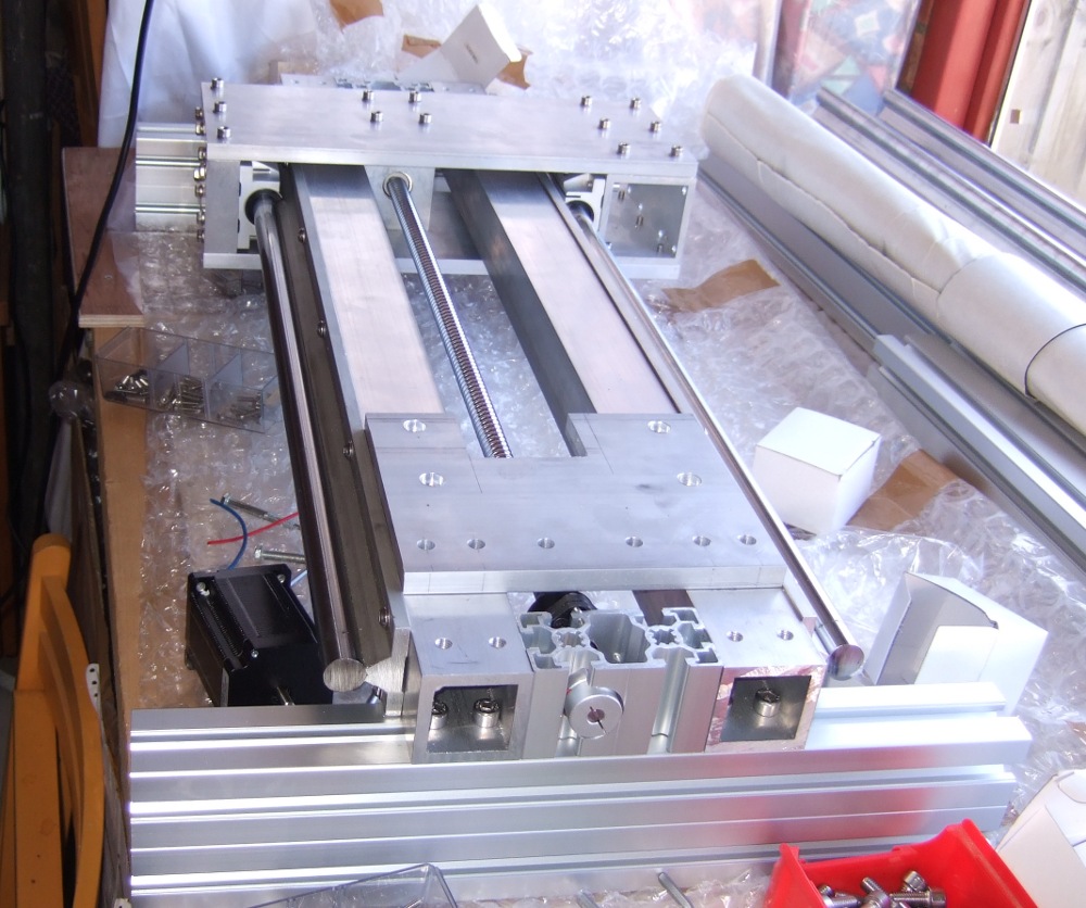

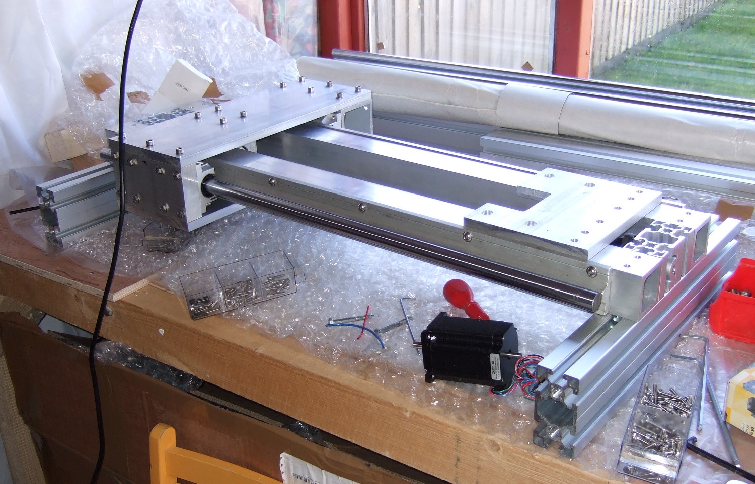

  1. I have started building my router. The plan is that it will be a Kress (at least to start with) based 3-axis job with a cutting area of about 900mm x 600mm x ~220mm. I am attempting to over engineer so that it should be able to cope with aluminium, and be as flexible as possible.
    The design involves two steppers and ballscrews on the X-axis so that I can unbolt some of the baseplate and put large objects (and flat objects on their side) into the router through a hole in the table.
    The X and Y are on 20mm supported rail, and my plan is to use 20mm unsupported rail for the Z axis.
    So far I have bought a scary amount of aluminium and other stuff and built some of it into a Y axis gantry - the photos are looking at the back of the Y axis

  4. It is very much out of my head, the plan tends to change quite radically up until I actually start cutting metal - it is more fun this way. And as soon as I actually see a part I immediately think of a better way of doing the next step.
    I am not entirely sure of the stiffness of the 50mm square Al beam with the supported rail on top, but it probably isn't bad. I think a bigger problem is fighting it turning into a parallelogram which is why I made the plate which is sitting on the top in the photo. If I started again I would have made one of the Square Al beams 5 inches longer so I could put a good triangular cross bracing plate overhanging the end.

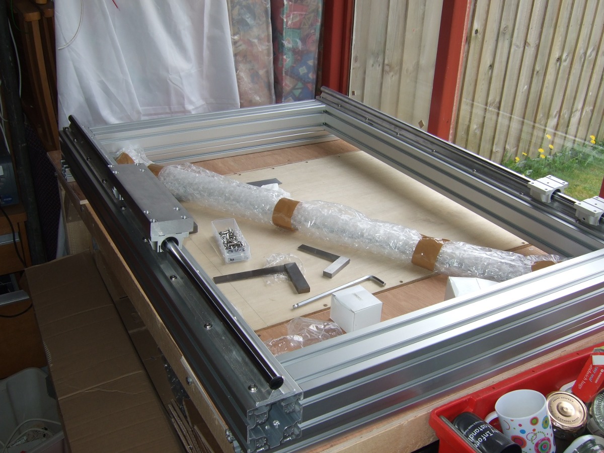

  8. Have finally managed to do something to the router, and set up the base. Though quite how drilling 16 holes in the profile took most of a weekend, I am not sure...
    At some time soon I am going to have to build some form of flying motor support cantilevered out over the rails... It seemed like a good idea at the time
