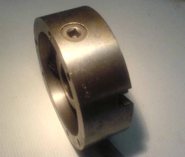

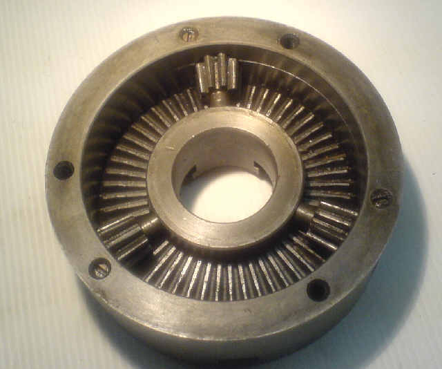

  4. You could probably knock up one of those Dorian adjustable rings from a cheap chuck - i.e. bore out the middle of the chuck to the scroll bore diameter. Face off the access material from the front and back. Grind down the jaws and drill them for the jaw locking pins. :)
