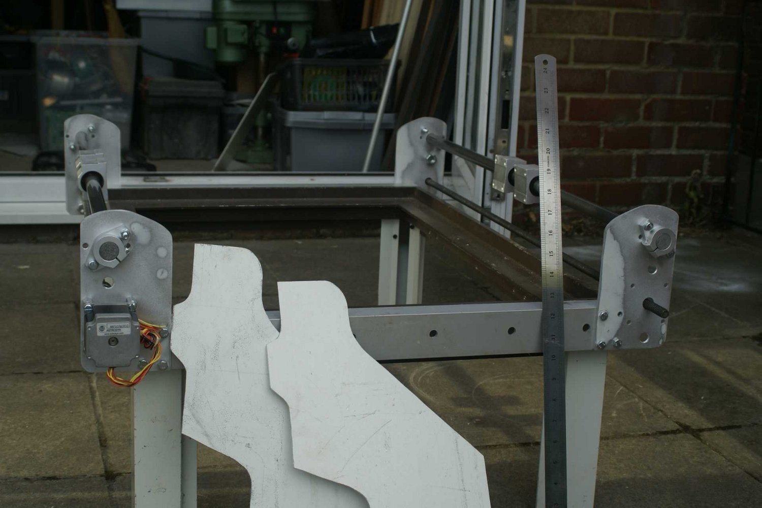

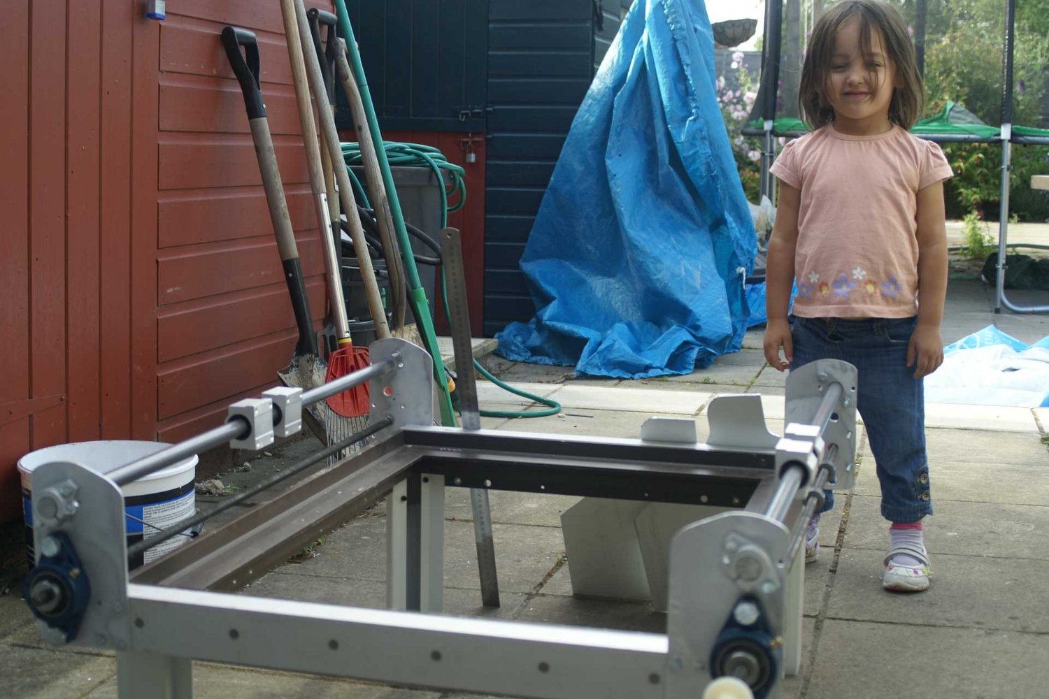

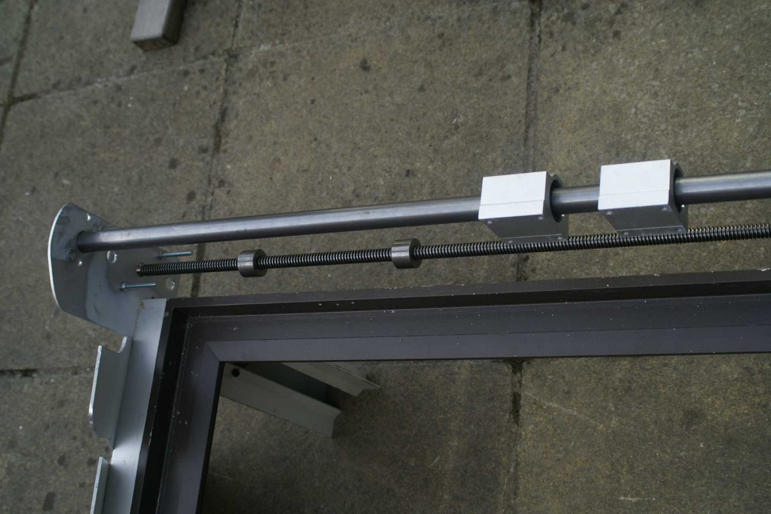

    I meant to do a plan for this thing but after reading over and over again decided to just get on with it. i went to a salvager to see if i could pick up some ali sheet and came away with everything. The base was built with what i believe to be a an old frame from a machine of some sort. It is acentially a window frame blank and was close to my size i wanted. i had some 'T' slot from him as well.
    this weekend so far i built up the X and started the Y. I hope to get some pics up soon.

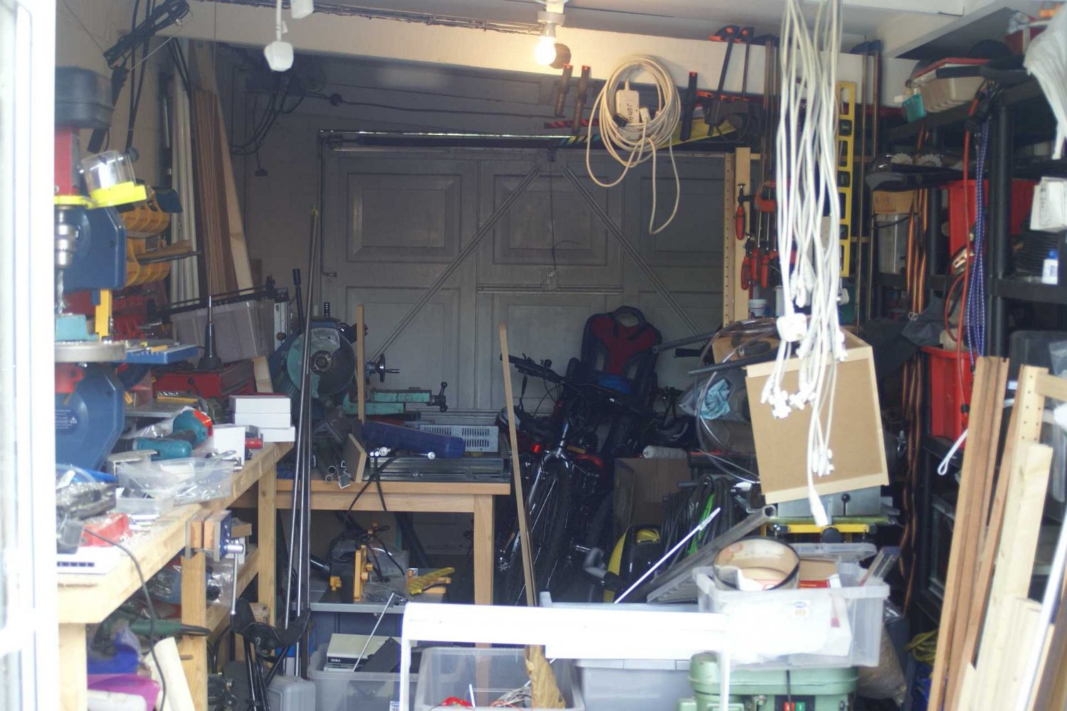

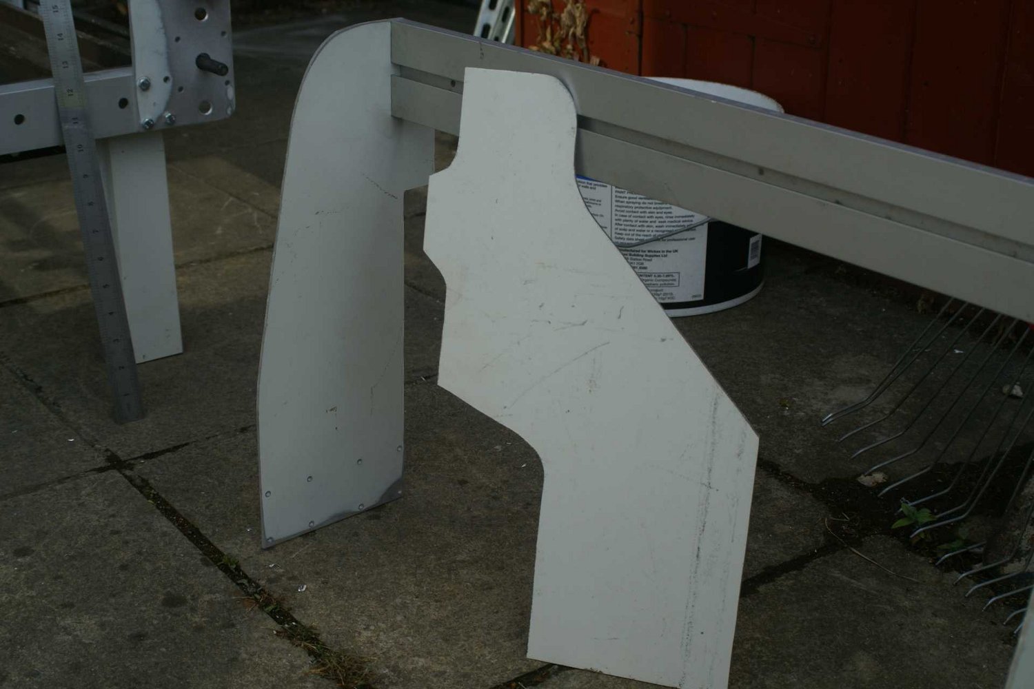

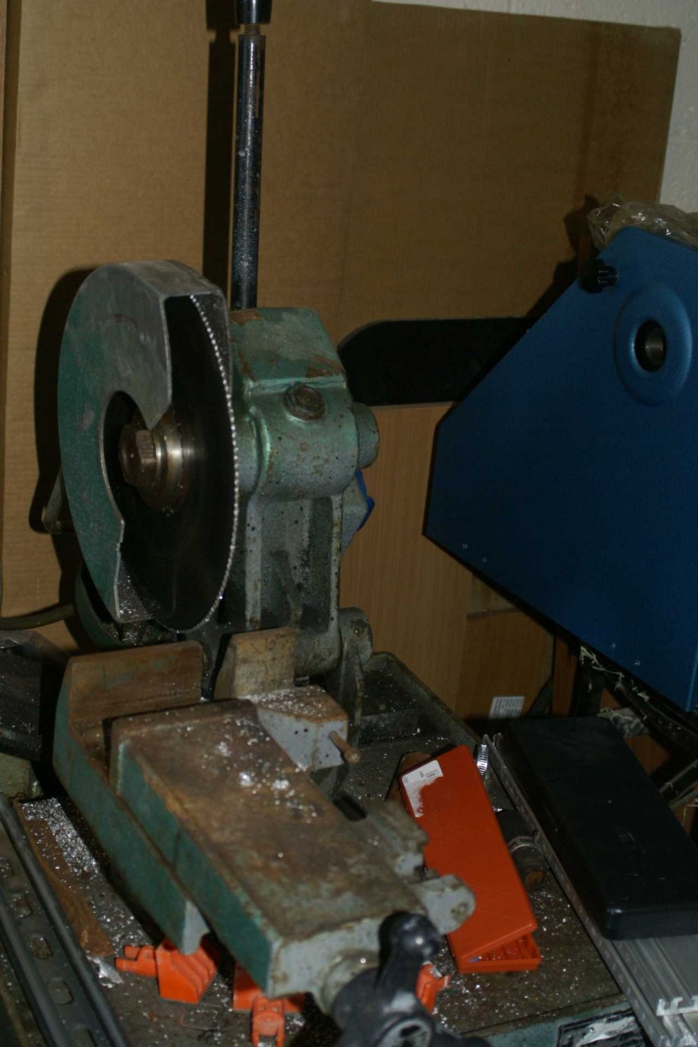

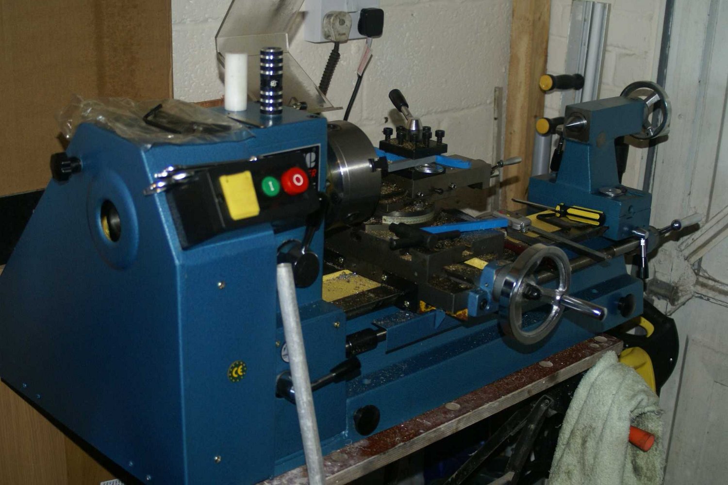

    As promised - some pics of it so far and some of my favorite toys. The gantry sides for Y i cut again after doing some measuring (this helps). The best toy in the shop is the metal chop saw, it has one huge motor for a nice slow torquey cut. By the way they say never work with kids and animals.

    that was in the plan until i fitted what i had then decided against it. It is a lot sturdier than it looks. i might beef up the gantry sides with an mdf skeleton doubler?
