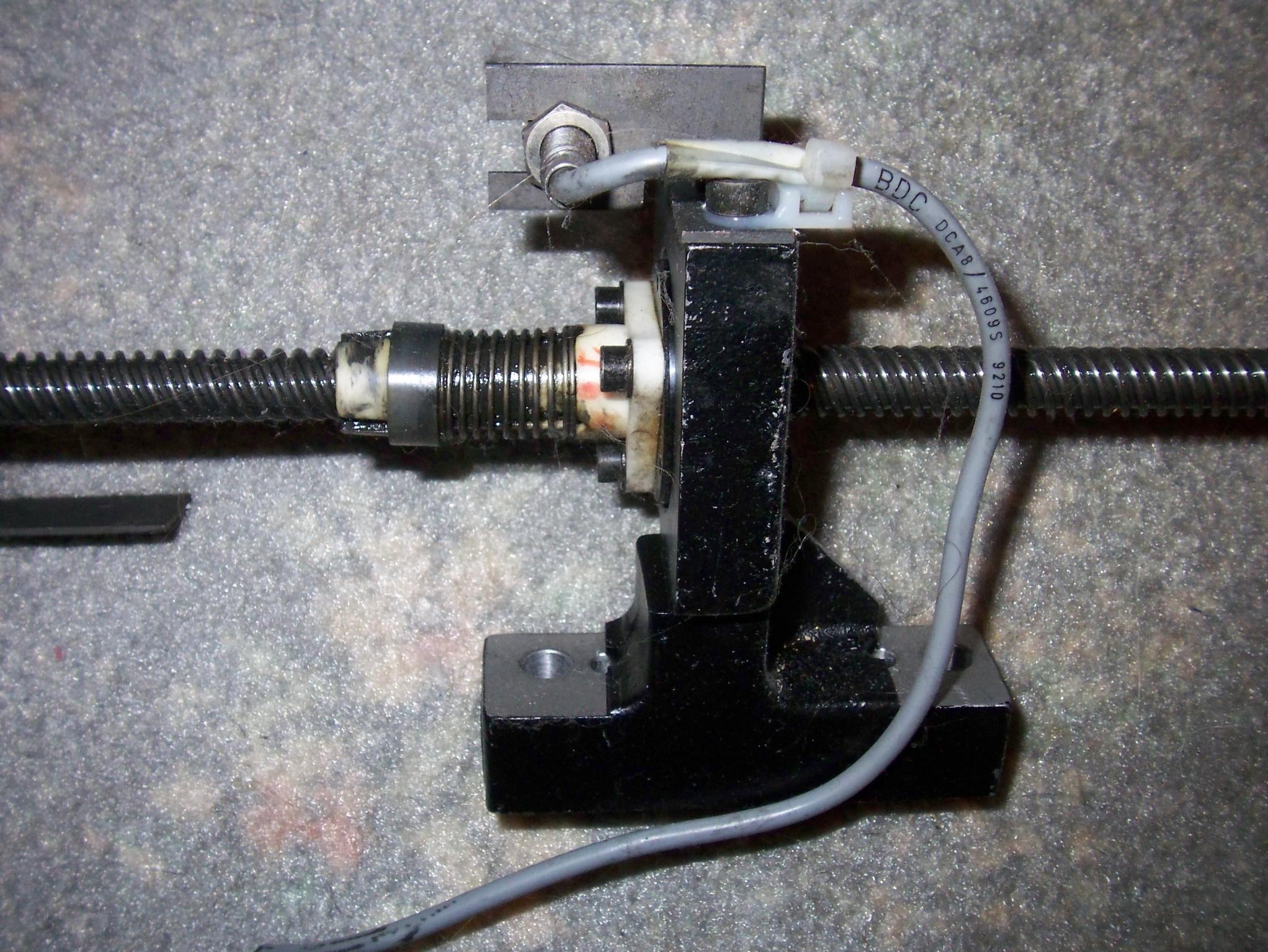

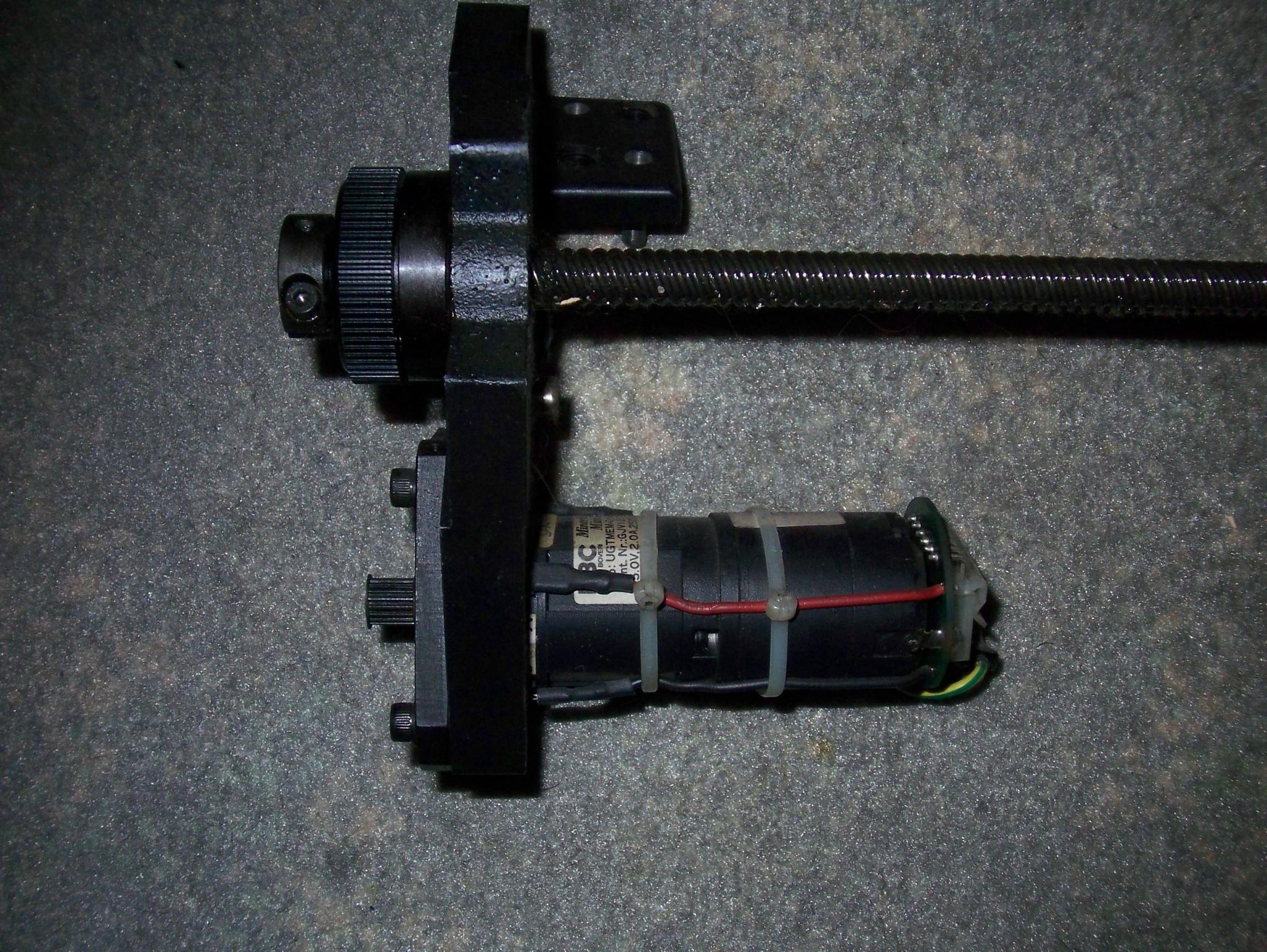

    Basically I've separated those white leadscrew nuts pictured above (there were three small hex head bolts holding them to their mounts) ...my tack here was to source a rectangular piece of 'mount' material deep enough for the leadscrew nuts to insert into (about 30mm deep....and because I didn't have any acrylic that deep, I've glued some sheets together...transparent arylic about 20mm thick & two pieces of blue acrylic sheet about 5mm thick! Very blue peter-esque!) .
    The leadscrew nut 'extended' bit is 20mm diameter so it's just a matter of boring a 20mm hole through the middle of the acrylic & then attaching the the lot to the underside of each plane's table.
    Sounds awful & I'm sure not up to anything other than hobby standards....but have you seen the price of proper nut mounts
