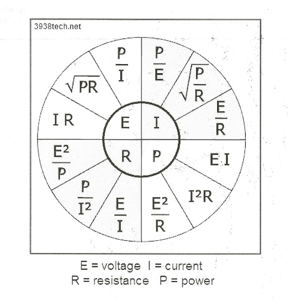

    So how do you express Ohms law in first principles ?
    John S -

    Ohms law states that the current through a conductor between two points is directly proportional to the potential difference (PD) or voltage across the two points, and inversely proportional to the resistance between them .
Name:	ohms law wheel.jpg
