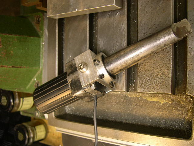

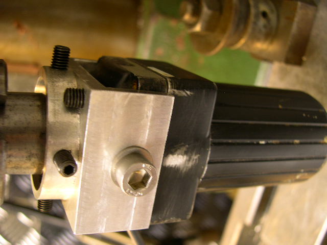

    Before starting on the Z axis, I needed to address the issue of positioning the work-piece accurately on the table.
    I have to make an upper and lower bearing block for the Z axis ballscrew and cannot mount them together to machine them.
    I watched ebay for a touch probe, but with digitising in mind, I decided to go the webcam route (also a lot cheaper).:heehee:
    I bought a 1.3Mpixel camera and mounted it in a defunct waterproof cctv camera housing. This has two advantages, the cctv cam. has a C mount zoom lens with an iris control and is of course impervious to swarf and coolant etc.
    I made an adjustable mount so that it can be aligned accurately.
    After two failed attempts at making a magnetically coupled quick release, I ended up mounting directly to a 3 morse sleeve which I ground a groove into, so that the grub screws which adjust the x and y, also pull the mount to the sleeve.
    I am very happy with this, not very pretty (as always!) , but very solid.
    I have checked its accuracy many times now and it is always spot-on.
    I will be adding a laser at 45deg. to give an accurate height later, an idea I stole from a professional CNC camera costing $650 !
    This will enable the camera to be used to measure distances, holes and angles.
    Also in the future I intend to use some software to scan an object and create a point cloud for digitising.

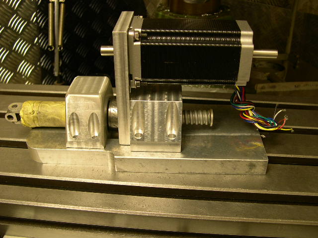

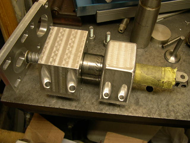

    Ok so now I can get my work-piece accurately positioned, I made the upper and lower bearing blocks, which house the needle roller bearings for the rotating ballnut.
    Ah!, having milled the bearing pockets, I checked the bores and was happy (0.01mm undersize), BUT, I measured the bore at the top and when I tried to fit the bearings.... nogo.:cry:
    As Robin alluded to previously, the milling cutter shies away from the work, so my bores were both tapered! ..... bugger.
    Spent about two hours with a 1" milling cutter in hand, scrapping the bore to make it parallel... what a pain!
    I had used a 1/2" cutter, and ran the code 3 times on the final cut!?
    I guess a different method is required next time.
    The upper block also houses the two thrust roller bearings and this is closed by a plate, which is also the motor mount.
    The bearing blocks mount into a 19mm plate which will attach to the front face of the head. They mount “into” the plate so that the ballscrew is as close to the spindle as possible.

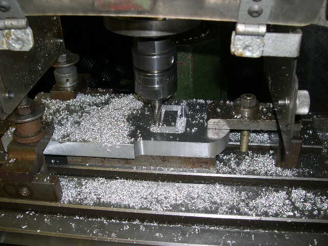

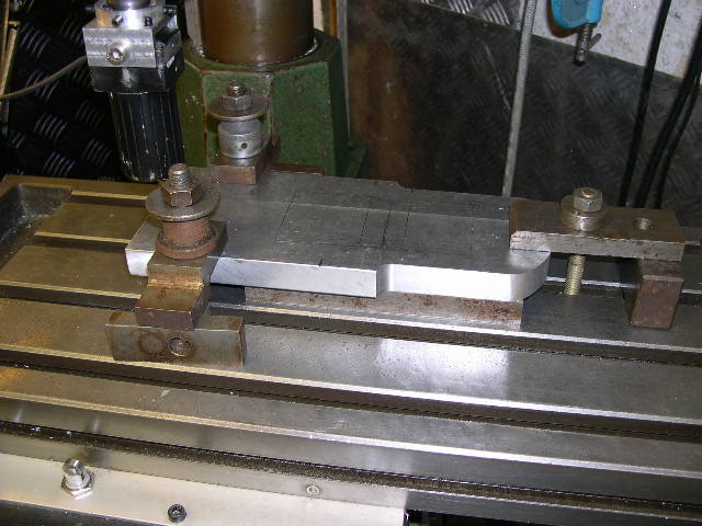

    Next I cut the plate, and for the first time clamped the work to the bed.
    What a difference! (thanks Robin).
    The cuts where sooo much better, cleaner, faster and so much quieter.
    And I still have more overhang to remove as I am still using a collet chuck (no metric tools yet for the 3 morse collets).
    I was really happy for a few seconds, them I realised that this has severe consequences for my planned 4th & 5th axis, something I guess a lot of you already knew.
    Maybe it will work OK with small cutters running at high speed, I will have to wait to find out.
    Amazingly the blocks fit snugly and the shaft is in alignment!:surprised:
    Next job is to modify a timing pulley to fit over the 37mm barrel of the ballnut, and then cut the depth stop lug off the front of the machine, and fit the assembly to the machine.

  7. #37
    Quote Originally Posted by Tweaky View Post
    If you want accuracy it is best not to buy your cutters purely on price :whistling:
    Once they start to rub, rather than cut, you can repeat until Doomsday without removing the excess.
    If the taper is more pronounced in X it's probably column flex. To flex in Y means bending the column, to flex in X the column acts more like a torsion spring.
    Put a dti on it and see how hard you have to lean on the chuck to get problematical movement.
    If the taper is even it could be a sloppy quill, does the dti reveal more flexing as the quill extends downwards?
    Lots of lube helps keep tooling sharp.
    Robin
