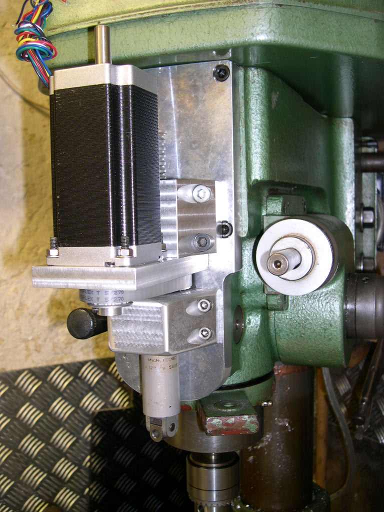

    Made blocks for the nuts, used the original bearing blocks and used a pair of angular contact bearings on each ballscrew, with the opposite end floating.

    The motor mounts
Name:	Motor mount2 sm.JPG
ID:	1725 Click image for larger version.
Name:	Motor mount3 sm.JPG

    Having mounted the motors, I was keen to try it out, so I connected the motors to the driver 36v 11a PSU at min voltage of 32v and hey presto!
