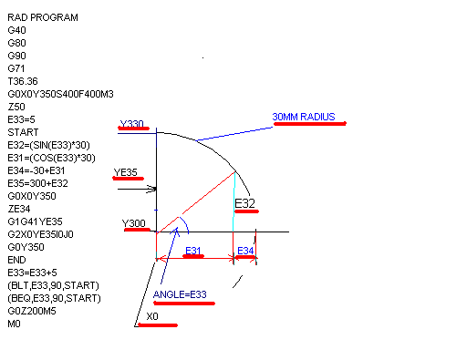

    i was wondering if any body had any parametric formula for squares on a bolt hole circle ive included one of a 30rad on a 300 dia
    Not sure what the question is? you have the parametric formula for a circle, surley you just need to add the g-code for a square at each interval no?
