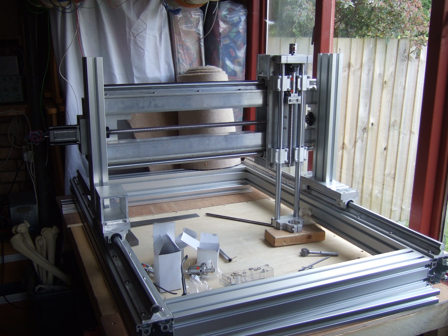

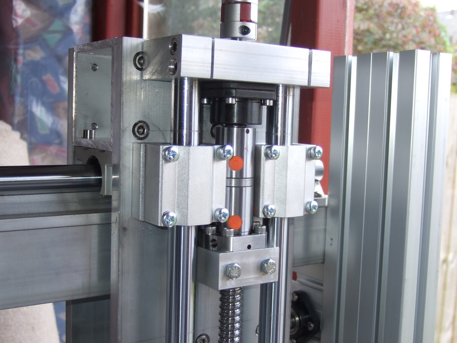

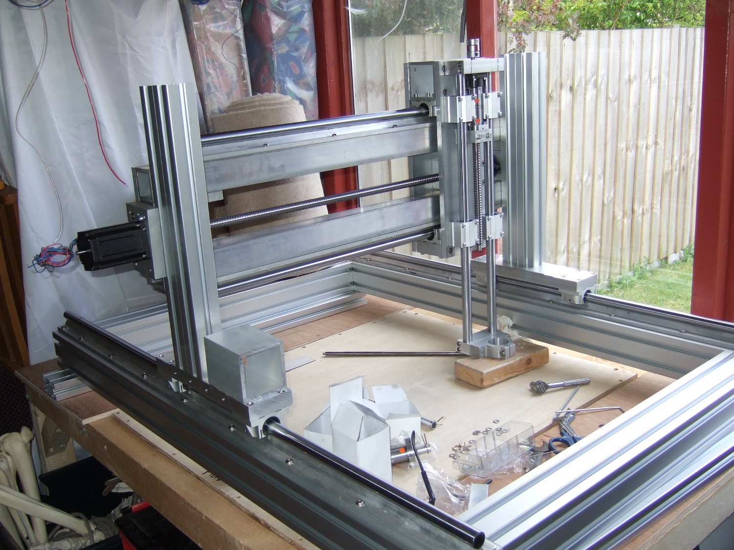

  5. I seem to actually be getting somewhere after last weekend.
    I have mounted the Y axis on the X-axis rails, and built a Z-axis minus a motor mount which will have to be bodged somehow.

    The z axis ballscrews are binding slightly, I think because the plastic inserts (where the balls are returned) are getting squashed by the linear bearings when I do up the bolts on the ballscrew mount. It is fine when they are loose, so for the moment I might get away with some shim under the mounting block and moving the whole ballscrew out a touch.
    I am getting to the point where I want to get the thing working, at least so I can use it to make more accurate replacement parts for itself...
    Gary is apparently sending me some replacement balls, free of charge... thankyou!
  6. If you look closely at all the unimportant bits which are just left with rough sawn edges it would possibly look less tidy. It is big and shiny though.
    Right I think I have fixed the Z-axis binding problem - it was just not aligned right - rather than adding shim I shaved a couple of mm off the ballscrew support block and it is now good.
    However it is running so smoothly compared to the Y axis, it rather indicates that there is something wrong with the Y- axis... I need weekends with less work in them.
