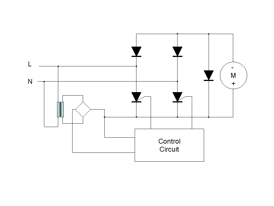

  2. I'm guessing you meant S6006L which are Teccor 6A 600v isolated tab SCR (the 6060 is a 60A device and is definitely not in a TO220 package!) and the D6020L is a 600v 20A isolated tab diode also from Teccor. Shouldnt be too hard to work out the circuit, its going to be a full-wave half controlled bridge (2 diodes, 2 SCR arranged as a bridge rectifier) the third diode is a snubber across the motor. What other parts are there on the board?

    So you have a quad comparater, probably for zero crossing detection, and a pair of quad opamps, probably acting as buffers for RC timing networks to give start up and stop acceleration/deceleration control. I am guessing the transformer is to provide some power to these and a source of isolated AC for the zero crossing detection, wonder how they drive the SCR gates. All the circuitry is operating relative to one side of the motor and floating relative to supply, unless theres a pulse transformer or opto-isolator on there and I dont see it... so be very careful when putting fingers near there...
    The picture shows an ouitline of the circuit - there are several ways to do this but it should help sketch out the main arrangement...

    Hi Irving,
    Thanks for the offer - there's some relatively hard to source electronics bits & bobs stuff I've been waiting to get from Cricklewood...so I might as well bite the bullet & get ordering from them & lob in a couple of 78l08s too - they've no minimum order, but £3 P&P (not bad & saves me having to drive over there!)
    Thanks for the basic outline diagram too.
