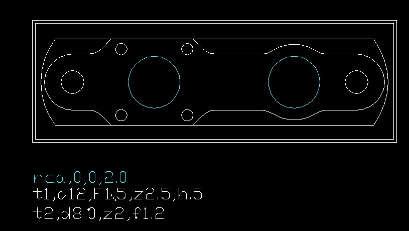

    Something of a hiatus, now going again
    This morning it started puking out G-code, read some in to my cutting software and it looks good
    After much agonising about how to define tools inside a drawing file I eventually opted for added text.
    T01 is the only tool that removes excess from the block. No T01=no excess removal. So you can go back in and tweak without massive editing of G code.
    Still Um'ing and Ah'ing about whether to allow finishing excess in the Z axis when you reach the bottom of the block. I think probably not, total waste of time.
    The RCA text line in the pic forces a 2 degree draft angle on anything with the same layer. Will probably add other modifiers to that.
    More soon, probably. I can still come horribly unstuck, but looks hopeful. The proof of the pudding will be in the eating :heehee:

  5. Robin,
    Rather than regen the cut, could you just store the vertexes and re-display them? (There must be some PD 3D C++ libraries available on the web somewhere that would do this kind of thing for you)
    Bill
  6. #16
    Hi Bill
    What's a vertex? :heehee:
    There is no cleverness in this program, it simply reads in a dxf, slices through at various levels then projects the slices in to cuts. That was about all my brane could handle.
    Robin
