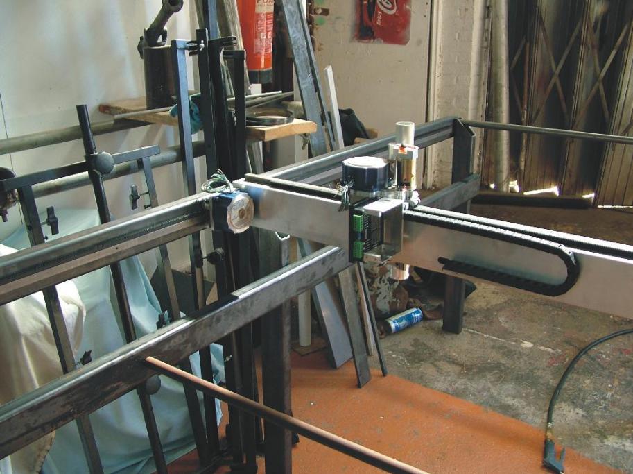

    Making a plasma cutter table. Bit skeletal at the moment but slowly coming together.

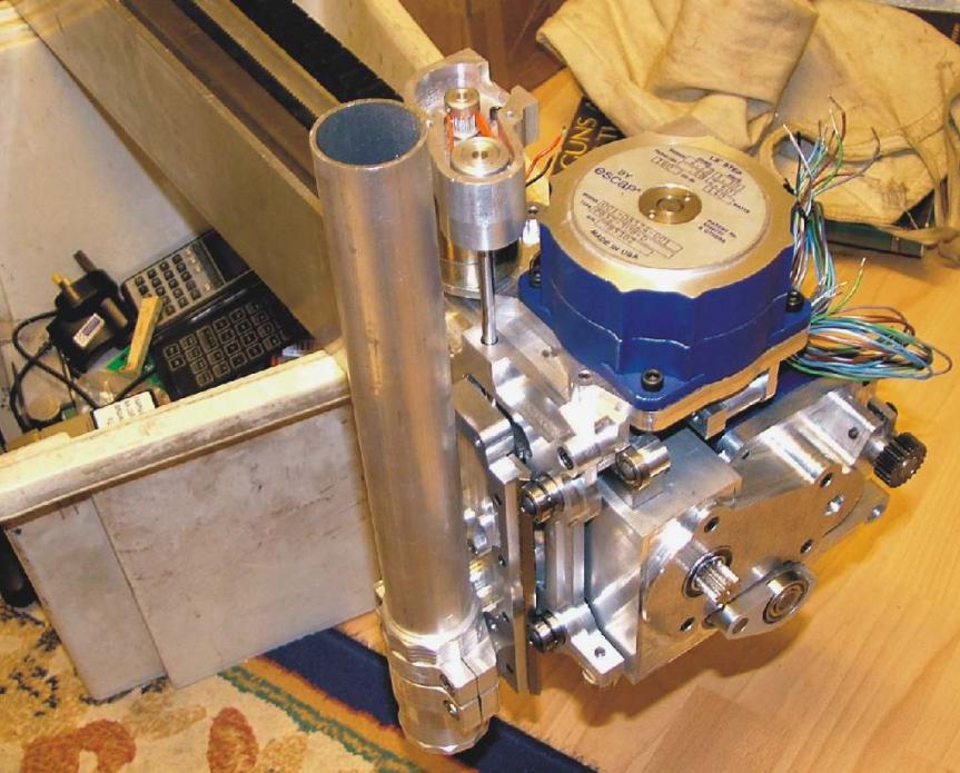

    1 MOD racks and steppers for the X and Y, 3mm screw and DC motor for the Z.
    Hope to get it moving soon, see how she goes, run her in for a bit. Problems with the pinch roller on the Y axis which stops the torch tilting, think it needs a fatter spring. Needs attention to the fixed rollers on the Z, something isn't quite parralel there :D
    Haven't done the X axis guide rail yet, will post updates...

    Do I spy R&P? be sure to post where you got it from ;)
    HPC Gears for the pinions, Huco for the racks.

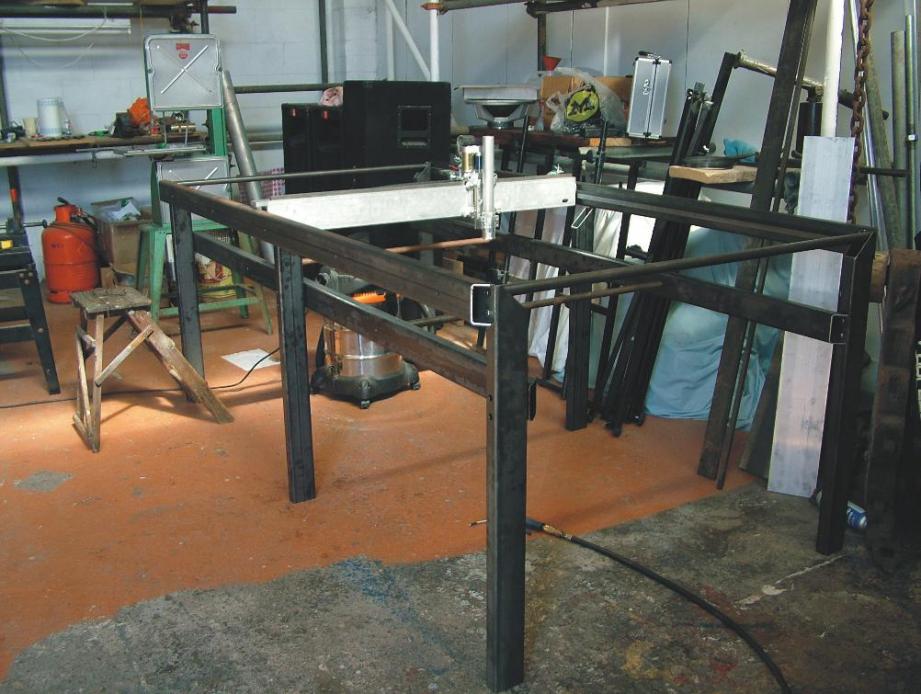

    Plasma cutters usually come in different sizes for the two standard sheets. This is the smaller one :D
    Today I want to connect the pinions at either end of the gantry with a common axle so it runs square. Be interesting to see what kind of accelerations I can get.
    Looking good Robin, how much will a Plasma Cutter like that set us back ? Also is there a reson why you have mounted the driver so close?
    No idea what it cost, probably best if I don't work it out :D
    Chopper drivers don't particularly enjoy long leads, plus they could interfere with the signal lines next to them in the chain link trunking.

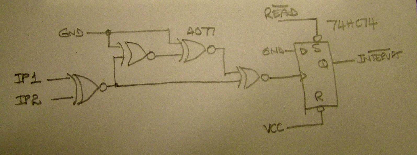

    Bit of a delay designing the circuitry. Decided the best place for the CPU was at the cutting head. Close connects for the Y and Z axis controls and switches. Reasonably close connects for the X axis stepper controls and end stop.
    Decided to use fibre optic links for the computer connection so I don't have to worrry about interference from the torch.
    The Z axis is screw driven by a zippy 24 volt DC motor with brake and 4 bit control on the speed.
    The motor has a chopper disc to show where it is.. Rather than waste cpu time oversampling to read the chopper I decided to put it on an interrupt. Here's my cicuit. If either chopper optic changes the the cpu interrupt goes low until I read the data on the input pins.
    I'll let you know if it works

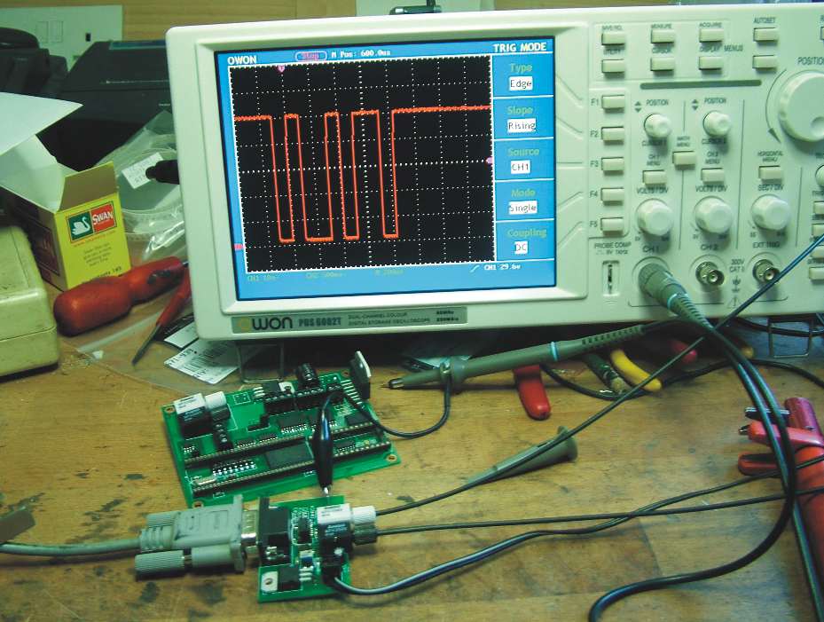

    Circuits done, pcb's made, thought I'd start with the fibre optic link because I've never done one of those before :D
    Set up a full duplex terminal so anything I typed on the keyboard had to go out around 5 metres of cable as light before it showed on the screen. Worked a treat.
    That's a letter 'i' on the 'scope, on it's way back from the optic at 9600 baud. Can't ask for cleaner than that.
    Now I know I can upload programs for testin', next comes some steppin' :D
