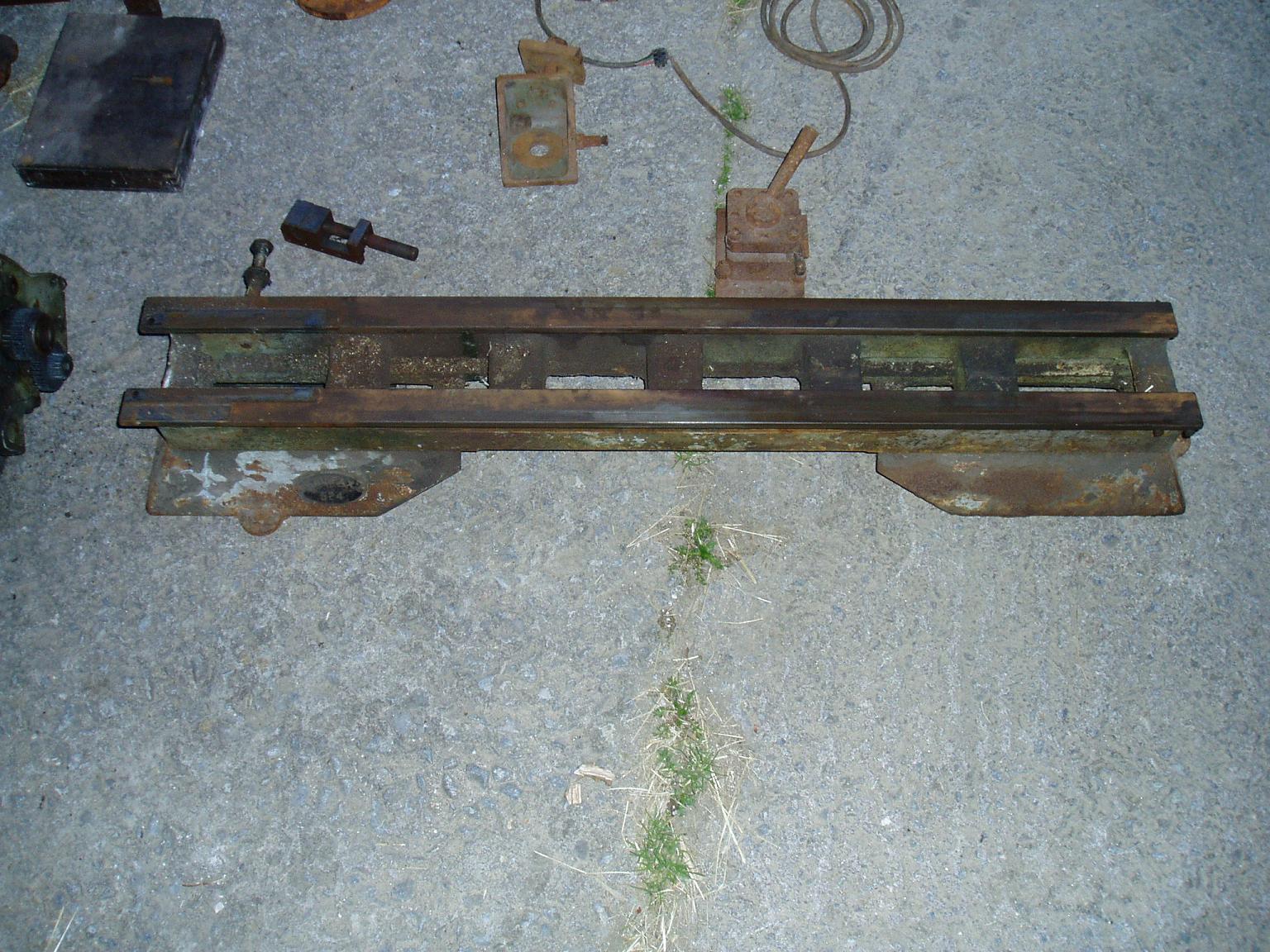

    Techincaly its not an Atlas but the Uk version badged Halifax. I've looked at John Stevensons site and it appears that the beds should be the same and its only the carriage that is different.
    So I will need some advice on the best way to get it milled or reground if you have the time please.

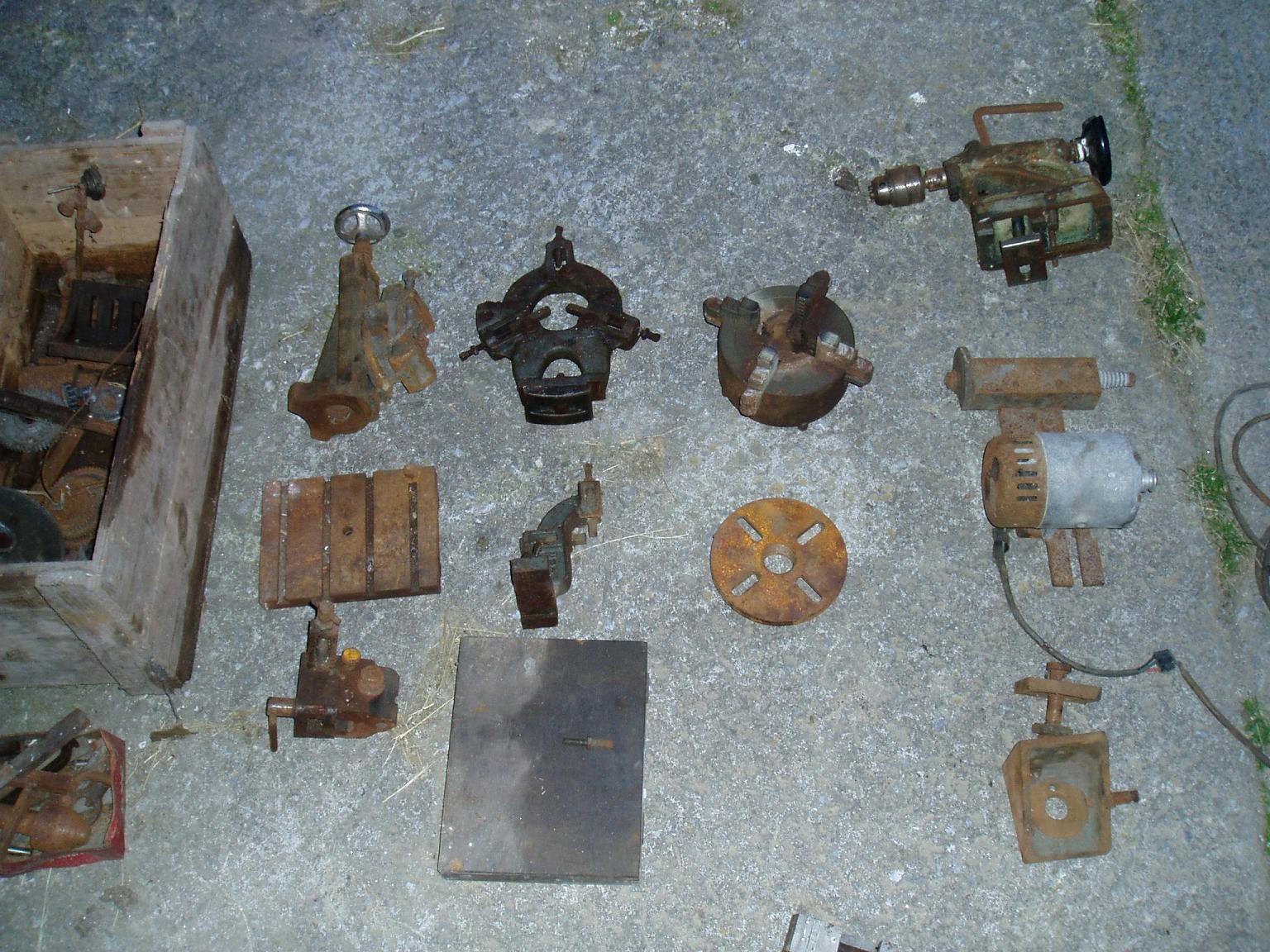

    Ok so I'm spoiled for choice now as I have just bought a complete Halifax 524 with lots of accessories.Its was just down the road and a bargin at £120. It came with a 6" 4 jaw chuck, Milling attachment, tool post grinder, fixed and traveling steadies and the best bit is the replacement tee slot table for the cross feed.
    The carridge is definatly better than the Atlas as the dove tails are bigger but there are so many broken bits that I will have to rob them from the atlas. The levers and wheels on the atlas are much more substancial and I'm not sure about the plastic pullies either.
    So now I'm not sure wether I should rebuild this to original spec as its "British" (well almost) or wether to combine the best bits form both and create the B*****D chilld of Mr Atlas and Miss Halifax to create a good working lathe??????

  4. #24
    Ross,
    You now have the makings of a machine that will give you a lifetime of use. Forget about getting it back to original, there is very little intrinsic value in doing so, just concentrate on getting the best lathe you can out of the two.
    All you really need to worry about at this stage are the centre heights of the head and tailstock. Choose which is the better of the two matched pairs, say one has a plain head and one has a roller, go for the roller, if they are both roller heads, go for the one which is the smoothest. If they have been left for any length of time in a pre loaded state, they will be very 'ratchety'. A new pair of bearings will require a remortgage of your house, unless you are lucky as I was, and got a friend to regrind the special outside races for me.
    Clean off the new old bed with scotchbright and oil, that should clean things up rather well. Measure it up around the high wear areas, normally from the chuck mount to about 6" towards the tailstock, a thou or two should be OK, anything over that and you really need to get the top refaced. Only then see how the matched pair fit to the bed. you might have to do a little realigning of the head and tailstock, a fairly easy job, Once you have that done, concentrate on the saddle, leadscrew and gear areas.
    Once you have the bits on the machine you want, and they are running together well, then start to rob the leftover pieces for better looking or replacement parts.
    Once that stage is reached, you can start to get it fine tuned and modded to make it an exceptional lathe.
    It looks like you have got all the attachments you will ever need, especially the rocking horse travelling steady, and the toolpost grinder, if it is any good. If I was you, I would empty the wooden box all the bits came in, and put it on a sheet of plastic (a bin bag), line it out with newspaper, put all the siezed and rusty bits into it (not electric motors), then dribble over the whole lot with some cheap engine oil, put newspapers over the top of that and pour some oil onto that as well. After a week in there, the parts should be ready to clean off and work on.
    John
  5. #25
    Thanks Bogs,
    Glad to see you back. I wanted to make one good lathe lathe out of them but didnt know if it was ethically viable.......after all it should work to its best eh.
    I'm glad all this stuff is slowly sinking in as i have only cleaned it with oil an scotchbrite. The problem is that when I put the straight edge across the ways there are no ridges or wear grooves but when I put it longatudinally there is a small dip in the bed, is this a sagging belly or just thefact that there is no other bits causing moments or stesses in it?
    They are both taper bearing head stocks and seem very smooth. the Halifax one has the removable half bearing straps on the spindle like a crankshaft. Is this better or structurally weaker? also on the halifax the plastic pullies have worn and move lateraly on the shaft. are they inter changable or are they best left as is?
    Since there is so much that needs concidering perhaps it is best if i start with the leveling the bed? I plan to mount it on the Atlas legs and I have an engineering level to check it but should I be testing the bed or the Carridge?
