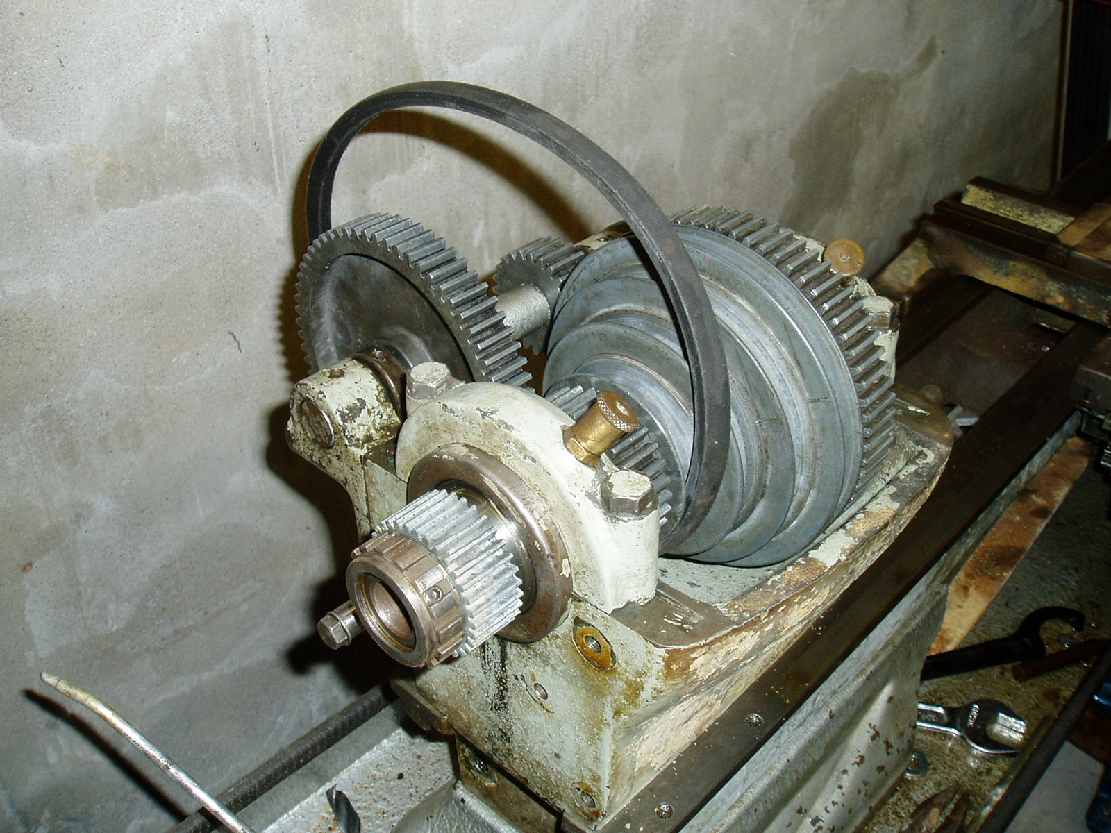

I've finally got around to looking at this again, welded up a frame, bolted it all down and leveled it up so its now rock solid, but I'm stuck on removing the spindle from the Atlas fixed headstock to rob the metal pulleys. The split caps on the Halifax were a doddle compared to this.
Ive looked at the 'atlas press' guide online and it makes it sound so easy...
I just cant get enough clearance between the main pulley and the bearing housing to remove the woodruff key so the main shaft can slide out.
And I'm completely lost with disassembling the backgear from the eccentric cam...Anyway I'm sure there is some clever person on here that knows :whistling:

I have done the spindle removal many times, and there is a definite knack to it.
It is very tight indeed, and the first thing you need to to is get the bull gear back towards the change gear end as much as possible, and the spindle as far forwards as it will go.
Then a slight tap on the top of the key in the position shown on the sketch should rotate the key in it's half round slot. As long as where you hit is further back than the centre position of the key, this should work.

Unfortunately I couldn't get that to work as I could only see about half of the key. I have no idea how this was assembled in the first place...... I had to resort to the rather drastic solution of filling the key down so it would slide out through the oil seal/collar.
That turned out to be the easy bit as once the shafts were out it was apparent that they are different. the Atlas spindle (top) has only one step in it whereas the Halifax spindle has 3 steps
So rather than just putting the metal Atlas pulleys and gears on the Halifax spindle I had to use the Atlas spindle as well, but due to the different oil seals that meant changing the bearings as well
(although its probably a good idea to keep the rollers and shells together anyway.)
The back gear was another pain, I had to use the Halifax mounts, shaft and eccentric cams with just the Atlas gears. I probably didn't need to change it but the Atlas gears are definitely stronger and they also had the spring washers to stop it sloping around.
I think its fair to say that the Halifax isn't a direct copy of the Atlas and not all parts are interchangeable, even the bolts have a finer thread.

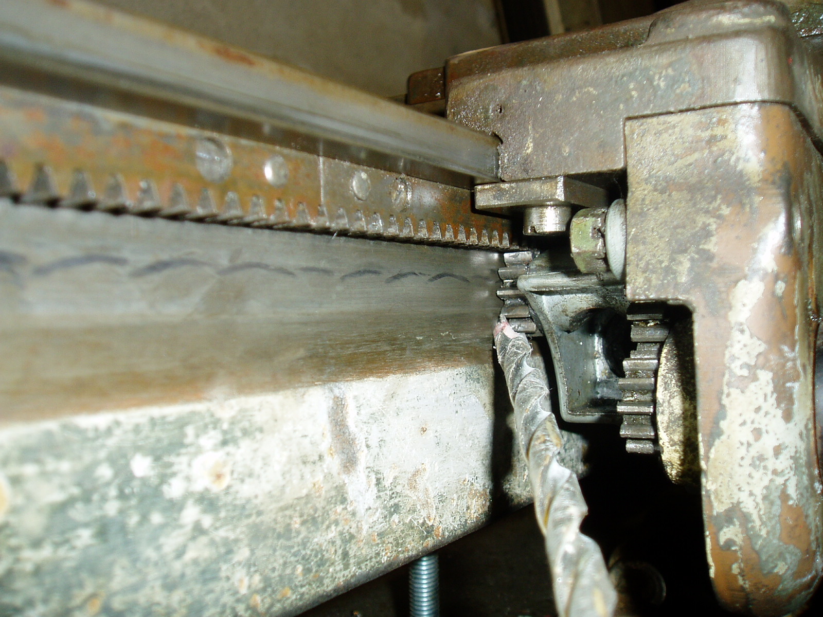

If you don't mind me pestering you (or anyone else in the know) I also have another problem that I'm not sure of the best way to resolve. on the Halifax lathe the apron drive cog and reducing bracket was broken and there is a small groove under the rack were the cog had been rubbing the bed. I have replaced it with the atlas one but when the gibbs are tightened the same thing happens and the drive goes tight and binds.
The easy solution that I can see is to put a thin piece of shim steel on the side of the way to push it over a bit,(not sure how to secure it tho). Or the better but harder option is to pocket the mounts and sink the assembly in a bit. I did think of milling the bracket down but as its made of ZAMAK I didn't want to weaken it.
Do any of those options sound feasible? or have a missed a blindingly simple alternative:heehee:

I can't really understand about what you are saying about the saddle gear and rack, but there is an adjustment cage on the back of the apron that allows for slacker or tighter engagement of the gear. There is an adjustment bolt for it just to the rear of the handwheel. that allows you to move the cage up and down. Also, you will find that if you slacken the two top apron screws, you can shim in the joint to 'kick' the apron in whatever direction is required, but you must ensure you realign the leadscrew afterwards, so that it doesn't deflect when the half nuts are engaged. That is done at both ends of the leadscrew, by shimming up and moving about the reversing box where it bolts to the bed, and the same again at the other end at the break away sacrificial support for the leadscrew.
BTW, don't ever be tempted to replace that break away bearing with anything else more solid, that is a safety feature to protect your very expensive gear castings and apron area plus leadscrew in case you ever have a massive jam up, where the saddle stops and the head carries on turning. That piece is designed to break under such circumstances, when the leadscrew tries to carry on turning, and screws itself backwards thru the half nuts. You should see that it is cast with weakening cut out 'wedges', to control how and when it is to break.
I have seen these lathes where people have made massive bearing block replacements or had a broken one welded up. A very bad idea.

Sorry im not very good at explaining things. I meant the adjustment cage you talked about that mounts on the apron and drives the rack but it is rubing on the side of the main bed below the rack.(see pic)
So when I adust the gibbs on the saddle it pulls the saddle over even more.hope that helps.

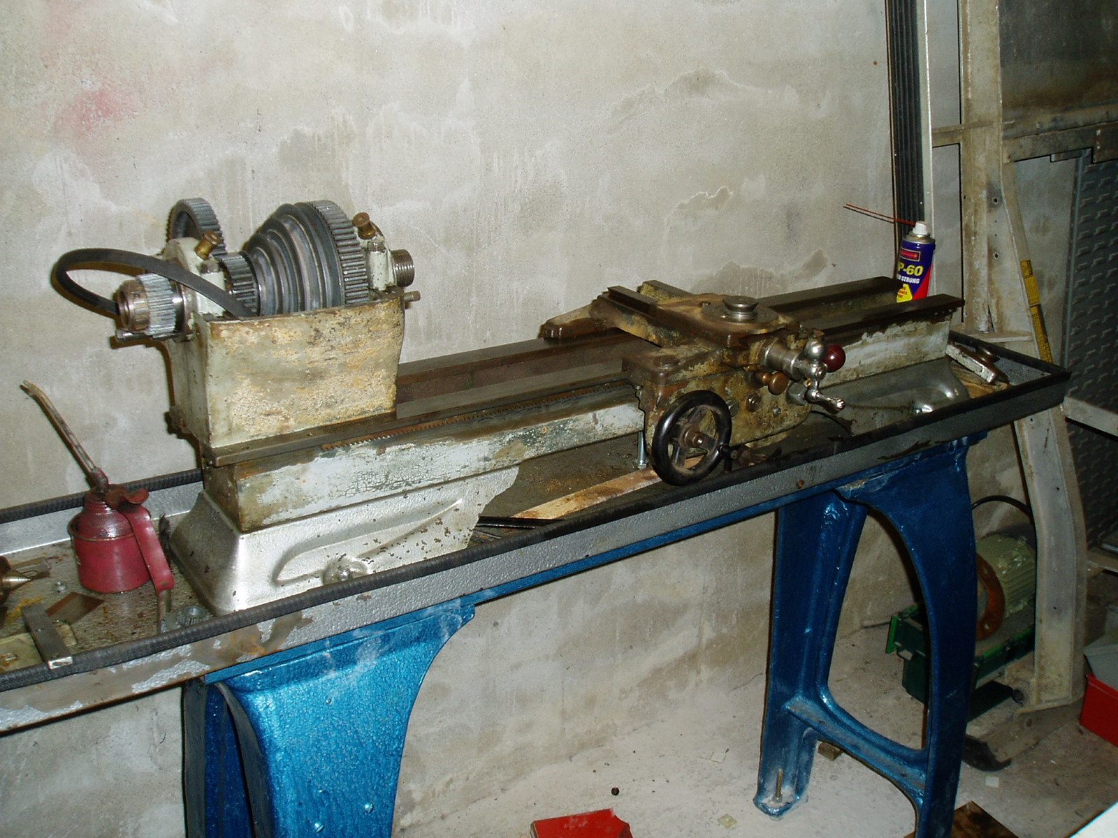

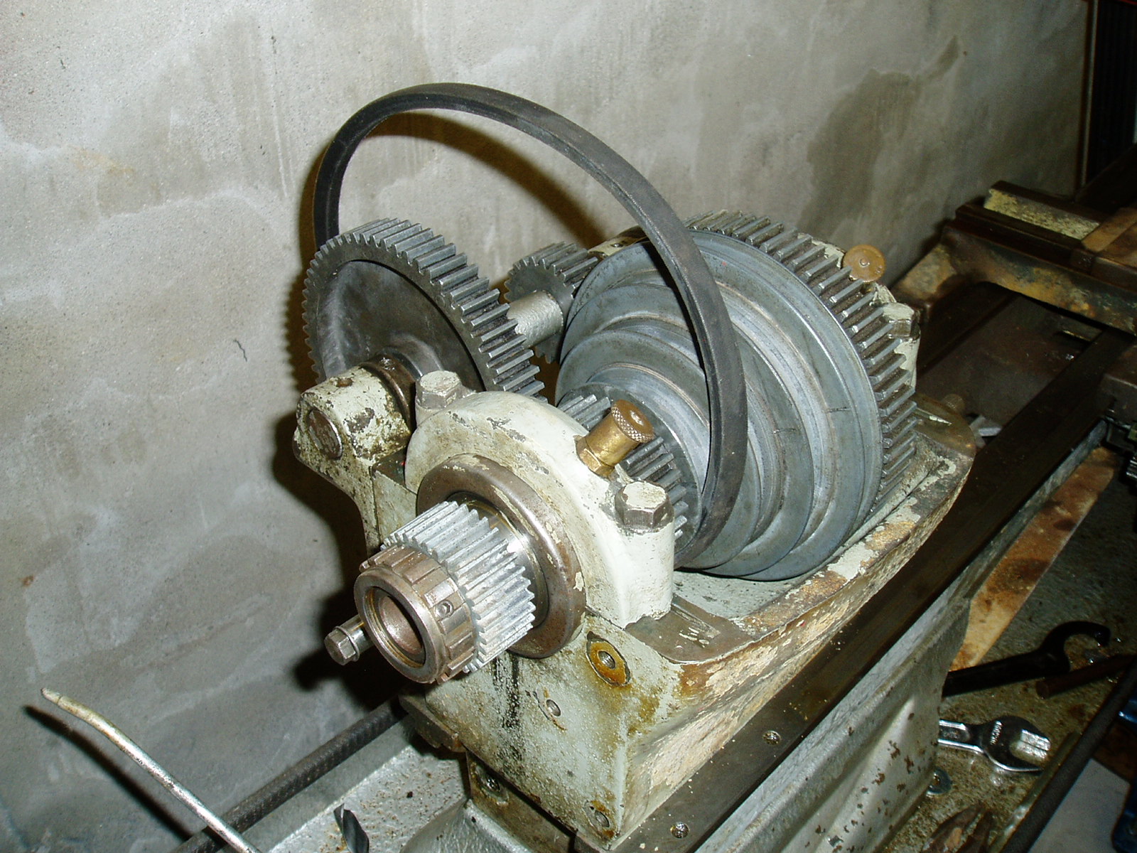

heres some pics of the lathe as it stands, not pretty but hopfully functional
