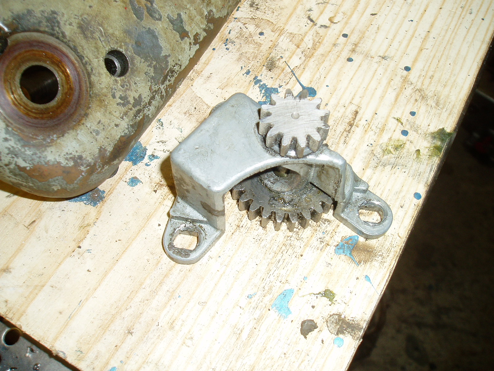

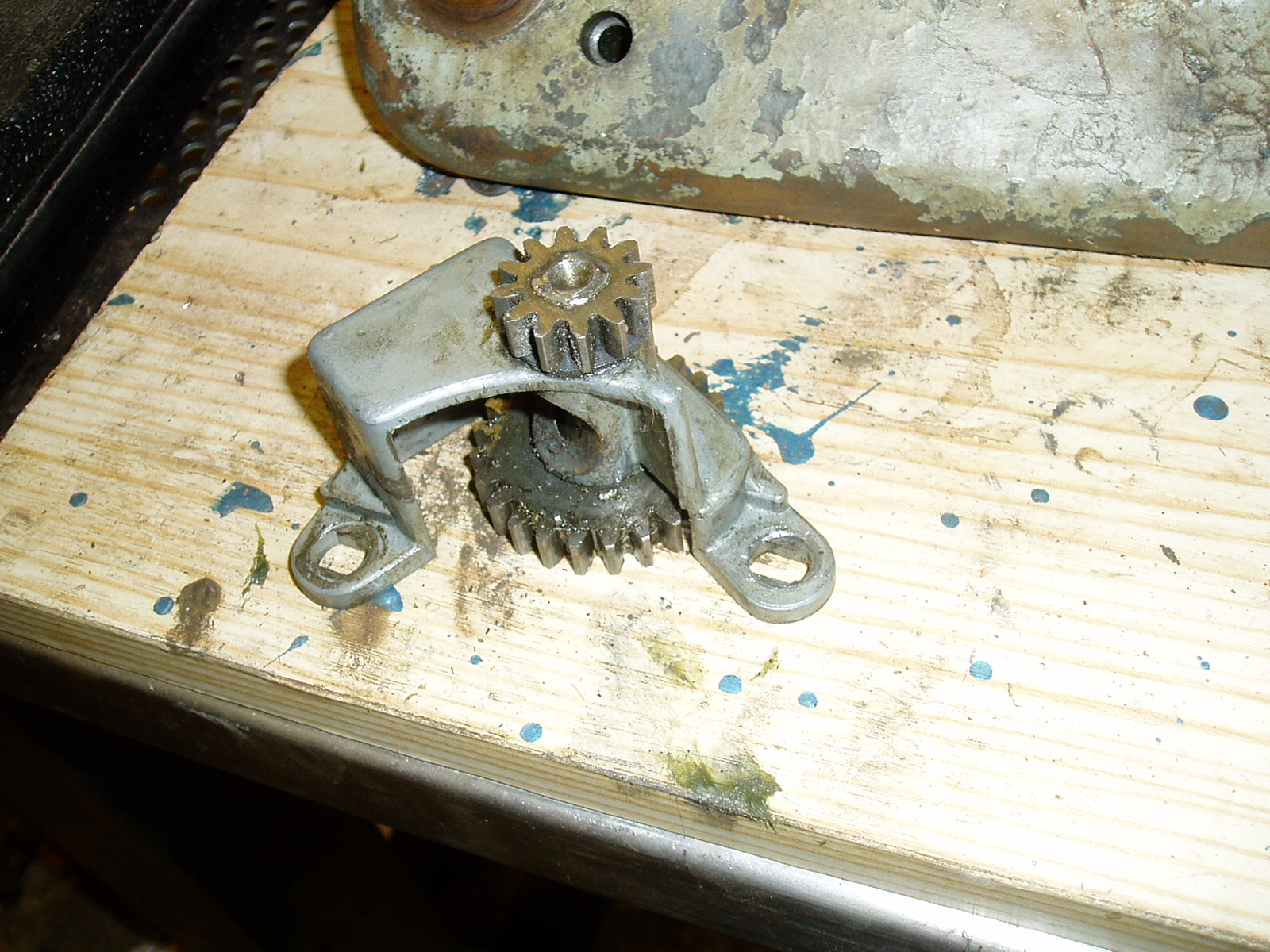

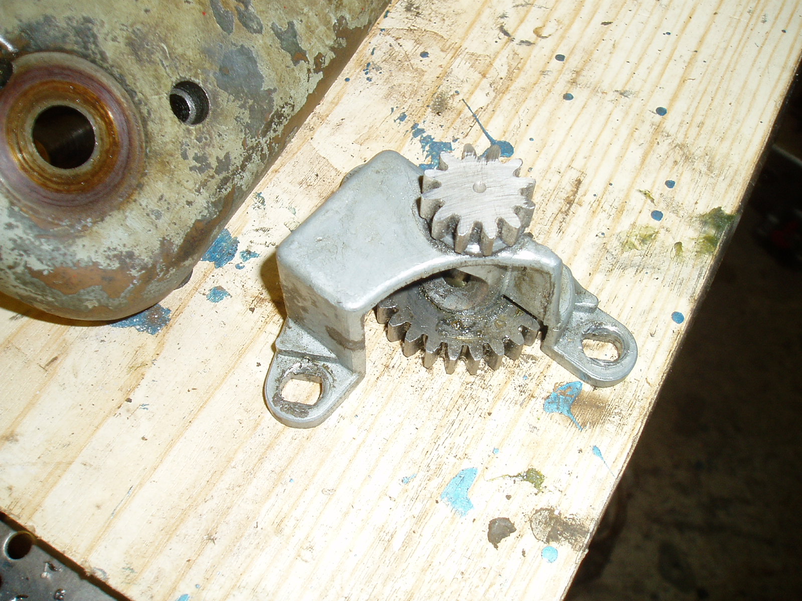

    Grinding the end of the shaft down worked a treat and was far quicker and easier than my suggestions.
    The offending article
    And after a diet.....
    In hind sight it was the obvious solution but having some say "yeah I've done that and it was fine" just gives you the confidence before you potentially turn a working bit into scrap.

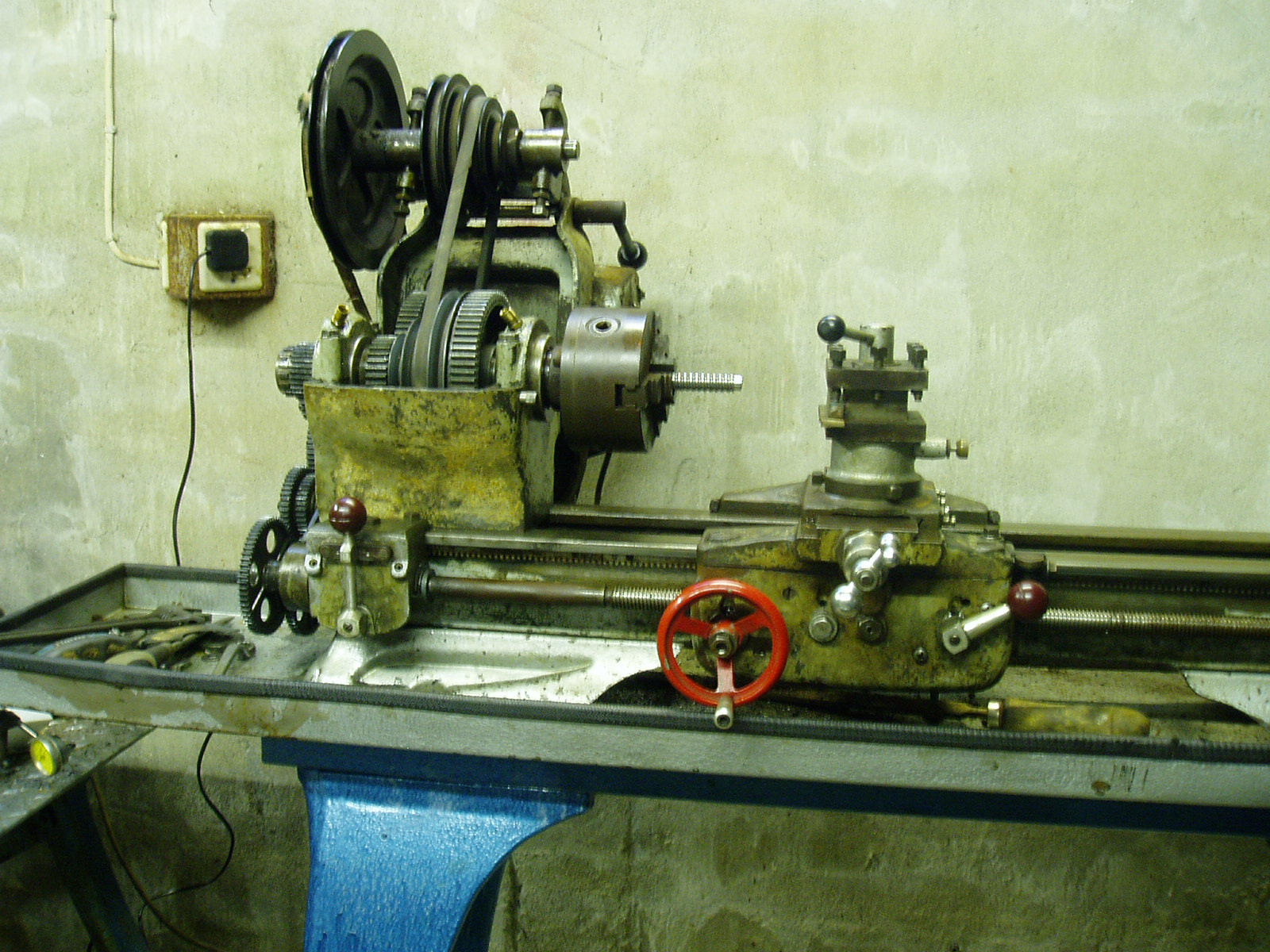

    The rain has arrived....... 3 hours of workshop time and the lathe is running. well sort of. I'm having a mare setting up the belt tension and alignment on the counter shaft. I fitted the metal atlas pulleys and shaft because it also has roller bearings but the end pulley is damaged and out of balance causing a vibration. I put the complete Halifax counter shaft on but now there is a nasty/annoying clanging noise coming for the spindle shaft. It seems to be the small amount of play where the final drive gear locks to the pulley assembly for normal speed. if i reduce the belt tension it helps a bit but i don't think then it would then be tight enough in use
    I have run it for quite a while and kept the oil topped up and the spindle spins freely but there is still a small amount of binding at one point. Is it likely that it is this slowing up that is causing the pulley to bang against the locating pin?
    If you attempt to put the preload on whilst warm, you run the risk of the bearings being too tight when the spindle contract due to cooling, and that might set up a brinelling situation.
    OK wont do that then
    Thanks in advance
  6. #56
    Solved the binding, the idler on the end of the spindle for the lead screw drive was loose
    Finally got the lead screw and reverse gear box working nicely, had to resort to using the Halifax gearbox with the atlas gears, 1st drive shaft and selector nob and plenty of grease.

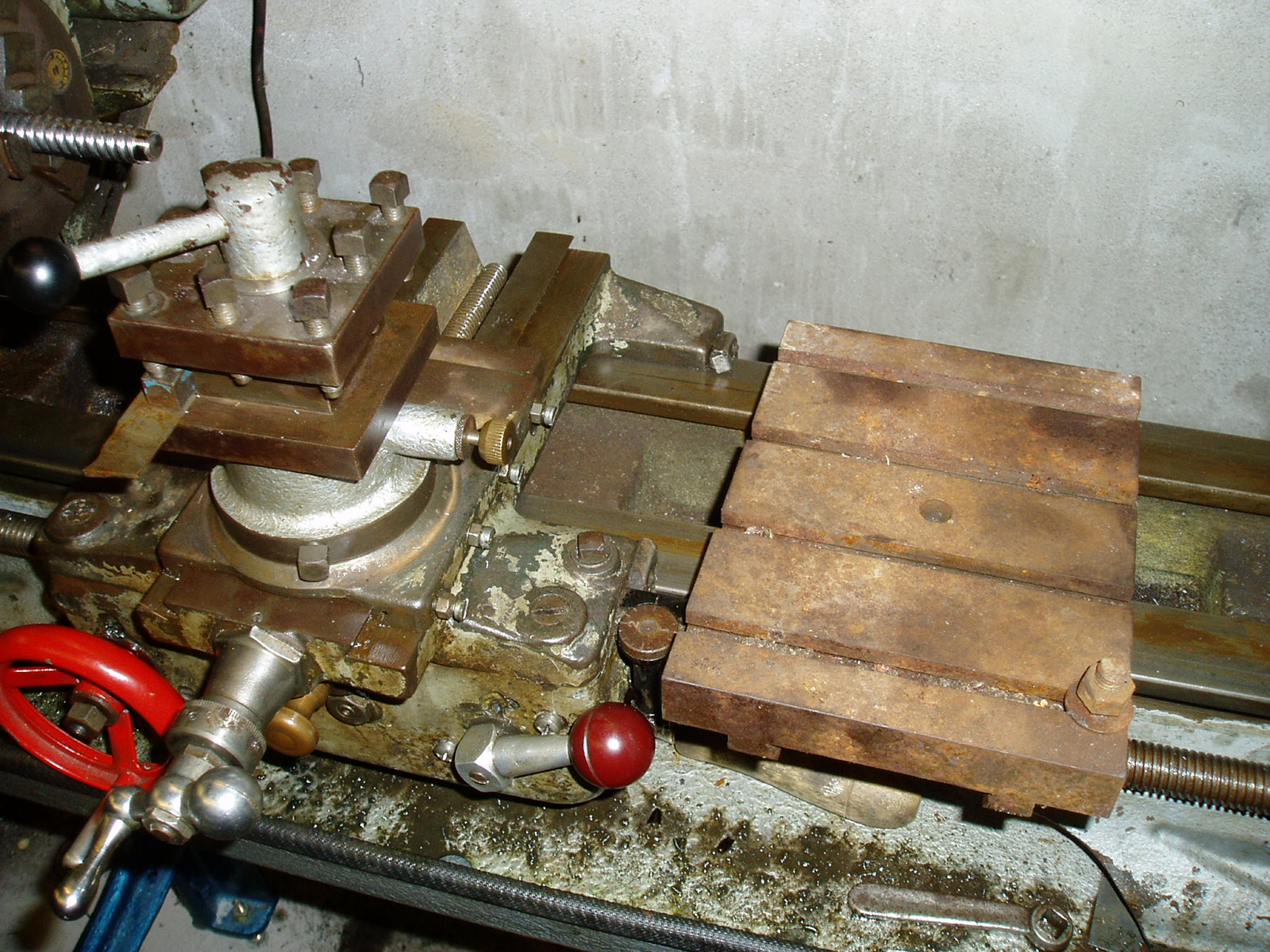

    I tried machining the small pieces of ball screw that Gary gave me but not much luck
    I thought the tool post I had was very sturdy but seeing it move out of the way instead of cutting the screw proves otherwise.
    So I'm going to put the tee slot table on, get a QCT and some new carbide tooling
    The only problem is that I didnt get the gib. So my question is how can I get around this? will a small strip of brass be ok? something in the back of my mind tells me that only precision ground steel will do
  7. #57
    On my Atlas, they started off as ptfe gib strips (which I now think is standard issue), but they can be almost of anything, brass, bronze (recommended) or mild steel, and yes, they will need to be a nice constant thickness along the length. Nothing too exotic, but you do need to angle the narrow edges so that they sit in their position nice and snug, with only about 0.25mm (0.010") adjustment gap.
