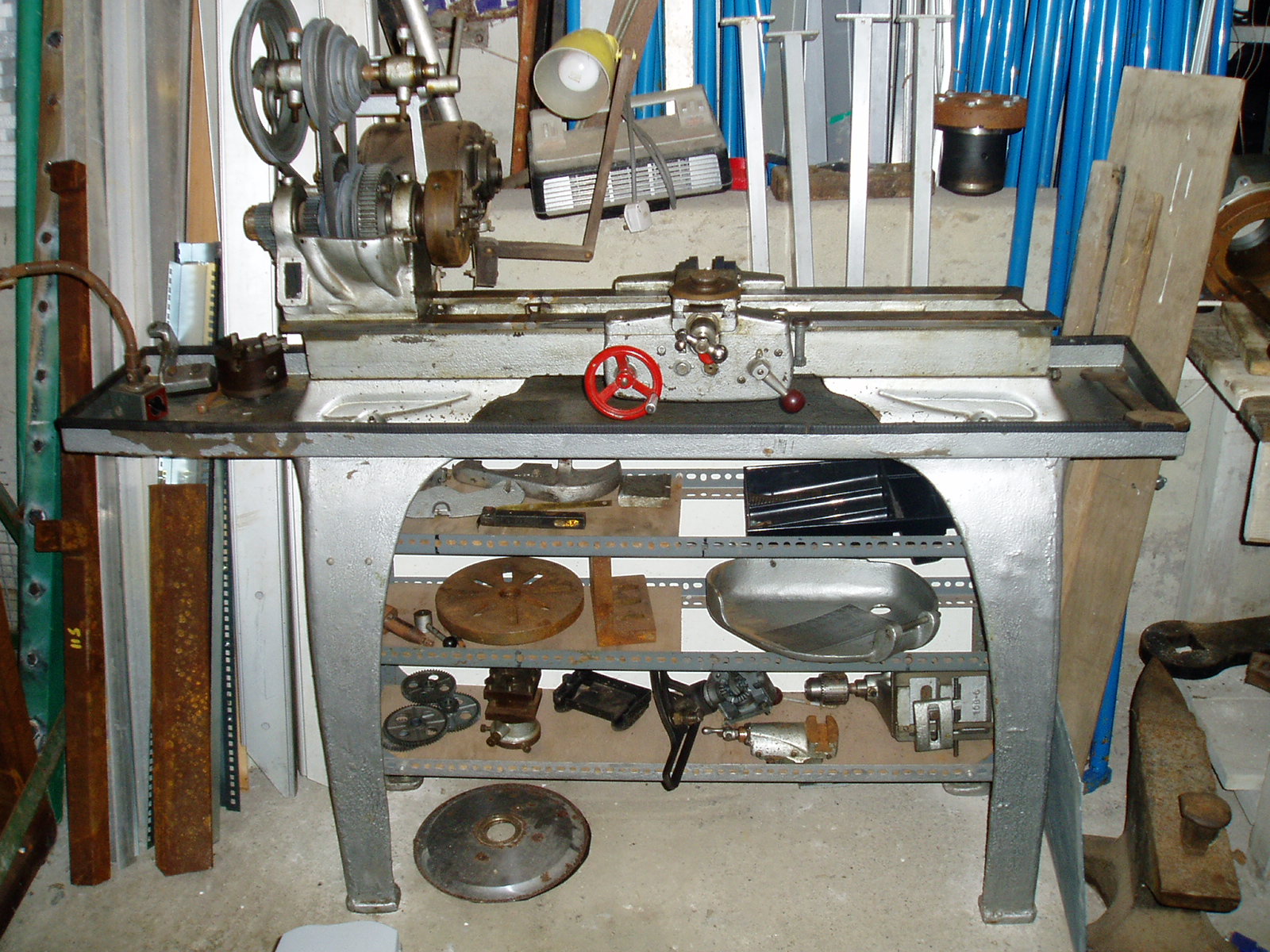

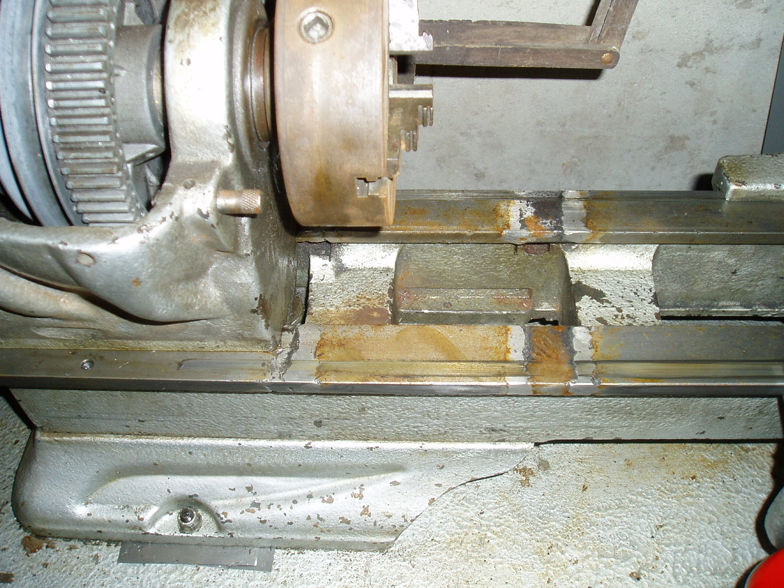

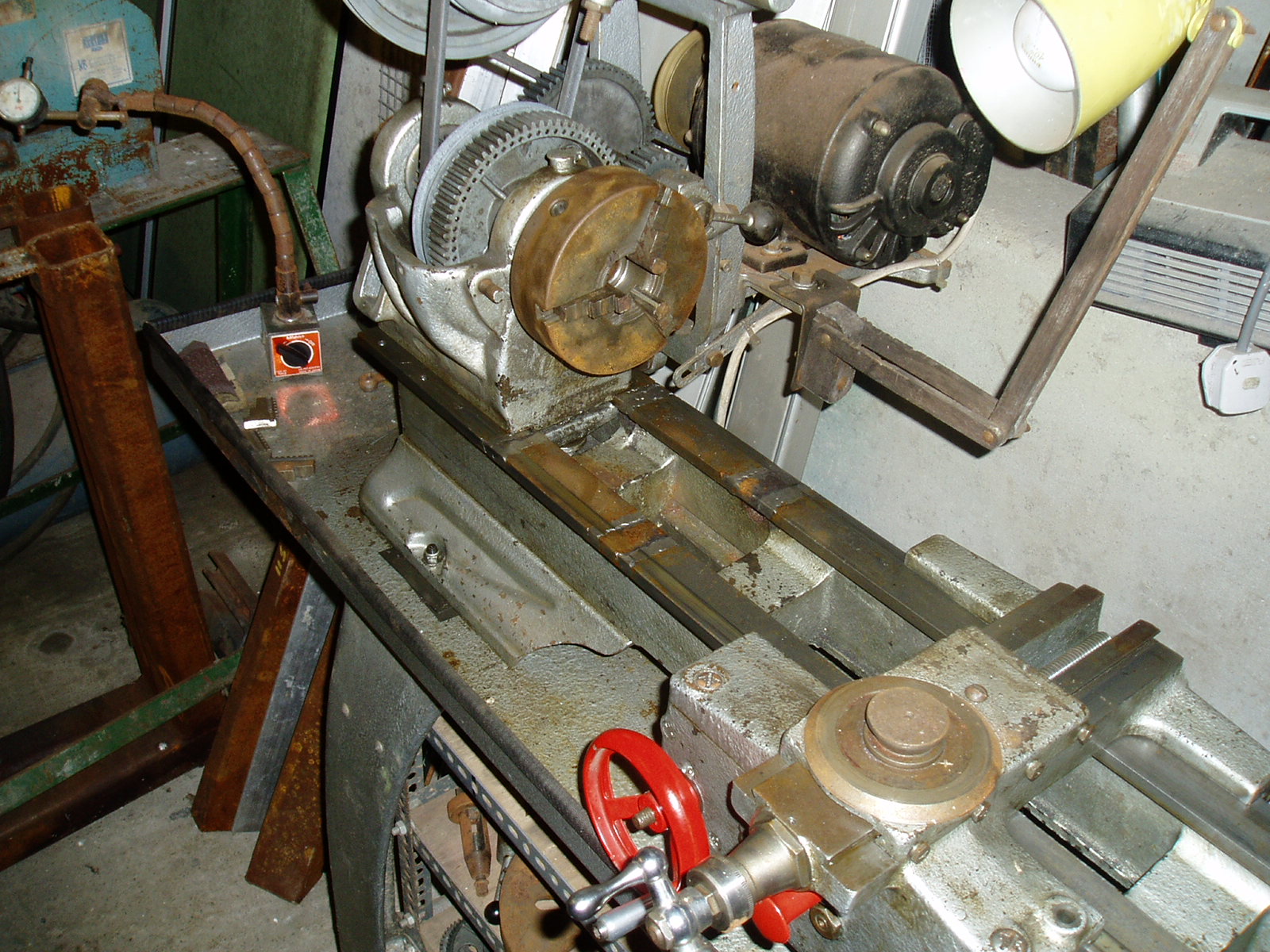

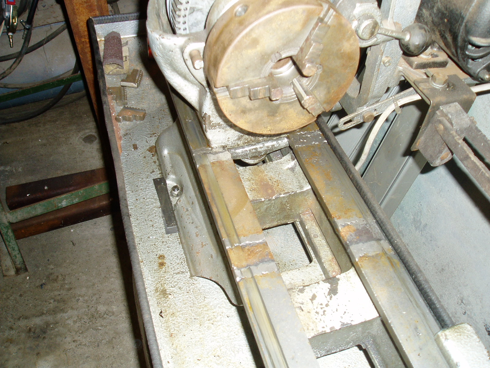

    Here is my rather poorly Atlas 10" thats needs some work.
    I was given it because the previous owner needed to do an emergency repair to some bike brake parts and cut two grooves in the bed to get them in.
    I have also added to the problem (bad advice from welder) and had the bits welded back in, which as you would expect its now a bannana :sad:
    So I believe my options are;
    1 - replace bed
    2 - shorten the bed
    3 - make new bed with linear rails and cnc it
    Open to other ideas...........................

    Seems to me you have the opportunity here to have a proper gap bed lathe? cut it out and allow for a drop in piece when you need that close in work. It would be easier to beef up the side with nuts and bolts rather than trying to weld a bits in. At least you would have a first? maybe
    cheers but theres two problems I can see with that; the first is strength, gap beds have a lot of material around the gap to make up for it and I think just adding to the sides at low level wont help much.
    The other problem is the apron is large and actually goes past the front edge of the headstock for normal turning. so the dropin piece would be permenatly in.
    If i remake the bed then I will definetly make it a gap bed as i can design in the additional strength.
    In hind sight I should have just bolted strengthing plates to the side as you suggested and filled the holes with chemical metal.
