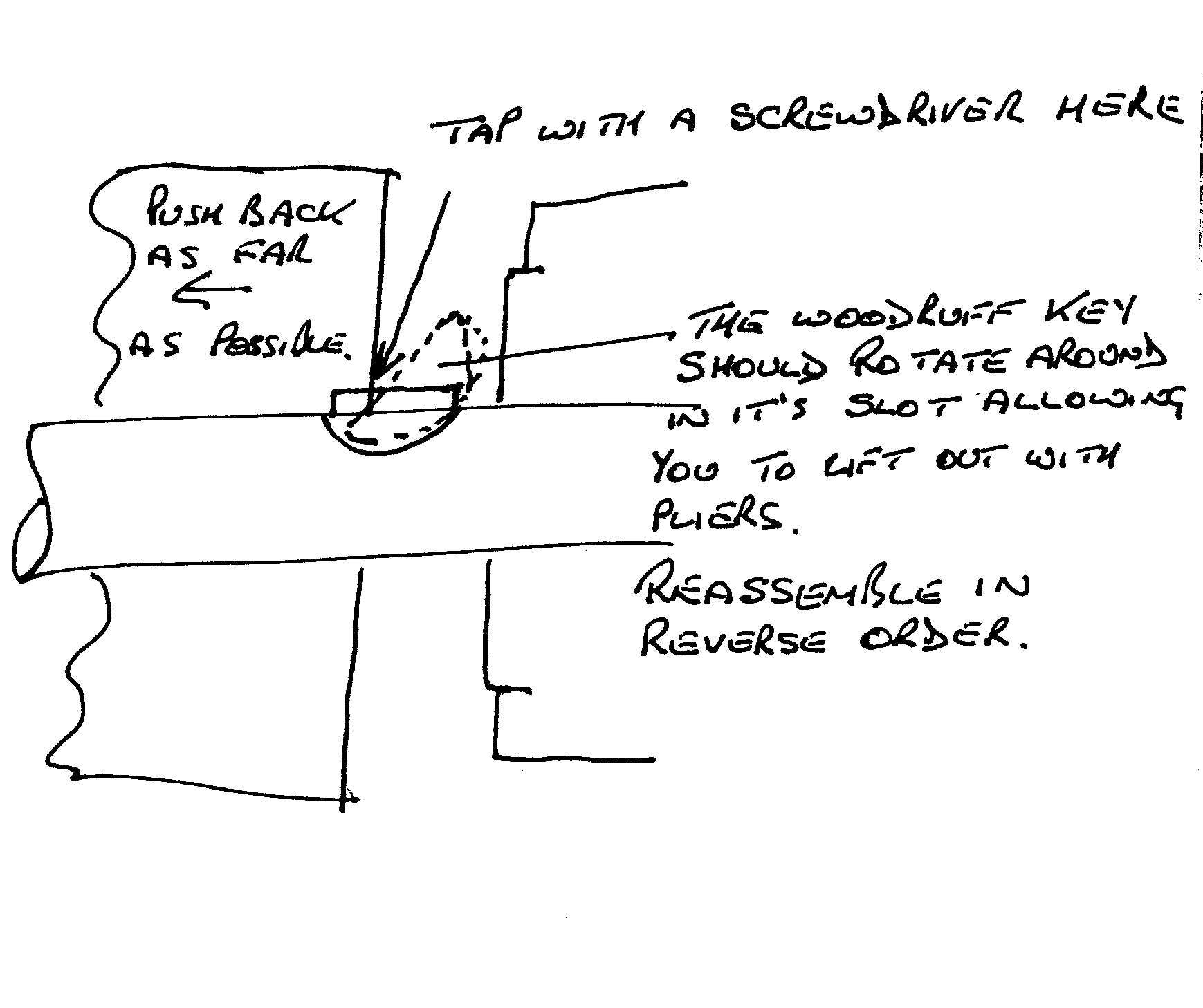

    I've finally got around to looking at this again, welded up a frame, bolted it all down and leveled it up so its now rock solid, but I'm stuck on removing the spindle from the Atlas fixed headstock to rob the metal pulleys. The split caps on the Halifax were a doddle compared to this.
    Ive looked at the 'atlas press' guide online and it makes it sound so easy... I just cant get enough clearance between the main pulley and the bearing housing to remove the woodruff key so the main shaft can slide out.
    And I'm completely lost with disassembling the backgear from the eccentric cam...Anyway I'm sure there is some clever person on here that knows :whistling:

    I'm sorry I haven't been available recently, health and bereavement issues reared their ugly heads.
    I have done the spindle removal many times, and there is a definite knack to it.
    It is very tight indeed, and the first thing you need to to is get the bull gear back towards the change gear end as much as possible, and the spindle as far forwards as it will go.
    Then a slight tap on the top of the key in the position shown on the sketch should rotate the key in it's half round slot. As long as where you hit is further back than the centre position of the key, this should work.

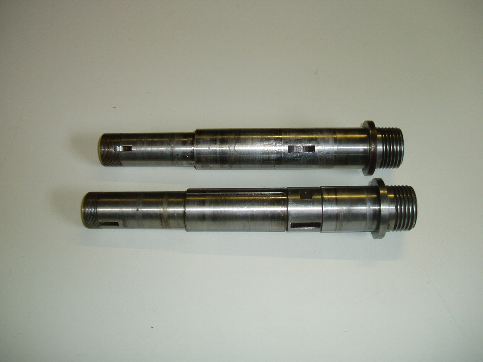

    Unfortunately I couldn't get that to work as I could only see about half of the key. I have no idea how this was assembled in the first place...... I had to resort to the rather drastic solution of filling the key down so it would slide out through the oil seal/collar.
    That turned out to be the easy bit as once the shafts were out it was apparent that they are different. the Atlas spindle (top) has only one step in it whereas the Halifax spindle has 3 steps
    So rather than just putting the metal Atlas pulleys and gears on the Halifax spindle I had to use the Atlas spindle as well, but due to the different oil seals that meant changing the bearings as well (although its probably a good idea to keep the rollers and shells together anyway.)
    The back gear was another pain, I had to use the Halifax mounts, shaft and eccentric cams with just the Atlas gears. I probably didn't need to change it but the Atlas gears are definitely stronger and they also had the spring washers to stop it sloping around.
    I think its fair to say that the Halifax isn't a direct copy of the Atlas and not all parts are interchangeable, even the bolts have a finer thread.
