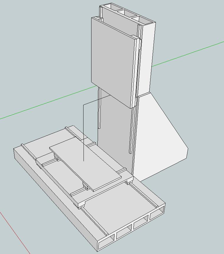

    does anyone now where to get a spindle like this in the uk, (its the first one on the page), or is there anything similar with a MT2 taper,
    i just cant seem to find any un powered spindles anywhere.
    Thanks, Kev

    i have emailed them asking for dimensions of it, it may be a bit small compared to the rest of the machine i am making,
    im going to be making a vertical mill, 600mm x axis, 220mm y axis, around 500mm z axis.
    basically the z axis plate is 450 x 500 high and i am going to use a 3 phase 1.5 to 2kw motor belt driving the spindle

    Sorry i have not been on hear much recently, been working on the mill, il get some pics up when the stuff arrives, i dont think the sherline spindles are big enough for what i want, basically im using a minium of a 2kw motor possibly up to 4kw depends what is available.
    i think making a spindle is the way forward because i just cannot find anything on the internet, id be interested in seeing some drawaings :) thanks. this mill is going to be quite big and very heavy so need a fairly big spindle, most important question is what is the best tooling type? ER 16? i want to be able to have all the cutting tools in their own holders and be able to just quickly change the holders in and out of the spindle. how about an air powered tool holder?

    haha, hmm well i have got an unused 3 phase 15kw inverter so i need a motor that will run with it, so what i will do is gear up the spindle, a 2 pole 3 phase motor is around 3000rpm, so probably gear it so the spindle runs at 12000rpm? at 50 hz, the inverter can go as low as 1hz so 240rpm at the spindle and as high as 170hz not that im going to run it anywhere near that!, so need a semi powerful motor to be able to get the low down torque.
    i definitely want to be able to mill aluminium and im thinking it should be able to mill steel.
