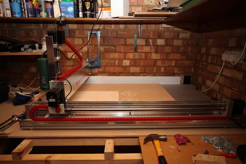

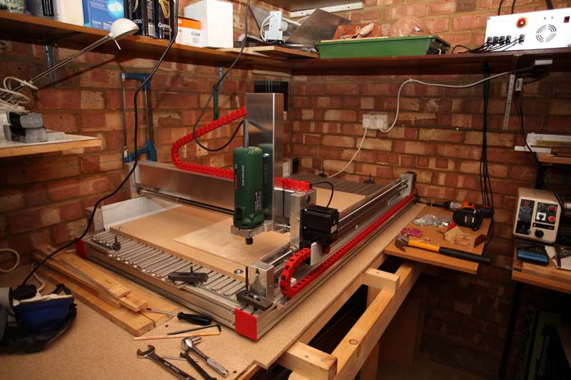

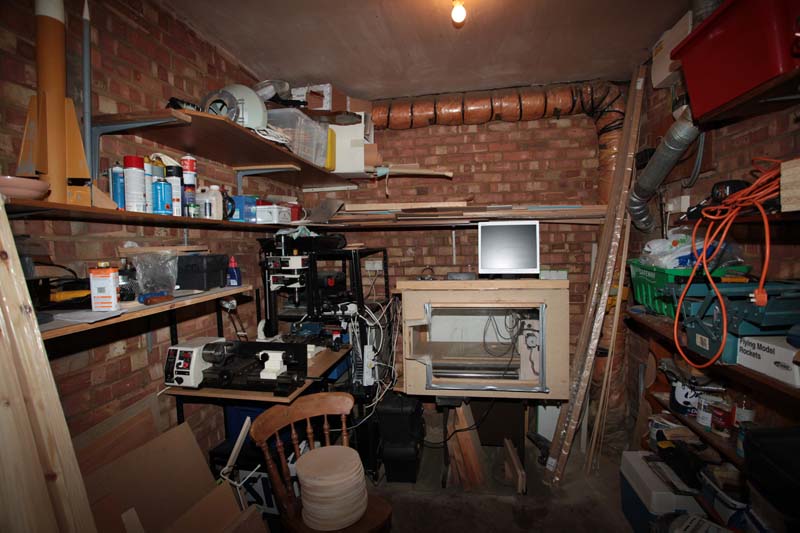

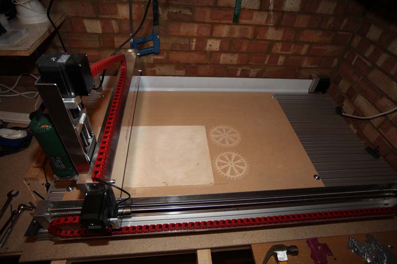

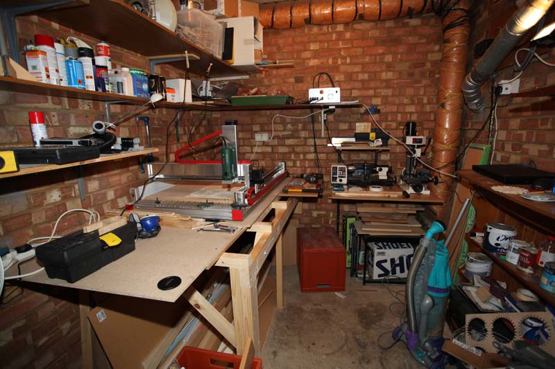

  5. Well, I've tried to attach some photos - no idea if it will work. There is one there of the garage before with the old machine - just for some comparison.
ID:	2099   Click image for larger version.
ID:	2100   Click image for larger version.
ID:	2101   Click image for larger version.
ID:	2102   Click image for larger version.

  8. The photos were taken with a fairly wide angle (17-40mm) lens which tends to do weird things to (apparent) scale on the wide side - although the machine is fairly compact. The piece of MDF you can see on the bed is 915mmx620mm, cutting area is as the spec - 1000mmx580mm. I took a hefty plunge into a bit of oak at the weekend after I made an mistake between vcarve and the controller software. The router stalled and the machine motors stalled before I hit the kill switch. Everything seems fine though, which, given that these things happen is ... good. I'm dreading the day I plunge into the Alu T slot planks.
