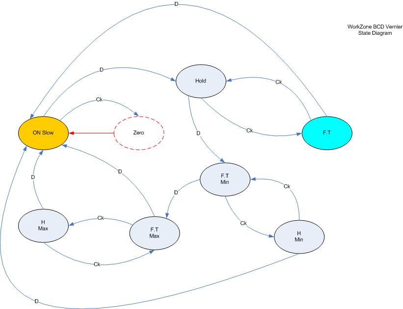

OK I have done a test on the BCD vernier which is a Workzone 6" bought from Lidl or Aldi, can't remember which. I have attached an image of the state diagram
It starts always at power up in Slow Read mode. To get from switch on to Fast Read (F.T) needs a Data then a Clock Pulse. To Zero at power up on route to F.T then its Clock then Data then Clock. When in F.T. to Zero needs a Data then CLock then Data then Clock. There are other states as shown in the diagram that are of no interest to our use I suggest.

Just to get the record straight, I found by inspection that I had reversed clock and data from the vernier to the PIC processor inputs. A BASIC SCHOOLBOY error. On correction of the error Bill's HARDWARE & SOFTWARE works perfectly with dead stable values on the PC display and also fast update rate. Its a neat and dead cheap solution if you have a PC to hand with a serial COM port.
I'm now going to sort out 2 more verniers that respond to clock and data mode pulsing so I can get X Y & Z working simultaneously. I'll then make a proper PCB for the interface rather than a veroboard prototype to make it a bit more robust. The next step will be to get it all installed on the mill with the full length PCB beams for each axis.
A big thank you to Bill Todd, he is a genius and a gentleman in equal proportions.
