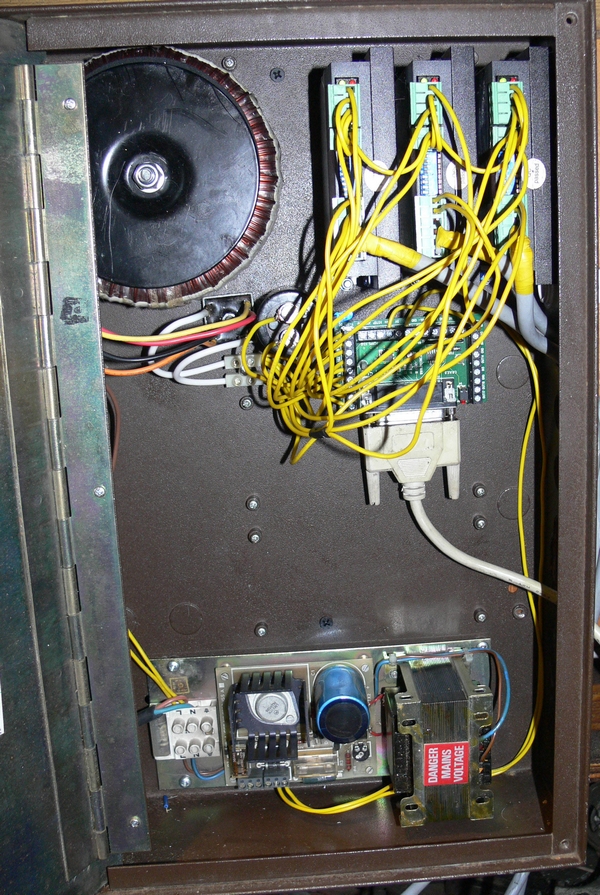

    I'm using the same Breakout board and steppers in my CNC. Instead of PM542 drivers I have PM752, hence higher supply voltage.
    With my setup I'm able to mill steel, and I would try the same with your set. Eventually in case of loosing steps or motor stalling I would decreased Feed rate.
    But If you want to buy pieces separately I would recommend PM752 - http://www.slidesandballscrews.com/p...ml?cPath=44_97
    and some handsome 500W toroidal transformer (eg from Farnell- free delivery on orders above £20+VAT) + 25A rectifier bridge + big capacitor (voltage not smaller than DC after rectification).
    for reference:

    I agree with getting PM752. I have also got them and the extra voltage will help with your motors torque/rpm.
    I'm only using an 8A bridge rectifier, with 4 motors it's fine. Just get whatever's cheapest ...
    The following capacitor from farnell is good value:
    http://uk.farnell.com/epcos/b41231a9...0uf/dp/1839296
    (put two in parallel)
