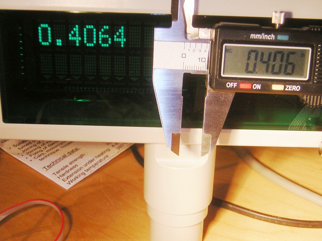

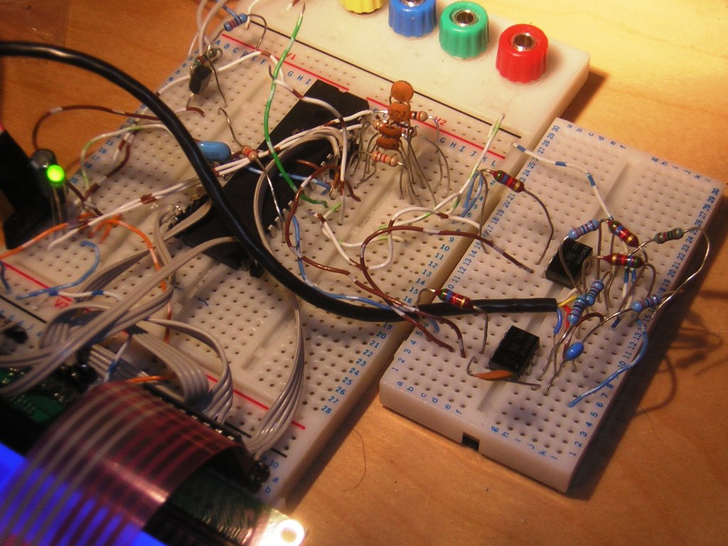

  2. All the figuring out has been done...
    See here and here and here
    and here is my own breadboard with a ex-POS terminal VFD for the display...

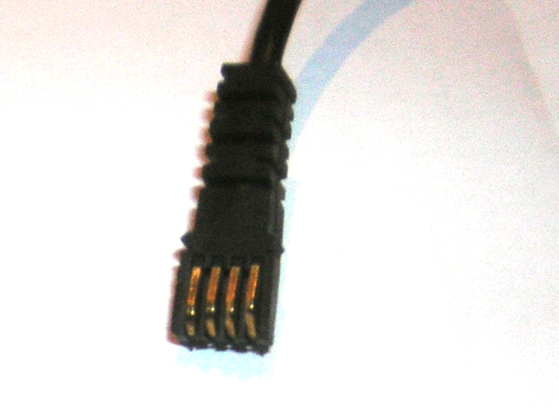

    oh and BTW, you can't get the leads on their own any more.... or at least no one seems to be able to. I was working on making a connector - here is one I managed to get..

    I'm surprised no one is knocking out cheap displays and cables for these caliper scales? What has happened to your prototype? Has it stayed in that breadboard form or have you advanced its build state? I would be interested to know what processor/controller you used for the decode/display driver.
    I'm not too fussed about a connector to the gold contacts if they are not readily available as I would have just soldered wires onto the board. its not worth messing around for a £9 scale is it.
    Have you managed to successfully transfer the scale head of these things onto a longer bar for machine mounting? I'm not clear how accurate one needs to emulate the original caliper slide bar as far as materials and texture need to be. Your comments on this mechanical aspect would be appreciated.

  5. I'm still waiting to find time to make a proper PCB. Software is pretty much done. Its a PIC16F477 if my memory serves. The PCB is a generic board I am making that has a RS232 port (for the VFD display) a keyboard (4x4 matrix) port and a LCD display port (for HD4470 style 4bit LCD displays) and a general IO port.
    The way I am implementing my scales is a small PCB containing the level-shift comparators, a small PIC and a -1.5v charge pump that is attached to the reading head. It will communicate the reading over a 2-wire i2c link back to the display processor - the link will also be the +5v power to the PCB. Eventually I will build the read-head into a purpose-milled plastic case and remove the display.

    That sounds like a good approach and one I would take re the balanced tranceiver at the read head. Is your small pic down there doing the timing and stripping the word off for transmission. I take it your I2c is bi directional for reset and imperial/metric mode selection as down-link commands?
    The PIC will do all the decoding and sampling and filtering and will upload a value on request from the display processor. It is fronted by a dual comparator to do the level shift and generates a PWM output to drive the -1.5v charge pump. The output will be in native format (note that the reader always outputs in imperial, metric conversion is done by the display processor)

  10. update - it seems LittleMachineShop in the US have a source for the cables again... pricey tho... MEDW advertise them in the UK for £11 +P&P
